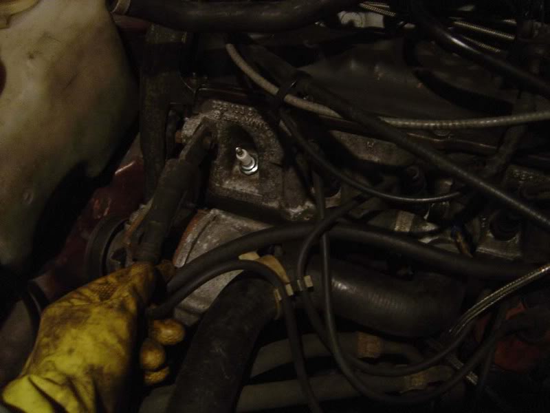

Step 3 - Fit the socket onto the plug you revealed in step #1 and remove the plug (turn anti clockwise to loosen)

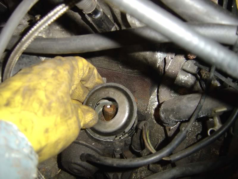

Step 4 - Remove the plug completely from the cylinder head and clean up any signs of oil or dirt so it doesn't enter the combustion chamber through the plug's hole

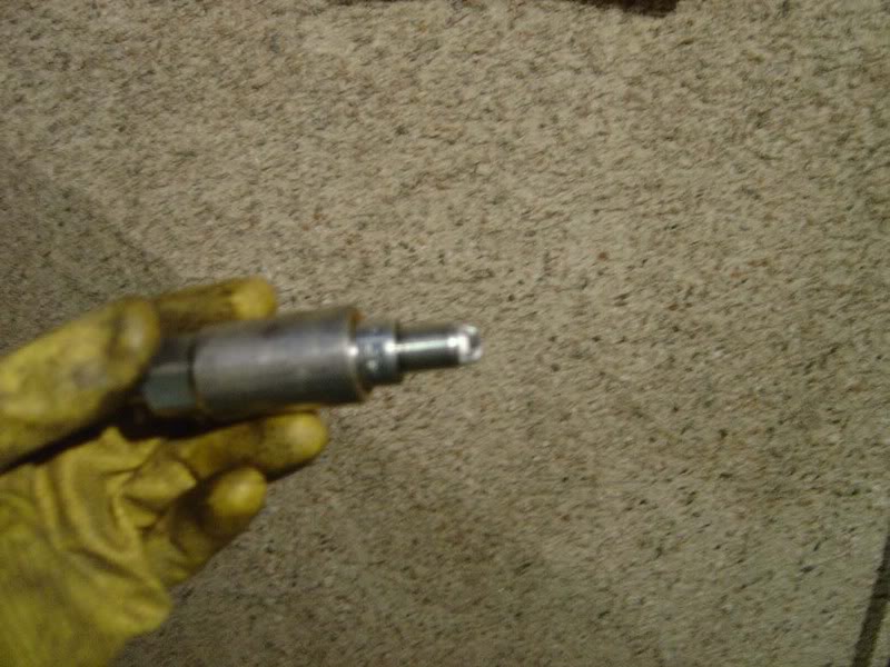

Step 5 - Check the tip of the spark plug (this is blurred but doesn't matter because they were new plugs so wouldn't tell you much). Note that there are two 'prongs' at the bottom of the plug, these are called electrodes. The spark travels between the centre of the base of the spark plug and these electrodes. Because there are 2, we call the plugs 'twin electrode' spark plugs and it is important you get these

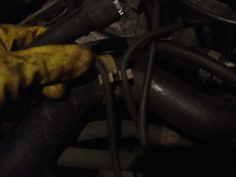

Step 7 - Trace it back through any restraints such as this clip on the top rad hose, detach it so the wire is free

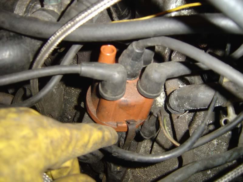

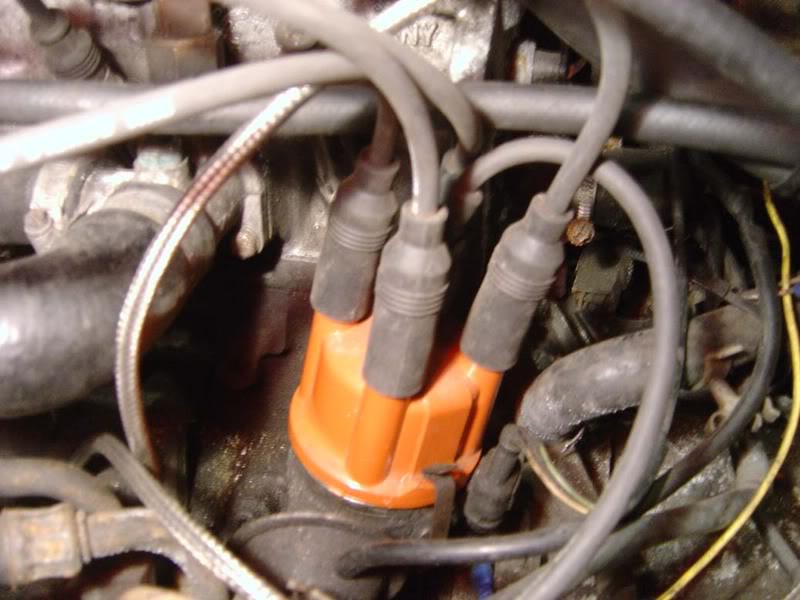

Step 8 - Follow the lead right back to the distributor cap (the orange plastic thing in the picture)
2637 views (92 Kb)
Step 9 - Just like detaching from the spark plug, the HT (which stands for high tension) lead simply pulls off the distributor cap (also called a dizzy cap) as shown

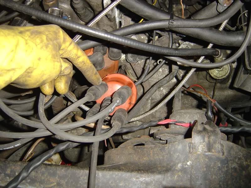

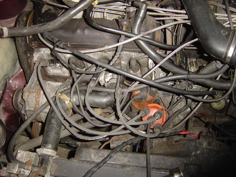

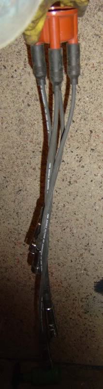

Step 10 - Note that all the leads are different lengths as shown in this picture. The longest lead is from the dizzy to the left hand side of the engine (cylinder #1) and the shortest to cylinder #4

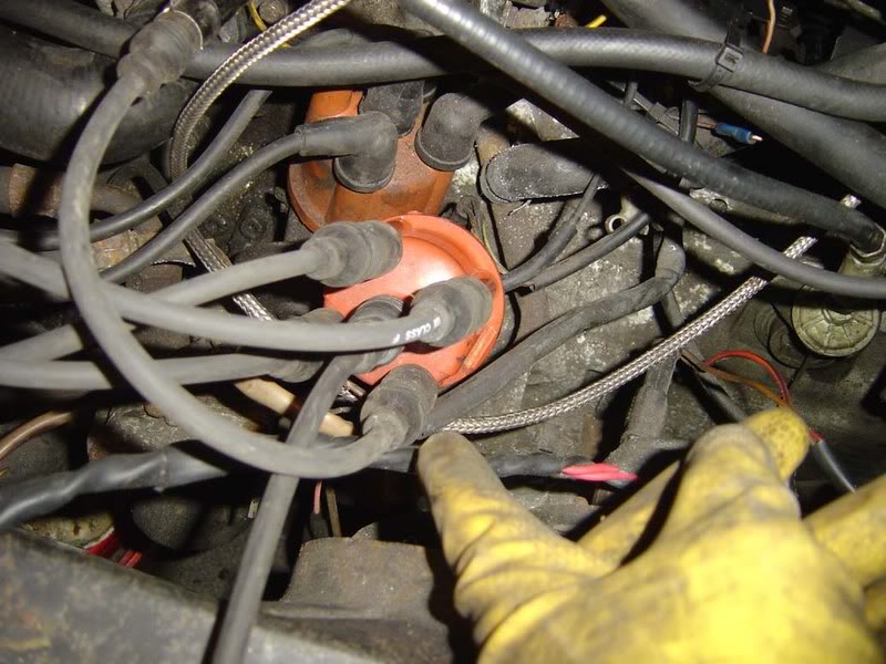

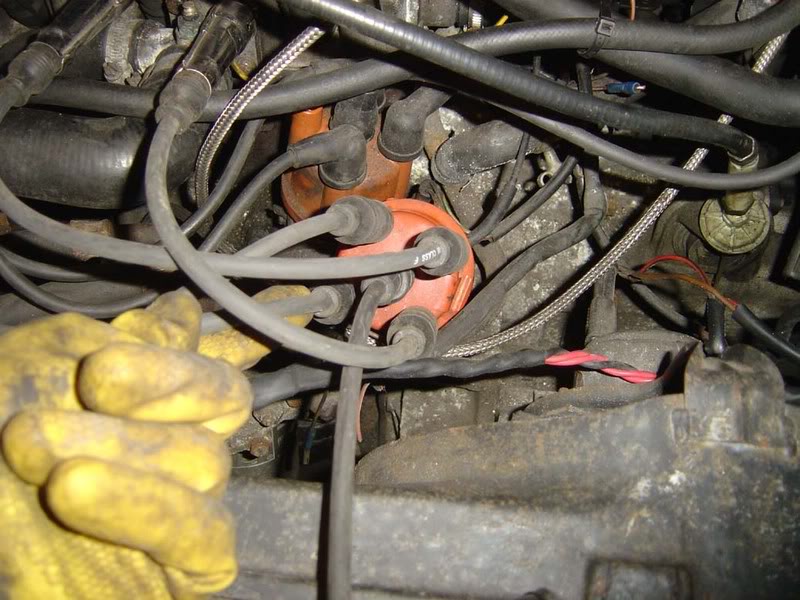

Step 11 - Now fit your new HT lead onto the dizzy, through any clamps and back to the spark plug. For me, I was replacing the dizzy cap too so simply lined all the leads up as shown on the new cap before switching them one at a time to avoid any potential misfires by switching lead positions
2332 views (126 Kb)

You should see from this that as the rotor arm spins around in the dizzy cap, it will fire #1 then #3 then #4 then #2, this is the firing order 1-3-4-2

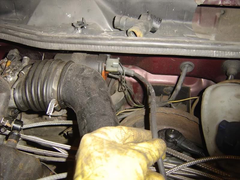

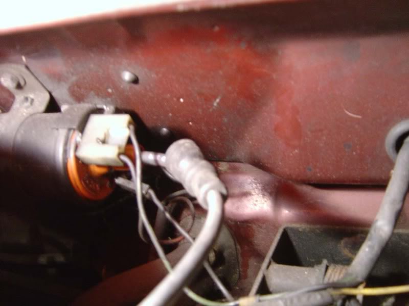

Step 13 - The final lead we haven't mentioned is the one that goes from the middle of the dizzy cap to the coil. This is important because the coil fires out high voltage down this central wire which will then feed to each of the 4 surrounding wires you have already fitted. Follow the wire from the dizzy right back under the bulkhead to the coil and remove it (pulls off as usual) then fit the new one

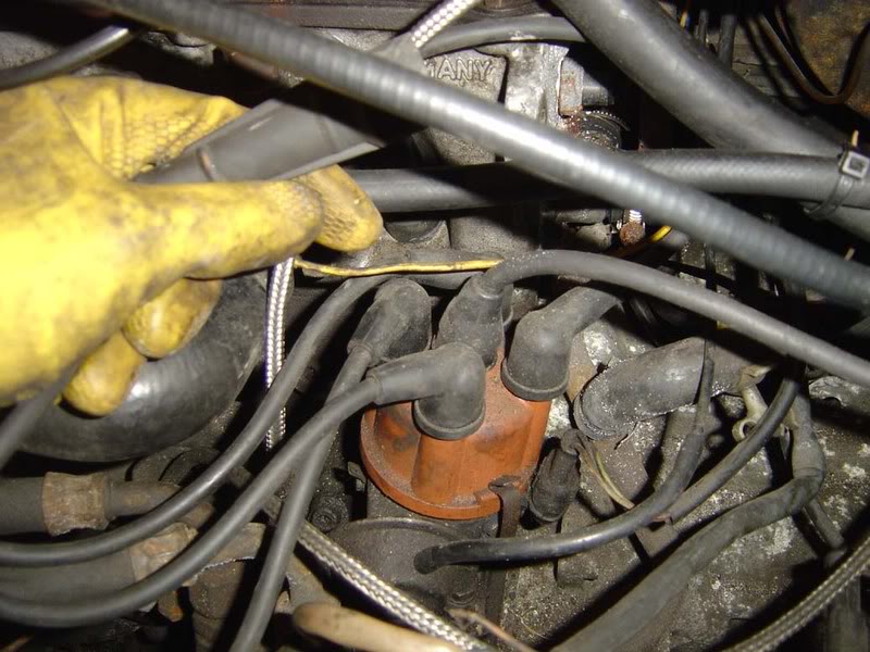

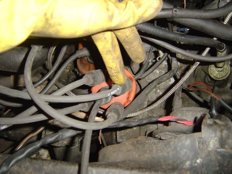

Step 14 - Moving back to the dizzy cap itself, there are two metal clips that hold it in place (front one shown in the picture), unclip these by hand or carefully with a flat blade screwdriver if they are really tight
IMPORTANT: Note the position of the dizzy cap before you remove it, you don't need to be too precise at the moment but ensure you know where #1 lead sits and you'll refit it the right way round (otherwise you could inadvertently spin it through 180 degrees)

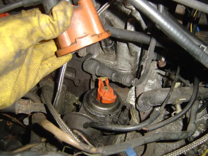

Step 15 - With the clips removed, the cap will be free to come off and reveal the rotor arm

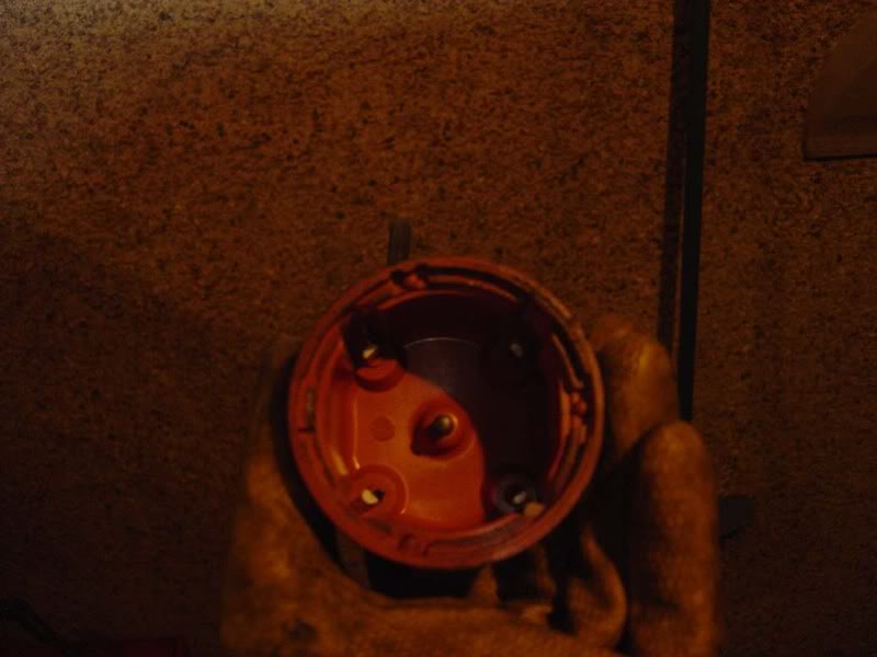

Step 16 - As mentioned earlier, the coil fires a large voltage through the main HT lead which is then passed down the dizzy cap to the centre of the rotor arm (this is the orange piece you uncovered in step 15). The arm itself spins around (driven by the engine via a meshed gear) and the metal contact at the end of the arm comes close enough to the terminals in the dizzy cap to fire a spark to the HT leads one by one. This happens very quickly so that the rotor arm spins and fires all 4 leads in a revolution
The picture here shows the underside of the dizzy cap where the main lead's terminal ends in a sprung connection which sits directly on top of the centre of the rotor arm. There are 4 more fixed terminals around the outside of the cap that will link the rotor arm's output to the HT leads

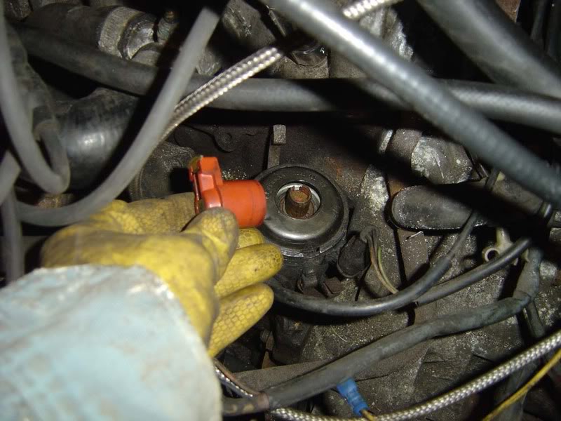

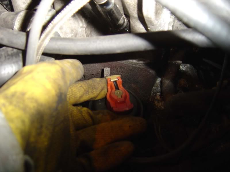

Step 17 - Slide a finger either side of the underneath of the rotor arm and pull it up as shown
IMPORTANT: Just like the dizzy cap itself, note the direction the rotor arm points when removing it. The arm is keyed so you can't get it wrong but double check it is correct before you try and refit the arm

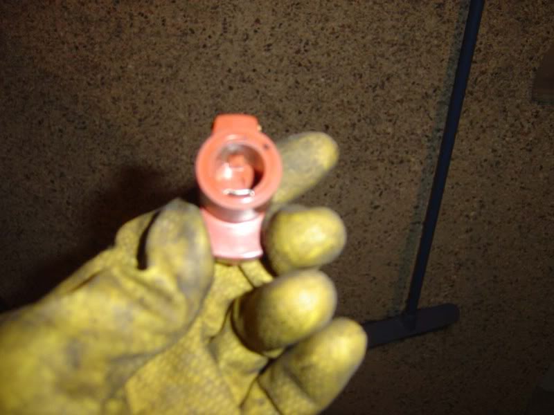

Step 18 - If there is any carbon build up on the tip of the rotor arm then replace it (you could clean it but for a few quid don't bother). Check the inside too (see pic) for signs of wear/damage

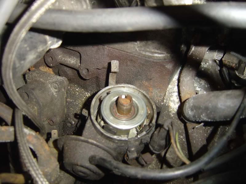

Step 19 - Next, remove the dust cover from the dizzy
2121 views (65 Kb)
Step 20 - If you are faced with this then you have the transistorised ignition so there are no points to contend with. If you have points then you need to regularly check the gap and replace them (see a Haynes manual for that seeing as I didn't have any!)
