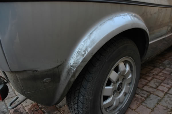

So I started today with a little weight loss. The bad news is that the rear arch covers/extensions are now scrap as I snapped one of the mounting tabs on the first one by accident, and again on the second one because I am an impatient idiot.
The good news is that the arches themselves are super duper solid, despite the fact that half a ton of soil/dirt/gunk was living up there…

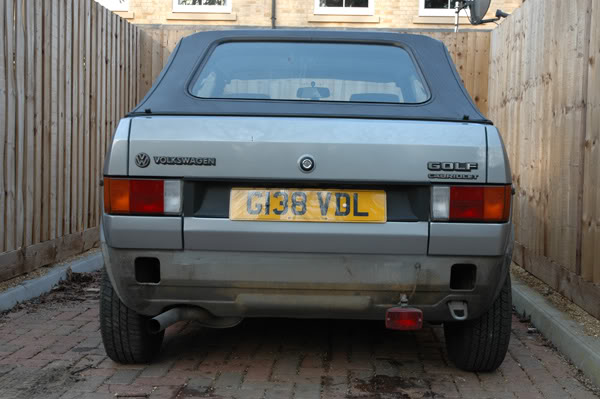

For your info, if you dont already know your cab VDL originally started life on the Isle of Wight. So cant have been driven very fast at the start of its like, as theres no motorways here and just one strech of dual about 1/2 mile long !
errr... not to sure about it not being abused on IoW. I have some relations down there and they say the DL on the number plates is so that tourists can spot the "dam loony" yokel drivers and give them a wide berth....... :D
Yeah I did actually, pretty interesting I think! The car's been around, I bought it from a guy in Carlisle, and I think it had been registered in Birmingham and Manchester before that!
I think it has been pretty well looked after until I got it and put 11k miles on in 9 months! Poor old girl  :oops:
I'm still amazed at how good this was under the arches!!!
I know! Can't wait to get under the fronts now too  8)

Looks good under the kit matty, can't believe it, if only my arches were as good! lol!

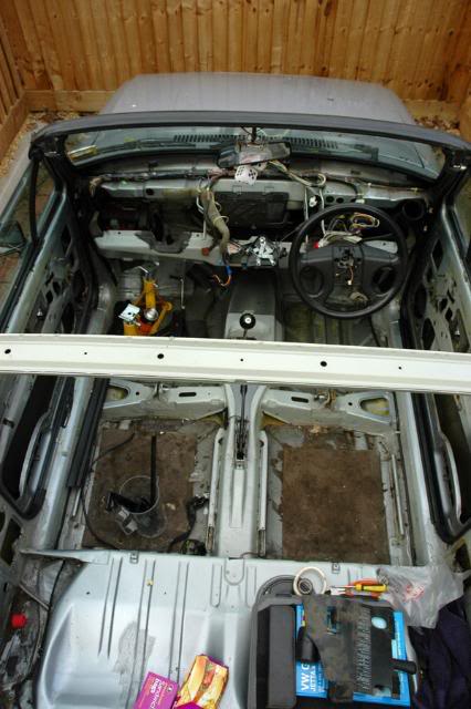

Have been continuing with trying to remove what's left of the clipper kit, thanks to rusty screws and my impatience very little is coming off in one piece - my NS skirt is now melted in places.

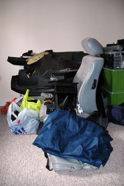

I decided that because of the fact that it's been raining off and on all weekend I'd just crack on with the interior instead, so this is how it looks after a couple of hours before my girlfriend talked me into going for lunch. I had lamb, it was nice.
The front doorcards have a bit of water damage around the speakers, so they'll be replaced before I re-trim. Rears are perfect, however! I do have two layers of sound deadening in the footwells though  :banghead:
Haven't got anything near as much done as I wanted to this weekend which irritates me a bit, but hopefully I'll be able to get a bit more done tomorrow.

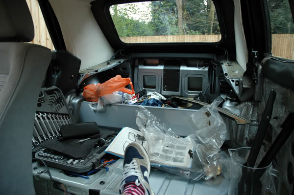

Got a bit more done, progress is feeling a bit slow though I've been as methodical as I can unless something gets in the way. You may notice the boxes of freezer bags in the car  :mrgreen:
Anyway, quick pic. Need to get a tarp or something so that I can make the car watertight so the glass, hood, seals etc can all come out.
Doesn't look like much when it's in the car!
