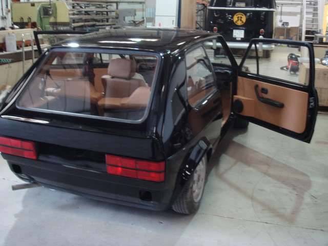

very nice indeed, got any more detailed pics/info on the corrado rear bench?
I've got one to go in mine but haven't decided how to go about it yet….
i didnt get chance to take any pics im afraid
there is quite a bit of work envolved, the frame work needs to be cut on the back of the seat to get the right angle and so the brackets sit down flush to the car…
on the bottom, alot of foam needs to be shaved off, to get the seat to sit flat and flat metal trays had to be made for it to bolt to the car…
then you need to make infills to cover the gap between the seat and side cards as the corrado bench is narrower than the mk1 bench…this was made out of foam with wooden bases …
the best thing to do is, place the corrado bench in the rear of your car and see what needs doing.

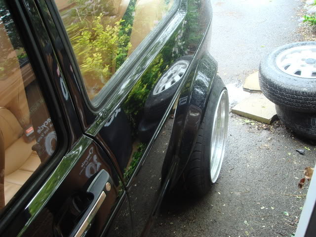

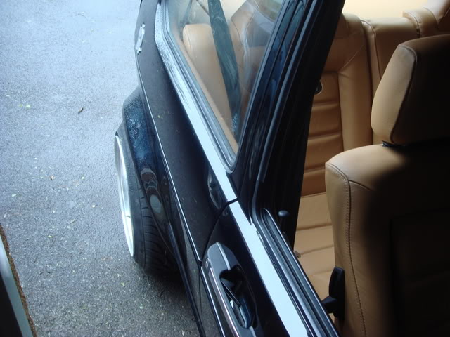

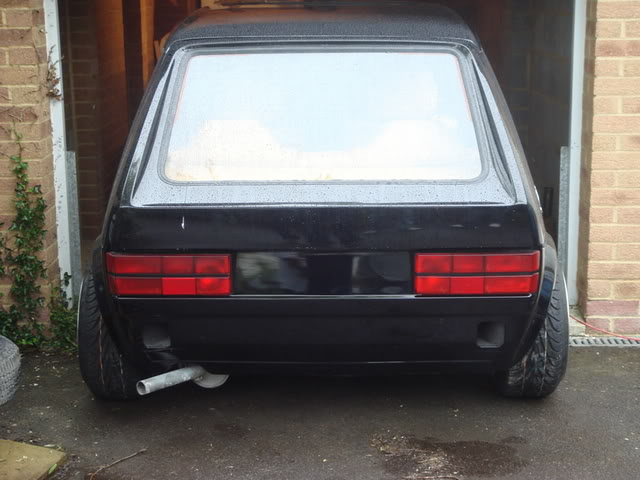

fitted my rear bbs today and started fitting the intercooler
the tyres should sit a bit more under the arches when i get my camber shims which will give it 1.5 of negative camber..
few pics..
think she mite rub a bit mate...haha.....if u have ppl in the bk....but hay its a mk1 u dont need passengers...
