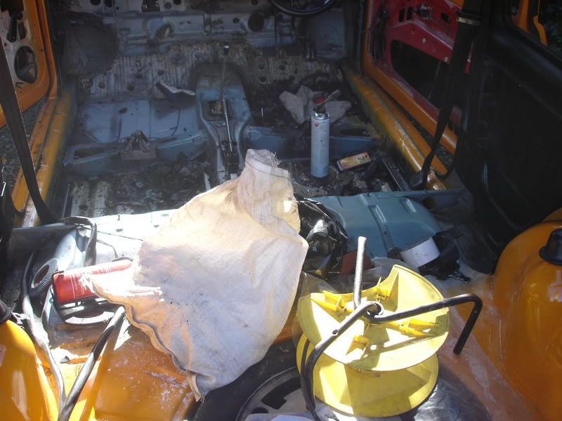

here is some pics of the progress, this is very much the easiest part, didnt take long as i didnt have to worry about breaking anything when taking it apart as it was all shot already.
only exhaust to cut off, driveshafts off and then engine mounts, and ittl be whipped out.
now that its all out, ittl give me the oppurtunity to repaint all the inside etc, get it looking completely spot on.
barren
leftover mess from engine/dash
slightly more bare
new a few weeks ago…
melted plastic everywhere…
the inferno epicentre.
there u go, not really pics to enjoy but there for the record nonetheless, all progress in some form i spose…. hopefully ill have the engine out by the wknd, start cleaning it back to bare metal and zinc primering it, ready to be sorted out, also gna be stripping a 1.1 for various parts mid week

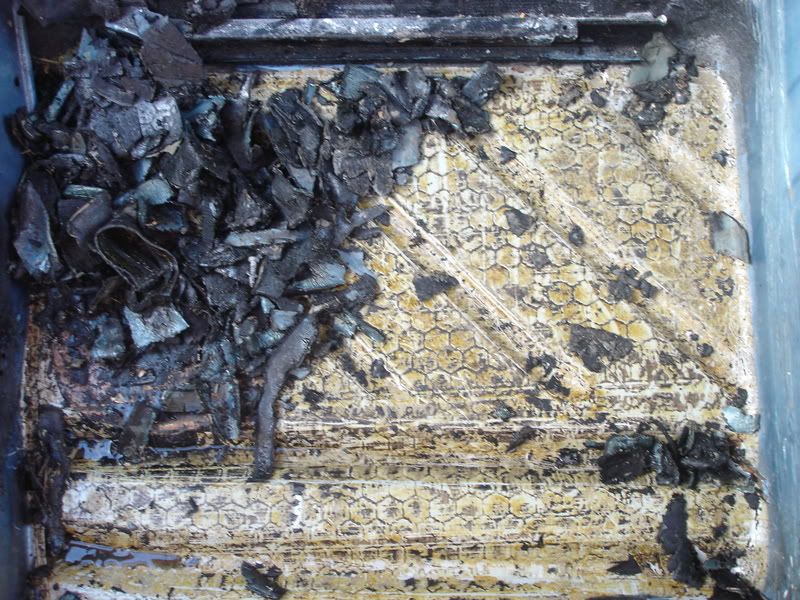

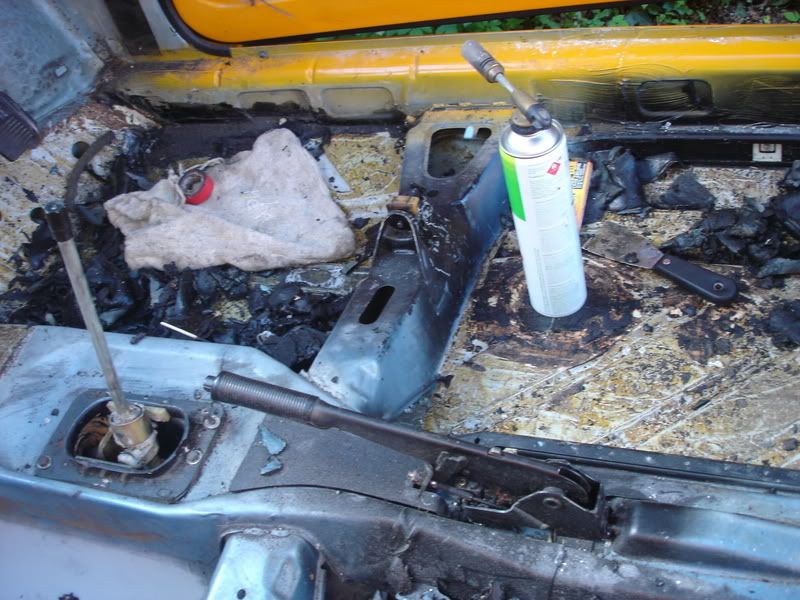

basically had the horrible job of removing all the tar matting on the floor, a blowtorch and a scraper is without doubt the easiest way to do it, the longer u do it for the floorpan gets hotter and slides off. note: the fuel lines do get very hot, so be very careful when doing the drivers side….
gna try chipping away and getting them all back to bare metal by the end of the week, to por-15 then zinc primer it.

heres the pics:
coming off nicely:
mess:
more mess:

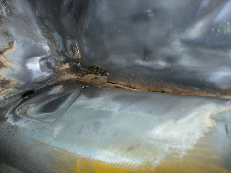

found a bit of rust, sort of knew it was here, hadnt got round to investigating it, where some idiot jacked the car up on the floor pan, needs a bit of inner sill work and edge of floorpan, shouldnt be too bad to weld.

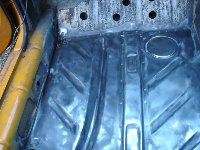

and finally a lovely shiny floorpan!!! looks awesome, only another 3 to go now… did find some pitting in the grooves, and water was sitting under the matting, so im glad i caught it now.

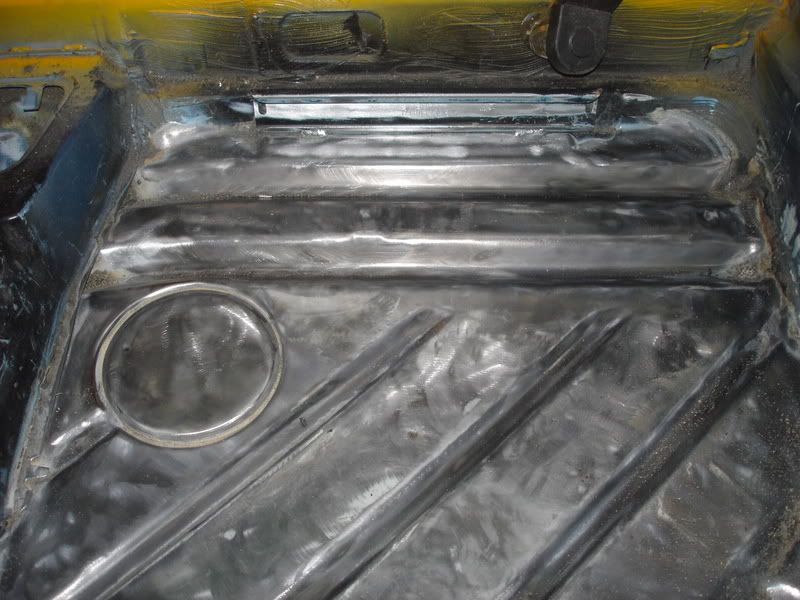

ok, finally got it back to metal, gna leave it for a day and then por 15 it….zinc primer it, then its ready to go orange again!

ok, did all the floorpans today in por 15 and zinc primer, shes ready to go orange again! updates soon…gotta get a move on. thanks for all the positive comments, it all helps.
