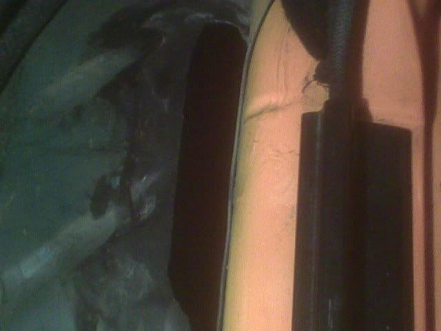

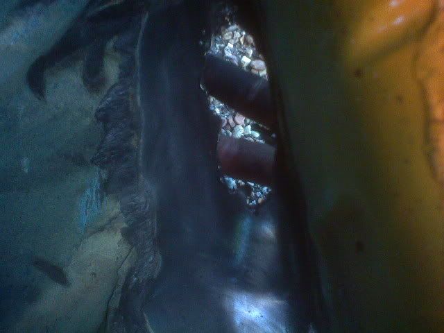

bad news on the progress front, as i was waxoyling the last few bits yesterday, picked at a bit of surface rust behind the sill, in the floor pan, took off all the underseal, and managed to puit a screwdriver through it
Dint look like anything than a tiny flake of rust, but there was lots of rust that had been hiding under the mastik and the tar sound deadening….when i saw people takign off their sound deadening, i thought it was all abit much really, in the name of weight and what have you, but now i have learnt it is well worth doing this as yet more rust was lurkign the further down i investigated…..this is what i found

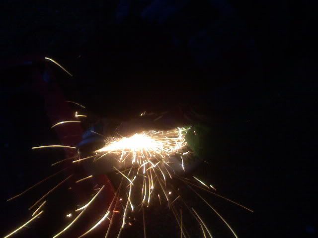

Which then after a bit of this….
Turned into this…
then had to cut a peice of steel to weld over the top, measuring 28cmx5cm, which goes to show the rust will hide from you so if you do strip the interior, go and take off the sound deadening too, a realy stiff wire cup, not wheel or brush, gets it off quite easily….
got a mate to weld it all in, and seam sealered the lot, lots of hammerite etc, so dont have to go near it for a while…

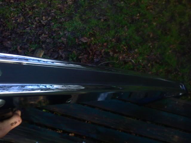

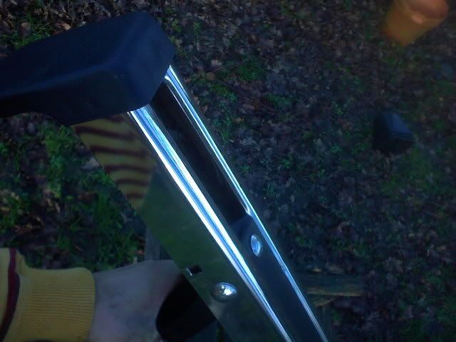

Whilst the car was away at the garage, i turned to a bit of chrome bumper treatment…bit of a good thing really, didn't fancy working in this sort of weather…

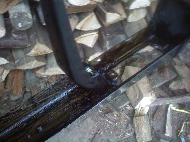

firstly waxoyled the inside, paid enough money for this and hard enoguh to find, so dont want it going anyway for a while
Then gave the bumper a good few coats of meguiars polish and wax, keep it shiny and protected..

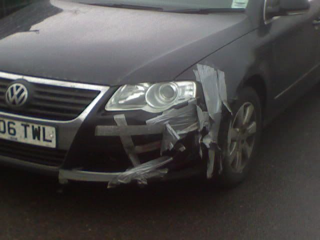

Also took a picture of this cos it cracked me up, someone is obviously a keen believer in that gaffer will fix anything…indicator still worked too lol
