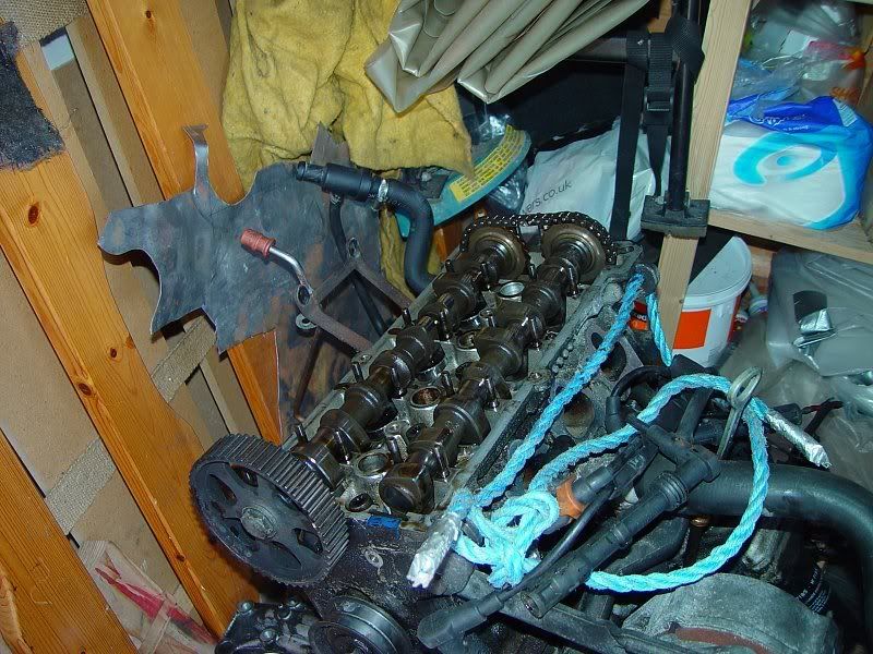

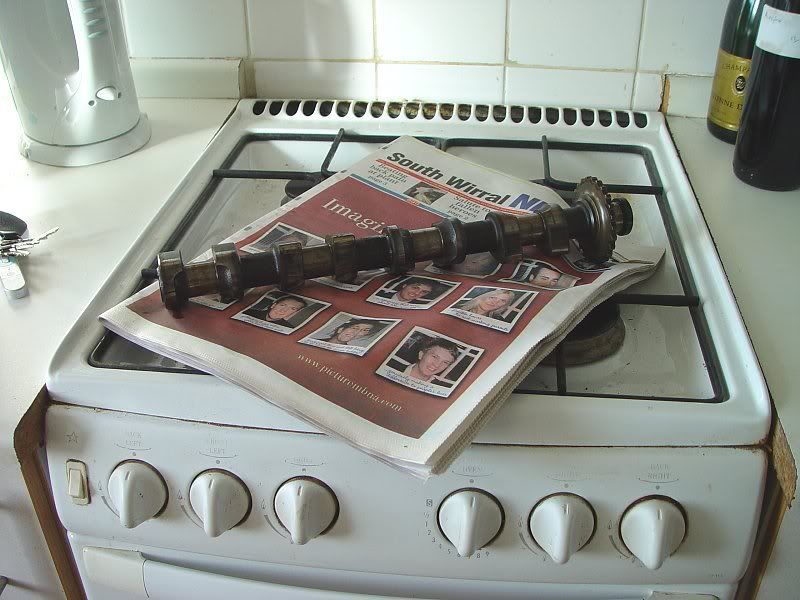

I've found a friendly local garage which are familiar with engine tuning, etc and they're going to swap the gear on the end of the cam, to the other one. All the ancillaries on the engine have been unbolted. The engine was very mucky and a pain to work on, so I refitted some of the ancillaries, so I could close up the holes and degrease it. More pics to follow…

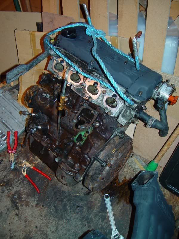

Here they are all prepped and ready for paint:
And painted:
The paint is nothing more complicated than VHT black paint, which gives a nice matt coating. I know the components technically don't need to be in VHT, but I prefer the finish:

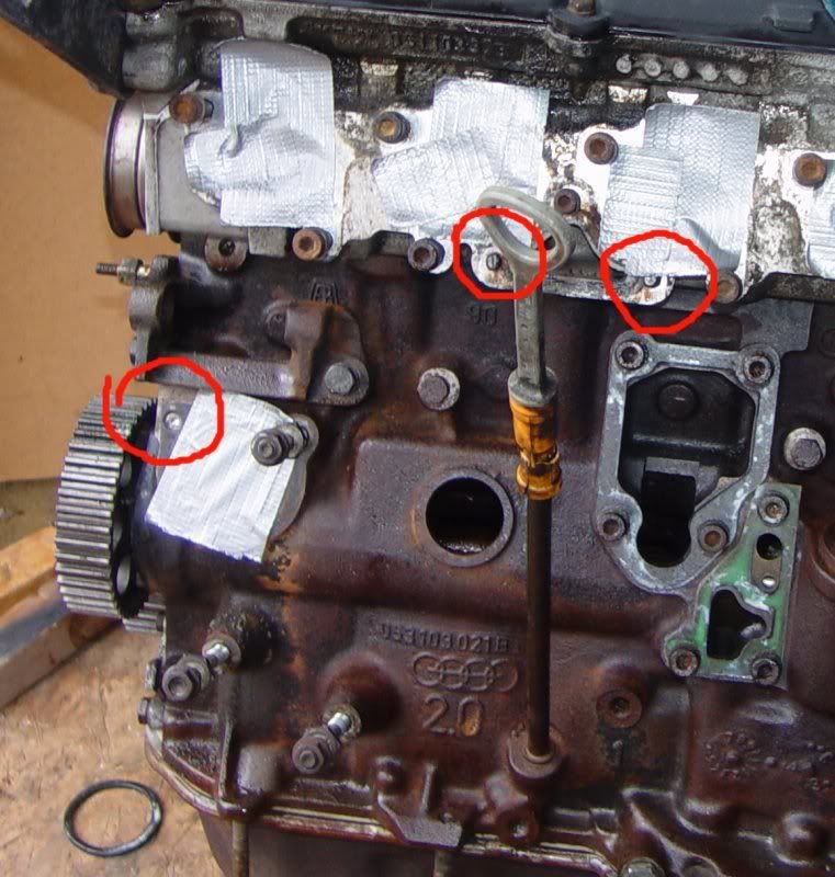

Anyway, slow but steady progress is being made. I have pretty much stripped the new block, I need to wait to get the car off the road before I can sort out which bits are going where. The block is still a bit dirty and has surface rust, so I need to have a think about what I'm going to do here. I guess duct tape over the holes, would be okay for painting it?

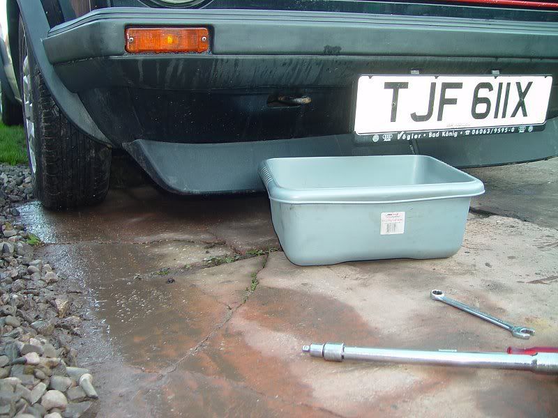

The problems of a lowered car! Spoiler has been removed, it gets right in the way when pulling out the gearbox.

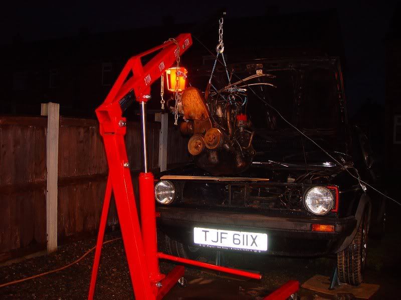

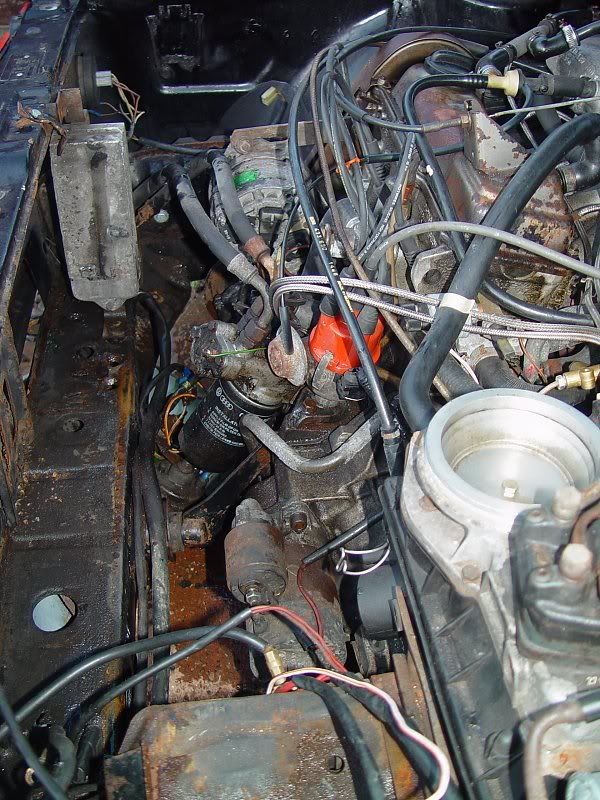

Front of engine bay is pretty clear now (oil cooler has been left there for convenience, for tonight), ready for lifting the engine out.

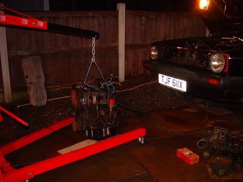

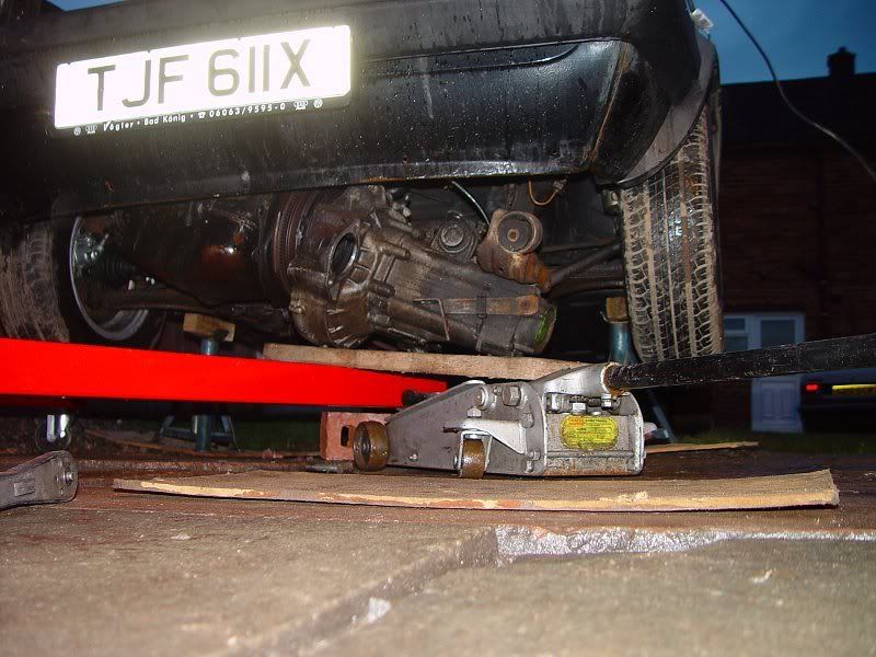

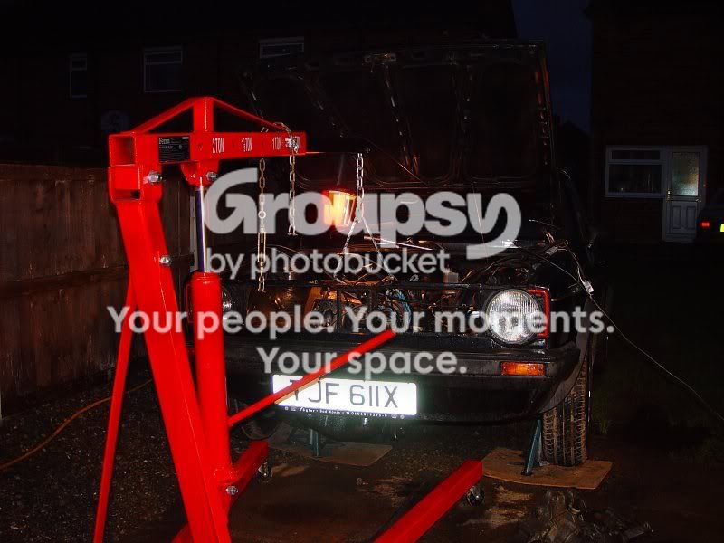

The engine and box came out using the now-familiar "over & under" routine - the box comes out underneath, which makes taking the engine out over the front panel, so much easier.
Engine's weight taken on crane and left mount unbolted. Drivetrain lowered to lean at an angle. Right engine mount left in place and gearbox unbolted and slid down a wooden board
Engine brought back to the horizontal, so that it doesn't shift on removing the right engine mount's bolt.
Gradually bringing it up and forwards, the crane misses the bonnet luckily!

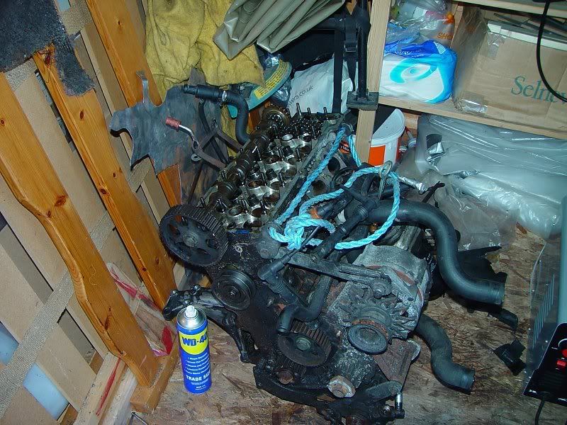

Engine now out

If I was doing it again I would lift the front of the car over the engine. You can do it from the top but it's much more difficult
theDaddyUK said
Which way are putting the 16v engine in mate? I dropped mine in through the top, never again!!! :evil:
If I was doing it again I would lift the front of the car over the engine. You can do it from the top but it's much more difficult![]()
Why not over the top? Is the 16V inlet manifold so much deeper that it causes real issues somewhere? I didn't have any problems with it this way (last time I put an 8V in), its pretty easy once the gearbox is out the way - the engine would go in before the box, and the box goes in from underneath.
I nearly took it out all underneath the car, just for the experience, the only problem is once you've lifted the front of the car, eg with the engine crane, its legs would be in the way of the engine.
