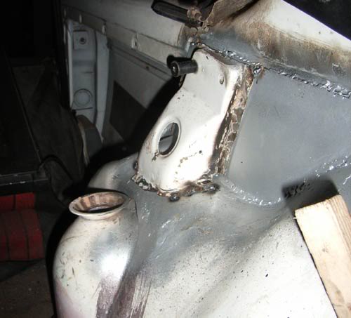

You need to have a good prod and poke aroud here and its worth taking the black plastic arch trim off to inspect the archs all the way round to make sure all is well. Also whip the black plastic breather pipe cover off as rot can occur behind here unseen.
Hard to say without seeing it, but rot round filler neck can actually come from behind and may indicate corrosion in the upper inner arch. This pic was taken looking up ino my arch with the filler neck removed. A few stabs with a screwdriver created a nice couple of holes 8O

Rear arch welding finished and ground back
With a bit of paint and filler to cover it up. More finishing to do :roll:

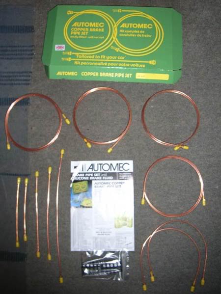

Thats all the welding finished for the winter. Going to put the car back together in the next week or so (with new rear brakes and my Automec pipe kit) and get it in the garage for a couple of days to stick some paint and wax on. Then hopefully MOT and GTI for the first time in 4 months :twisted: .

markwon said
nice avator Phill, shame restoration can't be that quick
wouldn't be much fun if it was though
suppose if you have no flarer…
however i have routed my pipes in some cases in a different way to stock to tidy the bay up - but with that kit i guess they will be stock lengths….
Life Member
so with that kit all you really save on is cutting the pipe and flaring it?
You're quite right, I don't have a flarer or a lot of time
