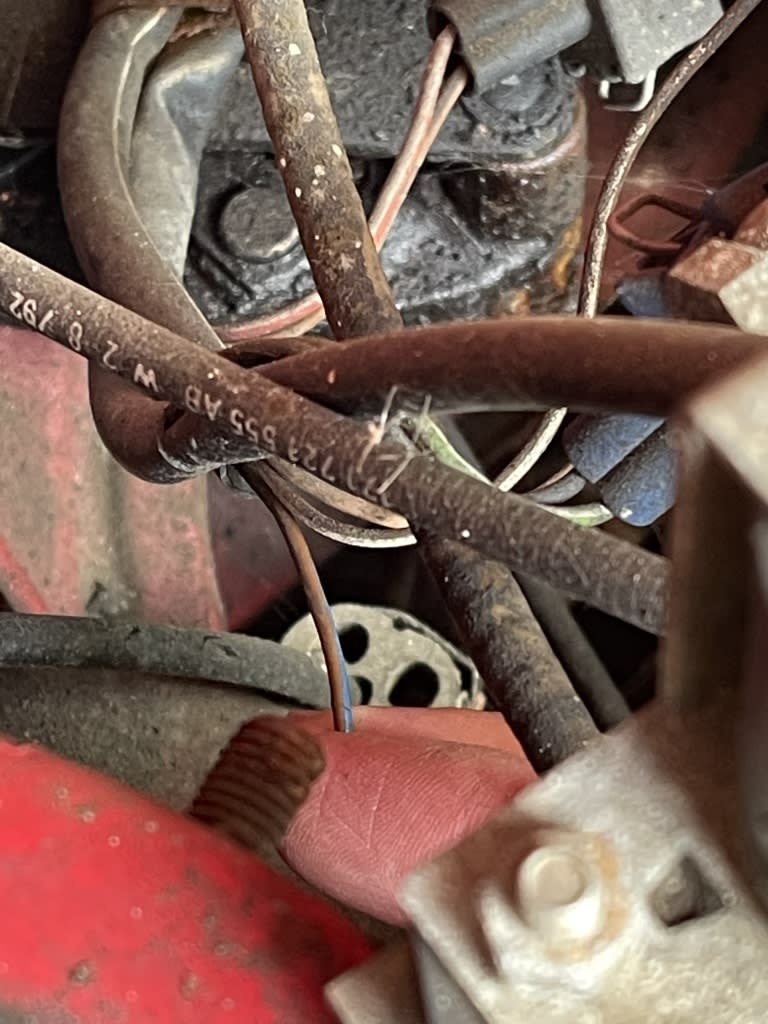

Started, ran rough for 5 minutes, then stalled when I dropped down to idle and no re-start

A clearer picture of the lose wire, which is brown/blue coming out of the sleeve with two other wires. At the back left of the engine near the manifold

cheers Paul
VW Golf Clipper '93, BMW X5M, Abarth 595, VW ID3, Porsche 911-50th
Regional Host NE
Fantastic result
