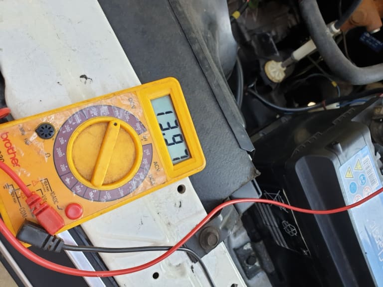

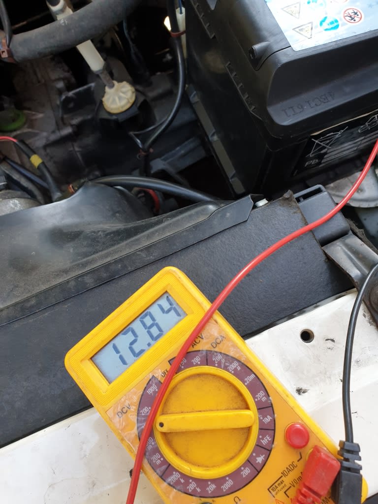

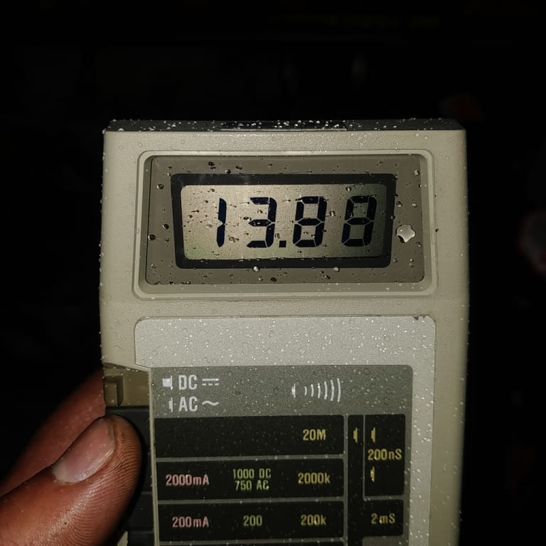

For ref just been out in my 1.8 Carb Cabrio, totally factory. At rest 12.8v but would think it would settle down to 12.6v. Running at 850 rpm idle or reved up just short of 14v.
I would also suggest that you replace your battery to frame and frame to engine ground as well.

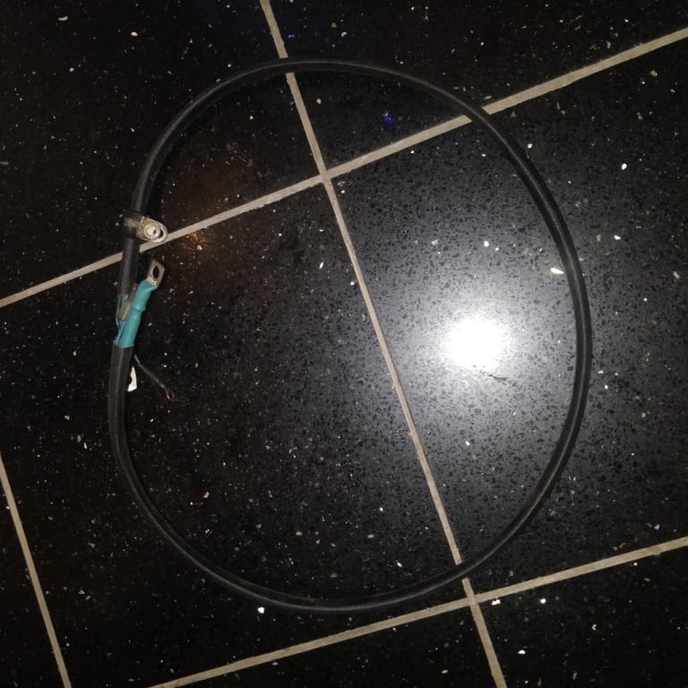

Will removing the old wire, I noticed the inner steering rack boots are shredded lol…..I was getting ready for MOT next week, glad I spotted now.
Will keep you posted after installing new cables.
Thank you.

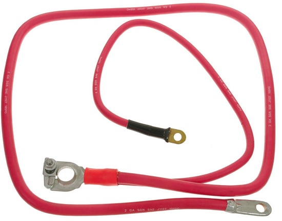

Can anyone please advise where I can source therm from?
Tried eBay, but can only get the wire and terminals separately……I don't have the proper equipment to crimp.
I prefer buying ready made.
