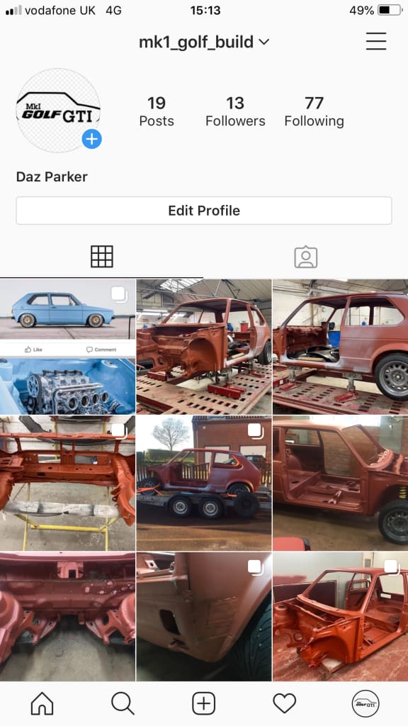

I've started an insta page too if you want to follow it 🙌🏻

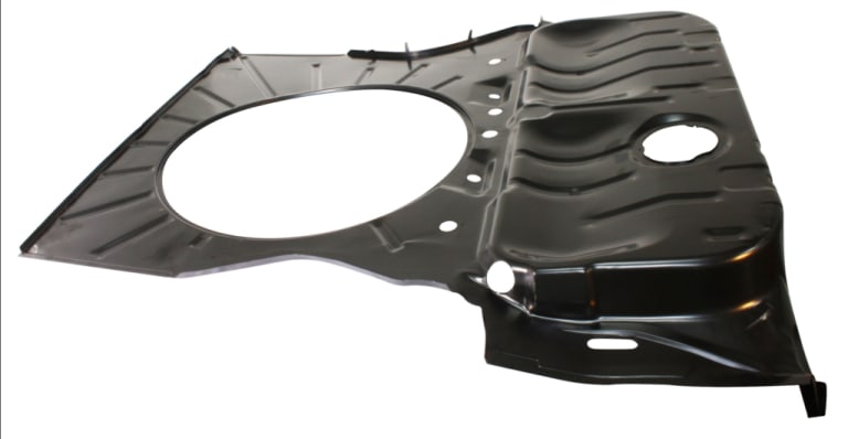

I'm struggling to find this panel, any suggestions?
I could get away with just the boot floor, if not I'll have get one fabricated from scratch as I can't do this much work and leave that boot floor 😳
