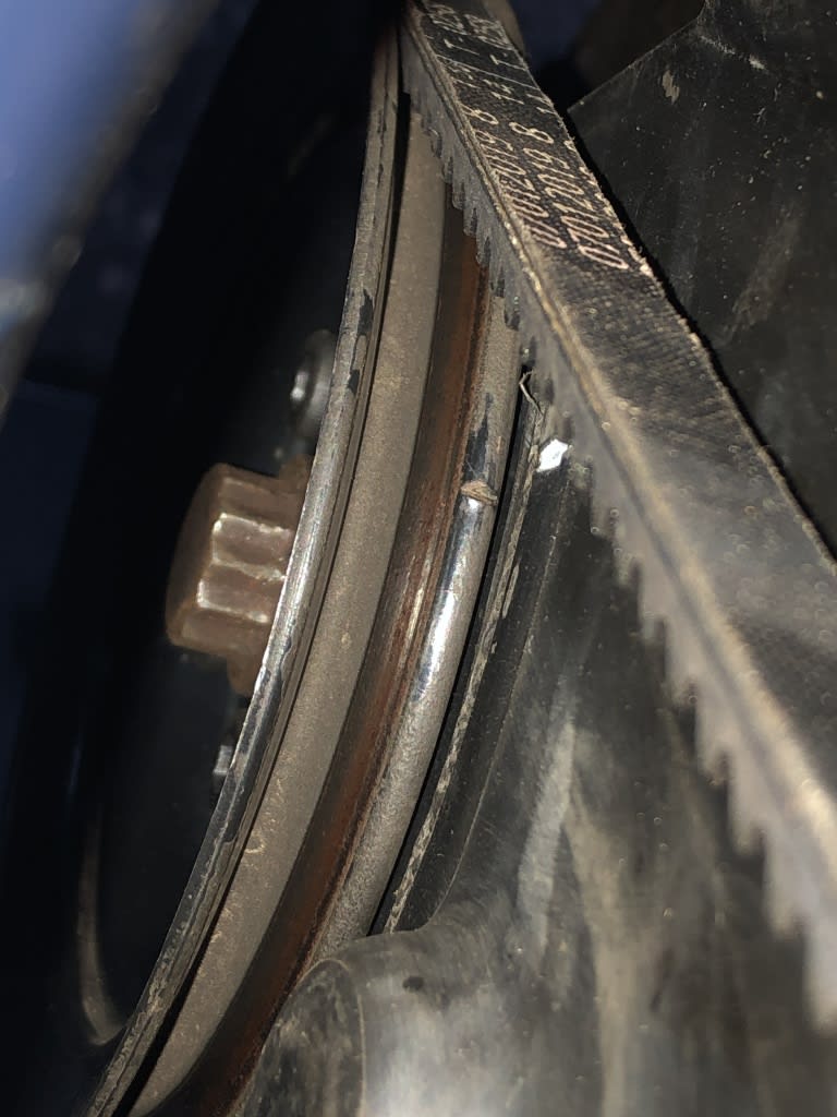

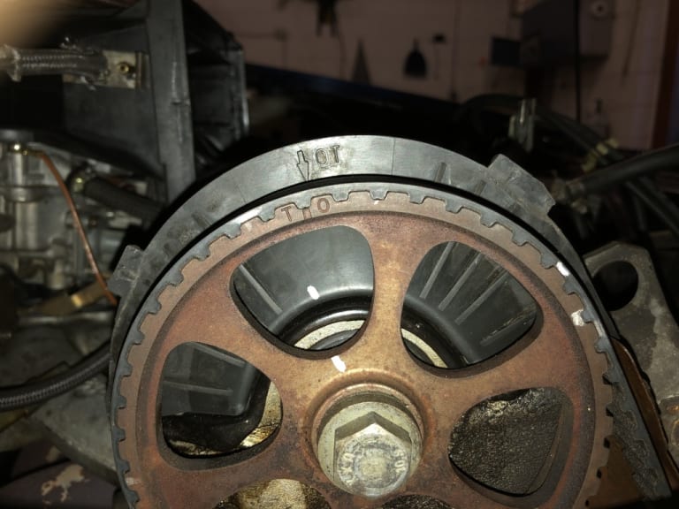

New issue: just fitted everything back - water pump, timing belt and so on. Everything was on the marks, but the crank moved a bit when adjusting the tension.
I just fired her up, and now have a very loud ticking noise - sounds like it's coming from the valves. Is it due to the crank moving a bit when doing the tension? How to avoid it?
I am curious on the moving crankshaft, though - could it be because I overtighten the tension pulley? I can twist the timing belt 1/4 between the cam and intermediate sprocket, but it's kind of subjective how much force I'm applying…
Could be you are a tooth out on the cambelt as it should all line up once tightened.
I find the cambelt either goes on 1st time no problem or I spend ages getting everything lined up as it moves when you add the right tension.
If the belt is to tight it will sound like you have a supercharger fitted and wine away.
It doesn't jump a tooth. If I rotate the crank one tooth, it gives a bigger offset on the flywheel than what I see now.
I went through it three times, and noticed the last time, that when the "slack" in the belt is picked up by the tension pulley, the crank rotate just a little bit clockwise.
It makes sense, since the tension pulley "pulls" upwards when I adjust the tension.
The belt did start to squeal a bit after a minute or so running. I stopped the engine and slacked the belt a bit… I just realized that I didn't check the timing marks after slacking the belt… I better go have a look!
I'm doing it without the spark plugs fitted, maybe it would help to fit them before adjusting the tension?
Cam at the 0 mark.
Dizzy rotor in the middle of the hash stamp on the side frame.
Do not worry about pulley marks on the front to align the dizzy, just set it like I said and with that you should be good to go.
I went through it all again a few times, and the cam always moves a bit backwards when tightening the tension pulley. I had to release the tension a bit, as the belt was whining as it heated up, so I obviously over tighten the pulley… it's running as it should, though.
