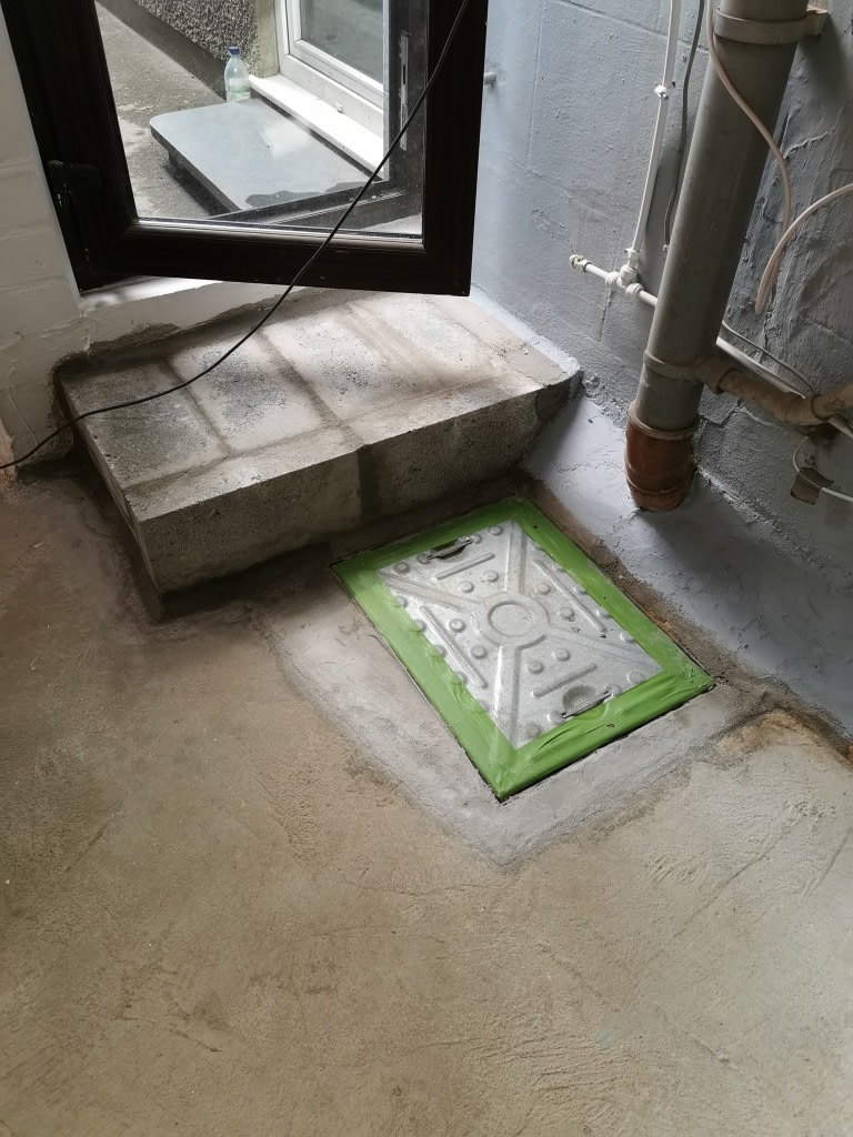

I also finally got around to building a step into the garage as well. Turns out I'm not a block layer, so I can add that to the ever growing list of things I'm not good at

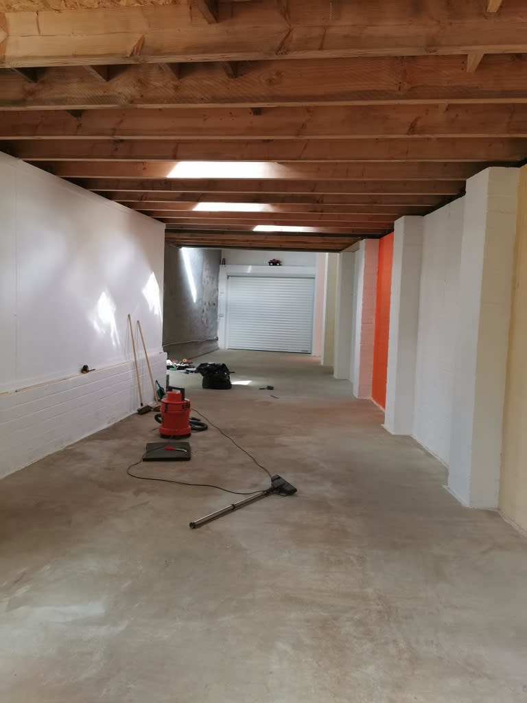

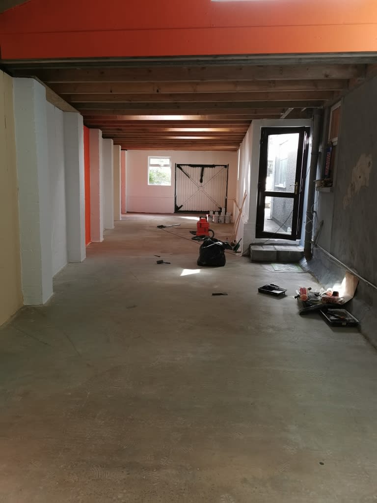

As you can see the garage is now empty and prepped for floor epoxing. Numerous sweepings, hoovings, moppings, wet vaxing and finally on my knees for two days with a wire brush to get the ground in dirt out of the concrete. I'm aching to say the least!

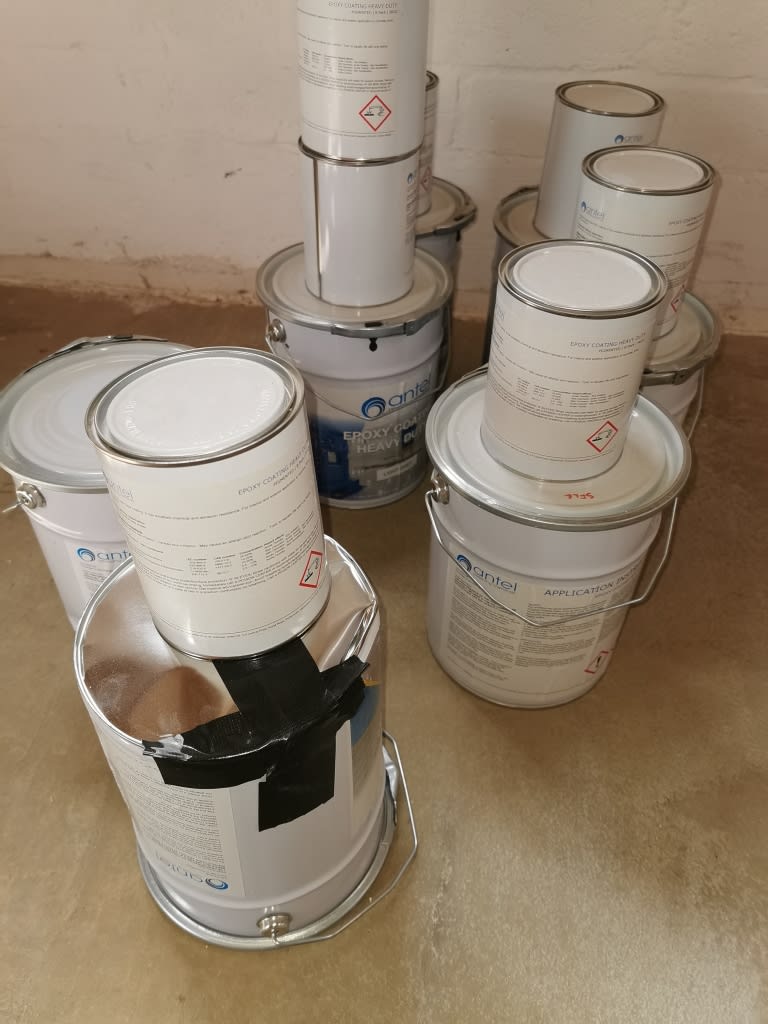

After a lot of research I finally went with Antell heavy duty floor epoxy. At £600 it was half the price of the recommended stuff. Lets hope it works ok
Of course one tin got damaged in transit but luckily without the catalyst added it doesn't go off, so hopefully it'll be alright.
Wish me luck! Hopefully updates will get a bit quicker once the floor is dried.

I phoned and had a chat with them about it. They suggested I went with 7 of the big cans. 4 for the first coat (which just did it!) and 3 for the second coat.
No primer, sealer or etch was needed as it was new concrete and not stained.

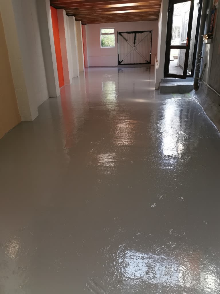

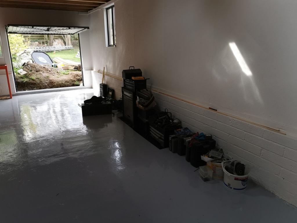

The first coat is down and I need to let it dry for 24hrs before the second coat, but as I finished at 6 o'cock last night I'll leave it 36hrs. There's a 48hr window to re-coat according to instructions. So next update in a few days.
Lets hope it sticks ok!
Ian

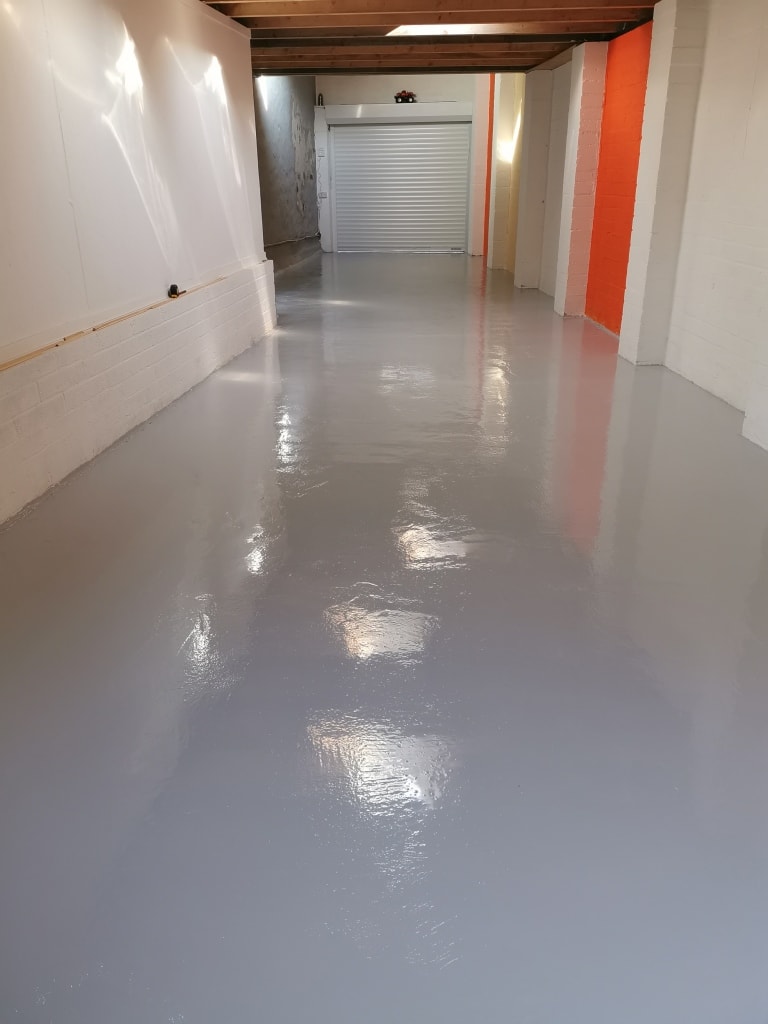

First coat was a little thin come the end, could have done with another 1/2 can (I used the 5kg packs) and then with the second coat had about 1/2 can left over!
So if you ever decide to do anything like this I'd suggest getting a couple of small packs rather than all big ones.
I also added a palm full of sand to each of the final coat packs. Where the film thickness was thick it seemed that with a bit water on the surface it would be very slippery.
The sand seems to have added just a bit of grit to the surface, hopefully it should stop me slipping over if the floor gets wet.
I'm happy

Rich. 24 hrs to walk on and 48 before heavy traffic! Really quick drying times as it's a 2 pack.
The pics show it dry. That shine is from the product.

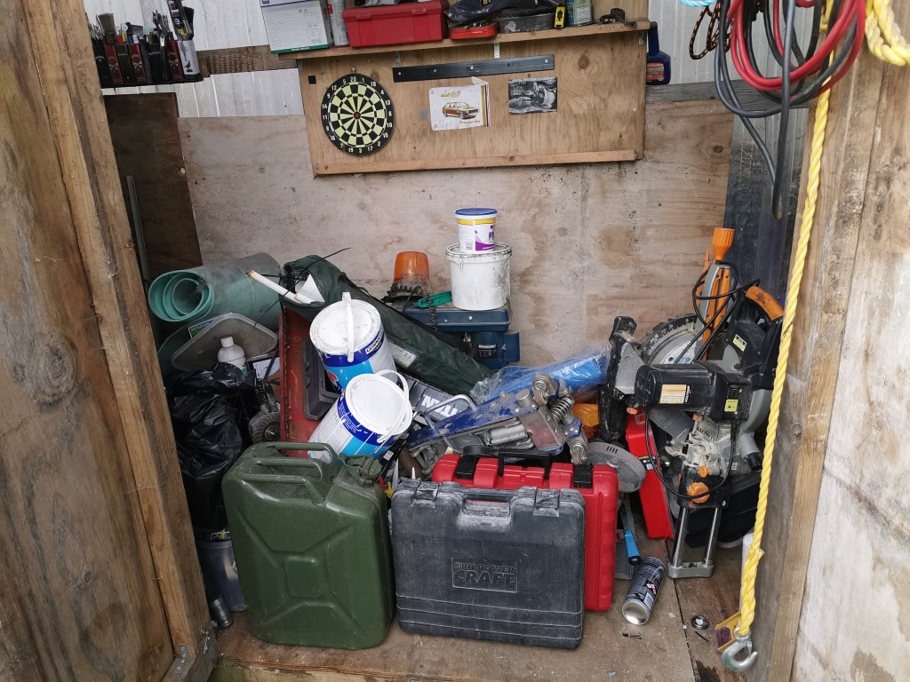

Made a start emptying the Plastic Shed yesterdya to get at my bench. It got moved from the old garage into Plastic Shed and then used, infrequently, over the last 2 years or so. Plastic shed also housed all my tools as well. Emptied it all out into the garden and was amazed how much stuff i have. How in the heck did I ever move n the old garage!
Piccies tomorrow as I'd like to get the bench and some shelves up today.
Wish me luck
Ian

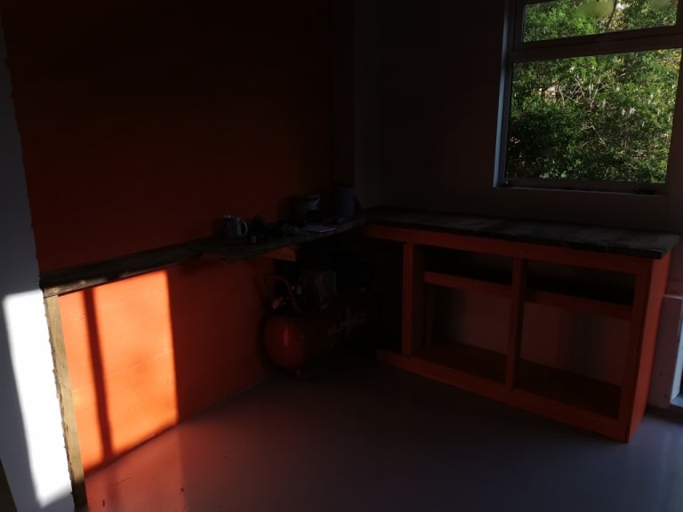

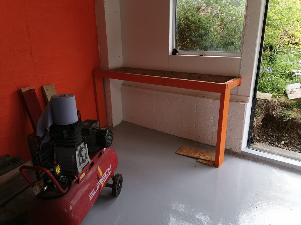

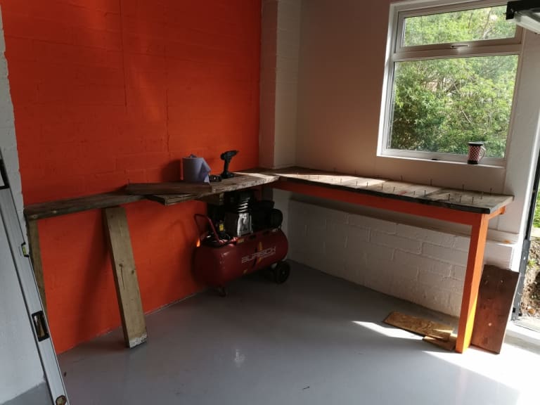

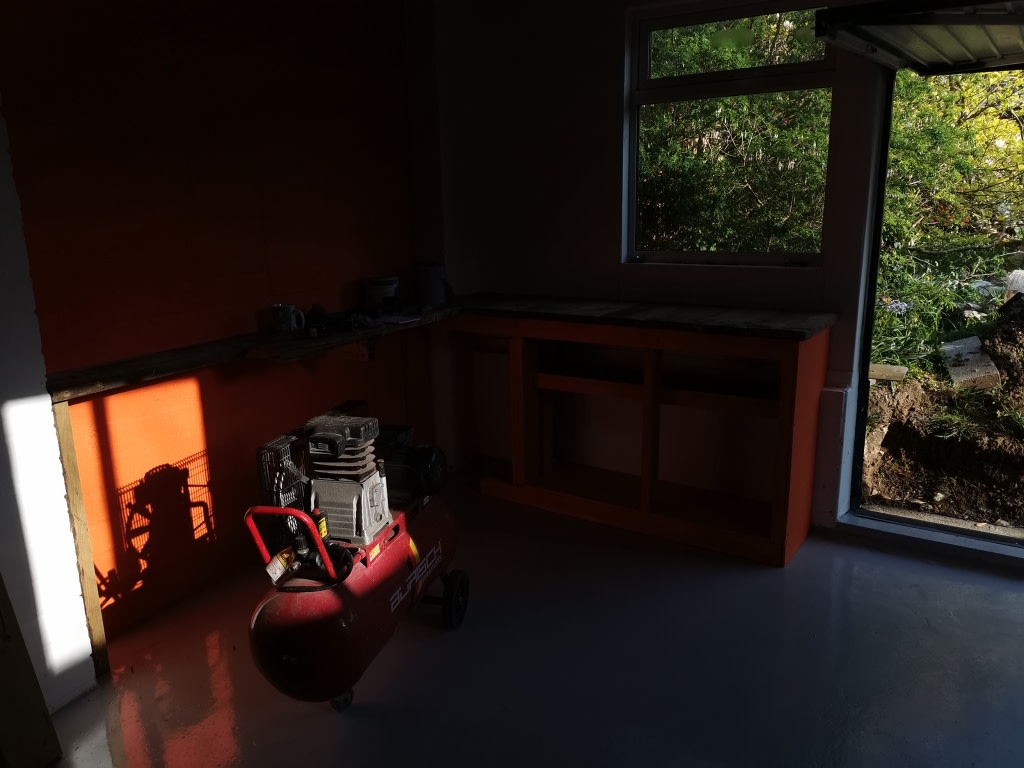

Well I promised pics of the progress so here we are
Impressive eh? Who kne that making an old bench frame fit and actually be level would take so long. Talk about waiting for paint to dry!
I'm also trying to figure out the best place to put things so I don't end up either reducing the width even more or with stuff not being accessible once the cars are in it.
I moved some stuff down from the Plastic Shed
But much more to get moved yet!
I thought this would be the easy bit, but with trying to think it all out and it being so quiet at the moment I'm trying to be a good neighbour and not have power tools running. Even cutting timber is taking 3 times as long.
As well as tool storage I'd like to be able to have the drill press, bench grinders and polisher all out somewhere in an easy to use position but without losing floor space.
The stereo set up also needs to be housed along with a TV and computer set up so I can stream music and look up helpful hints on the internet.
Good job we have plenty of time at the minute innit?
Ian

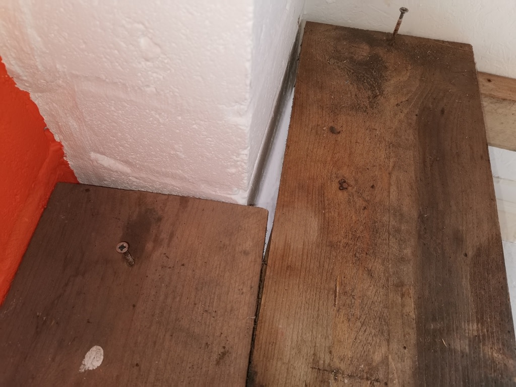

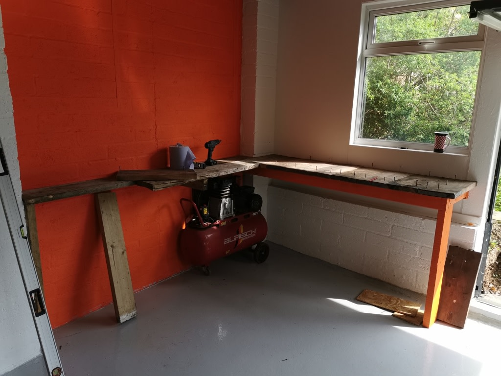

So a bit more done. I'm having to scour the garden for materials and then, as most of the materials left have already been used in Civil Engineering projects, remove the concrete or assess for stress damage.
It also takes a while as I have no 90 degree corners on this building either.
For example
So instead of just being able to bang straight stuff together nice and easy, a bit of bespoke joinery is required!
Planks will hopfully hide the compressor and end up as the home for bench mounted tools, grinder etc.

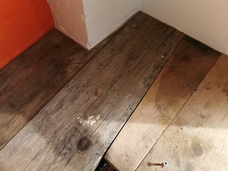

And finally with the freshly varnished planks laid loose on the top. These will have a mat of some sort over the top when done. Doors will also be added when I can find some hinges!

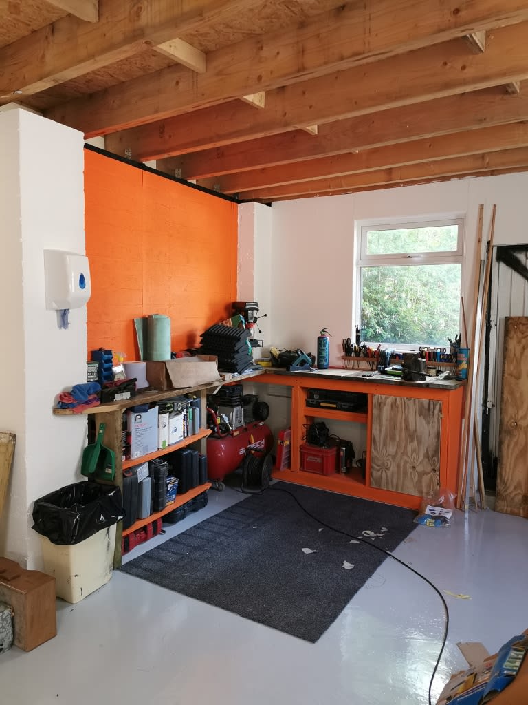

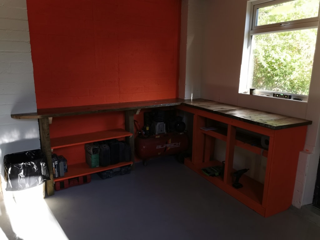

Been busy with shelves and sanding and a bit of varnish too!
The plan is for doors on the cupboard under the window opening in the usual way.
For the other bit, the intention is to build a metal frame on hinges that will hinge along the top. This will effectively then be used a welding table. Unfortunately my steel supplier is on lock down as well so no chance for a minute.
It'll also be clad with ply with some quick release fixings to allow it to be used as an upholstery bench as well……………..
At the moment it's at this point.
For some reason my camera hates the light in the evening at this end of the garage!

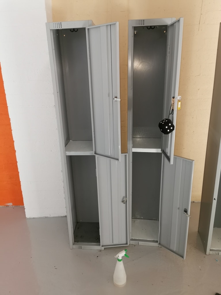

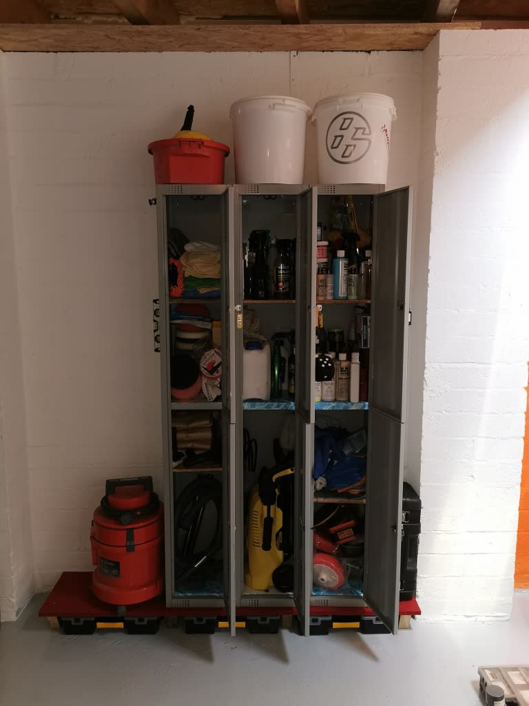

I obtained some lockers from a site I ran about 7 years ago with the intention of using them in the new garage. They've been in my office in storage and have ended up being used 'holdalls' for anything that should have been in the garage but never quite made it.
In my head they were always going to be for the detailing stuff. So I emptied the shed of the boxes and bags of stuff and started orgainising. Of course, due to the floor not being completely level, especially around the walls where the tanking slurry was used to stop moisture coming in under the block, they didn't sit square, straight or level so something had to be done.
After a lot of thinking I finally came up with a shelf for them to site on. Finally decided to make it just big enough to slide some organiser cases under it.
I'm sure they'll end up being emptied again and more shelves installed as time goes by, but I'm nearly happy for the moment. At least I can finally wash the cars again!

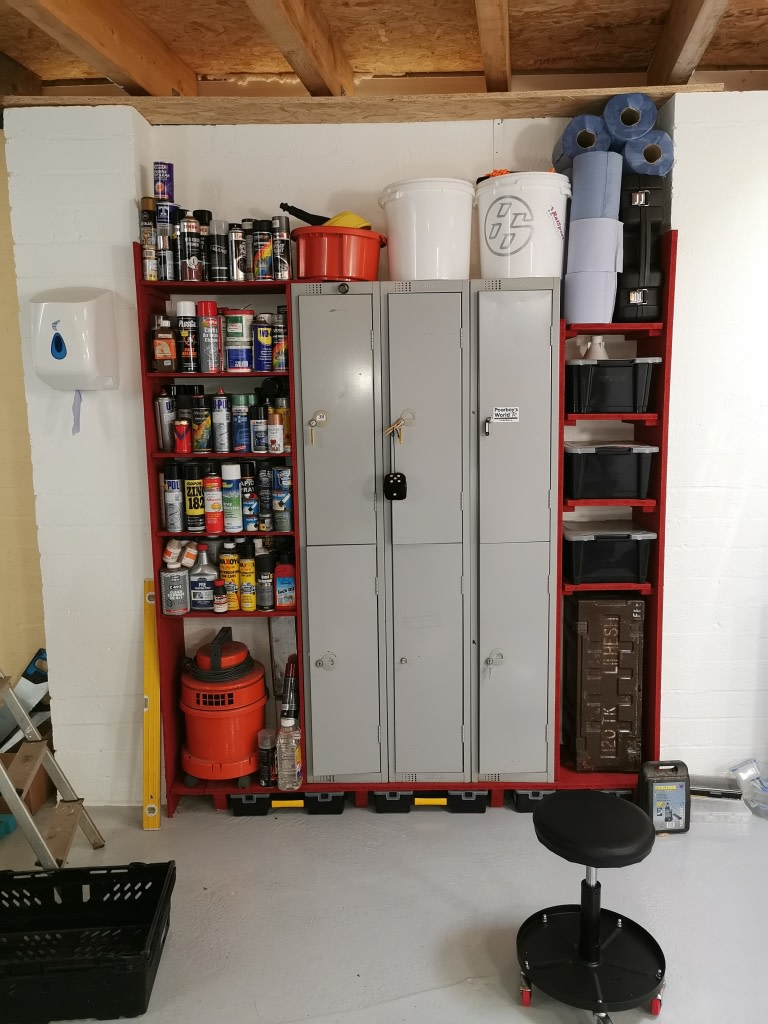

I suppose next job is shelves for spray cans, bodywork stuff and things.
Still trying to decide on a tool box too……
