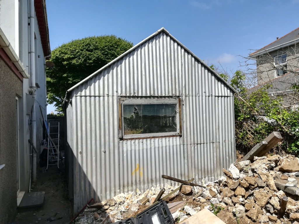

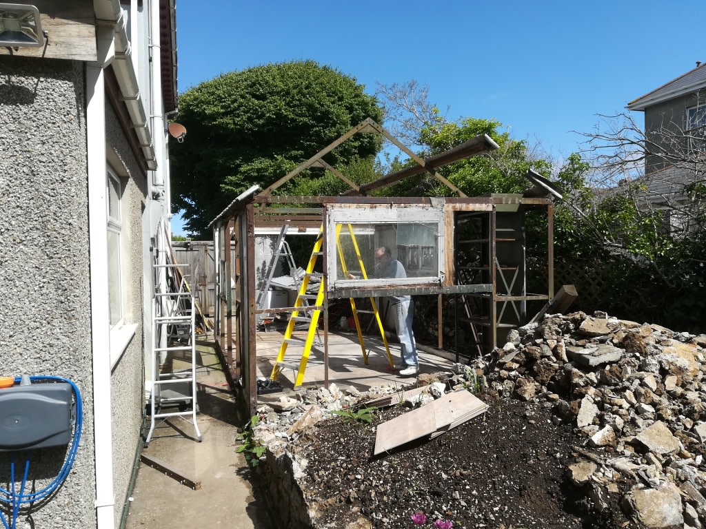

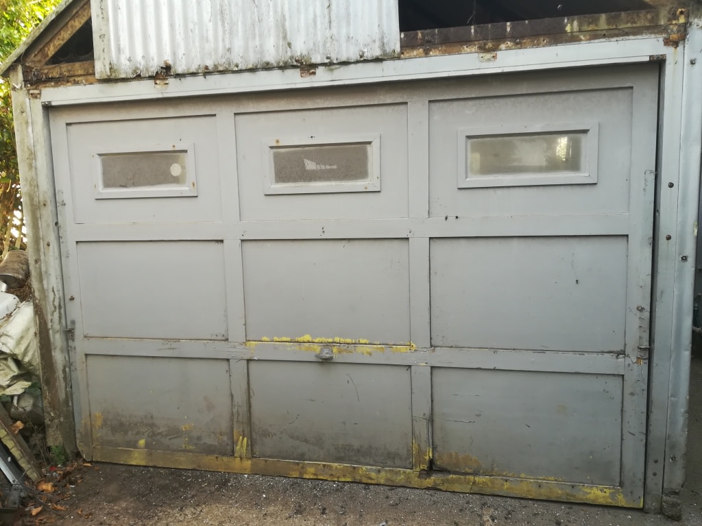

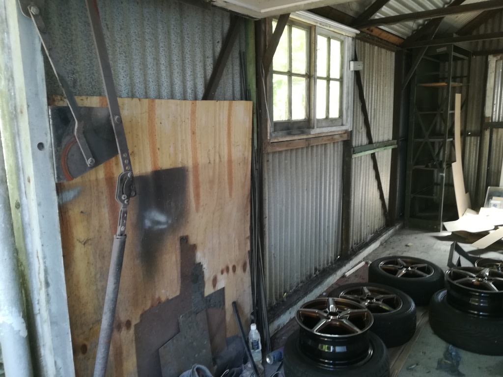

Oh yeah. Also took down the olf garage
which was slightly dodgy to say the least!

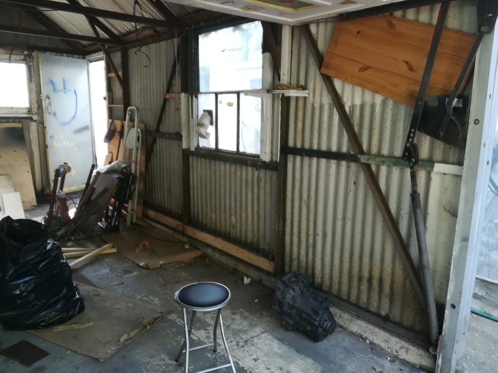

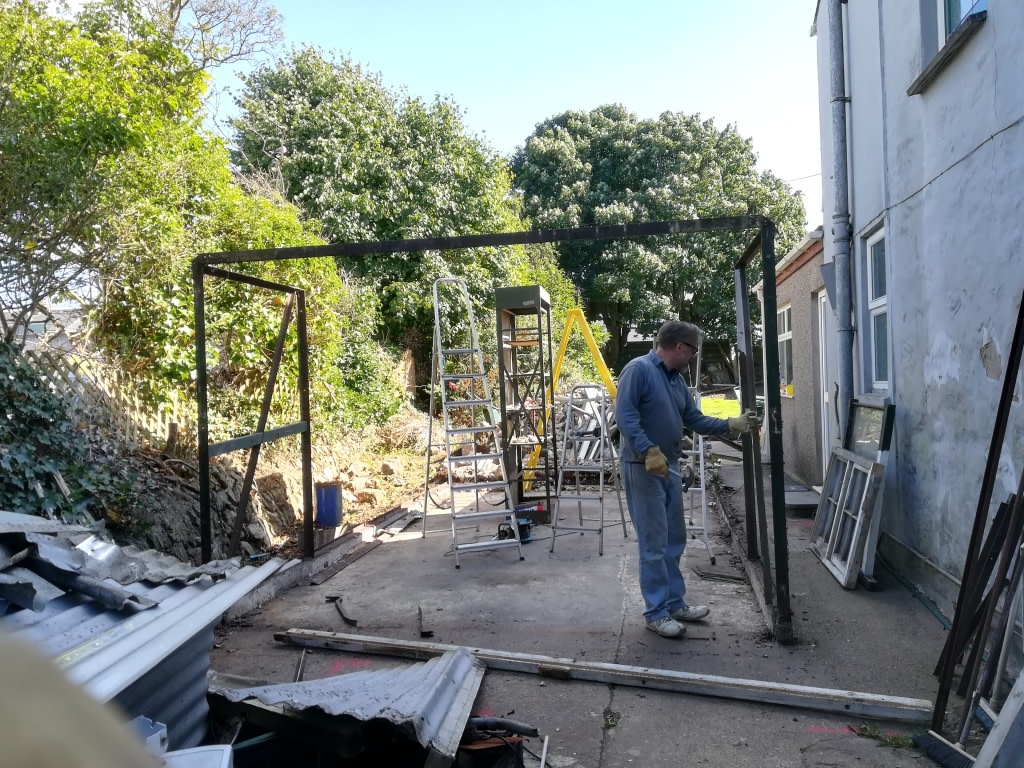

Part of the reason for the renewal was the frame had rotted out at ground level on about 1/3 of the entire structure. The only thing holding it up was my wooden frame inside and all the ply I'd lined the walls with.
Anyway, with a bit of thinking and careful structural analysis, a reciprocating saw, a couple of step ladders and a friend we managed it with only two bruised fingers and 2 minor cuts between us! And only one piece of angle got away from us and fell. Luckily it fell away from us and missed the gas meter box by about a foot and of course it was virtually the last bit too.

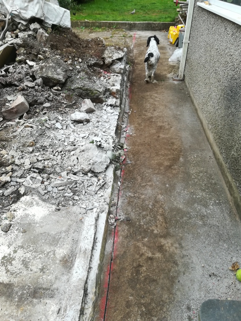

Had a digger bloke over and discussions over how and when to clear the site were had. Looks like later in the week
From discussions I realised I needed to cut a line at the edge of the new build from my existing paths and bases and my gates were too narrow to get his digger through, so a bit of work was needed to open up the entrance a bit.
Luckily the gates were hung on the house on one side and on a bit of block wall on the other.
I hired a disc cutter and although it's been many years since I'd used one I thought it's got to be the way forward. Chop a nice straight line and re-attach gate posts to wall, add a bit of timber to the gate and voila
To get my hand and eye back in it (so to speak) i thought I'd start with the straight cuts on the floor. Easy, I thought to myself, I've seen this done loads before. How hard can it be?
Erm, well after an hour of trying to start the damn thing, including reading the instructions ( I know! How often do we ever read the flaming instructions!), watching vids on youtube of how to start it, going to Stihls website and reading their instructions, I finally gave up and returned to Speedy Hire.
"Look, I know it's been a while and I may have turned into a big girl over the last 10 years, but I can't get this bl00dy thing to start!"
"Ah, we've had some problems with some out of this batch let me try" says the chap behind the counter.
Nope the saw was broke. It turns out I'm not a big girl after all. Yay
So return and try again.
Dammit, forgot the water suppression kit. Oh Well I'm sure it'll be fine. Donned the appropriate goggles, ear defenders and dust mask and cracked on.
Now what I hadn't reaslised was just how much dust would be made when cutting a 10m long line would creat so much dust. It looked like it'd been snowing! and of course I forgot to close the back door, erm, and the kitchen window.
DOH!!!!!
SO then onto the wall. Gates came off ok but the fastenings holding the gate frame to the wall weren't so easy. Snapped fixings and all sorts of trouble. Oh well, the usual then!
Marked out the cut on the wall and went at it. Biggest problem was being up a ladder with a disc cutter! it's heavy, unweildy and water goes everywhere! Still I was due my annual shower anyway.
But it's done. and not to bad a cut, given I had to come from both sides and try to join them up.

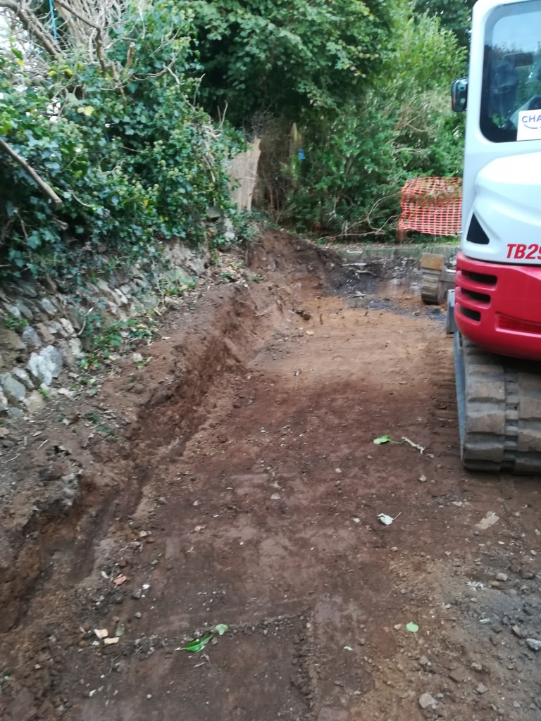

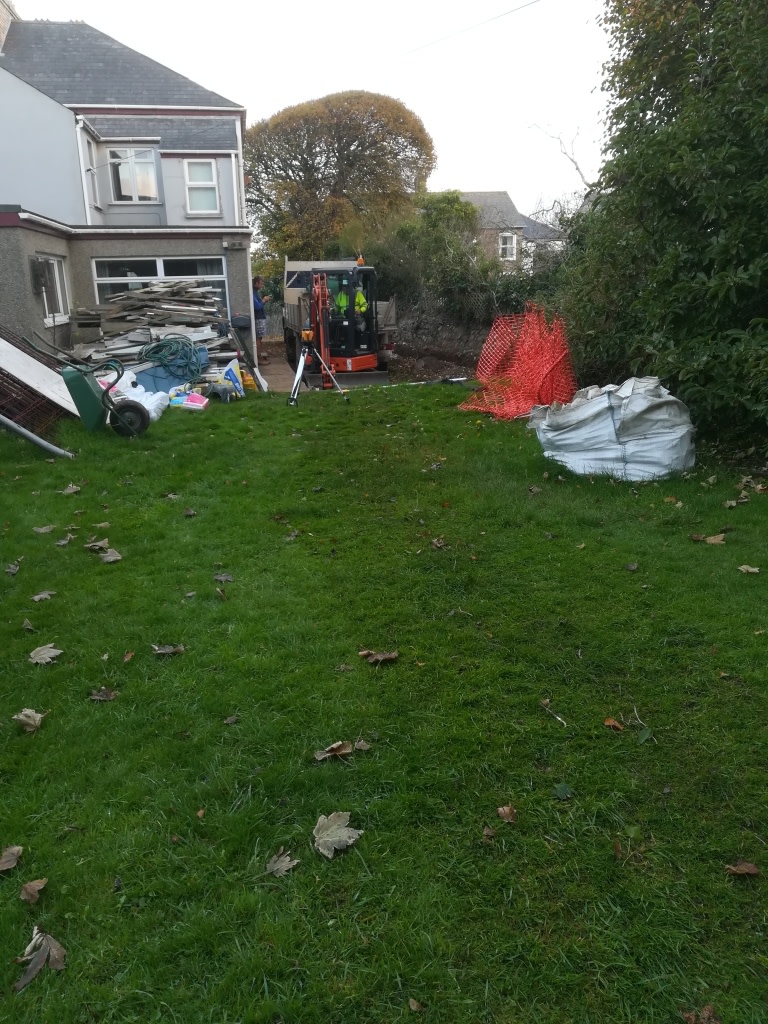

So I also got my plot dug out yesterday. But I did cheat somewhat in the use of an 8t exc and 16t lorries to take away the spoil. 3 and half loads removed. That's over 50t!!!!!!! It would definitely taken several years with a shovel and skips.
Remember the gates I took and down and widened? Well I widened them to around 104 inches. Did you know that a 6 wheel muck away lorry is 100" wide? Well you do now! Plus with a really good driver it will fit in the gap
There was a bit of shuffling to get him in the drive and requests to neighbours to move a car but apart from that no issues.
I was dreading this bit due to tight confines and digging at the side of a house over 120 years old and what we might find!
As it turn out we only found seven unknown pipes in the ground!! Luckily the actual 'live services' were a bit deeper so we only skimmed the top of the water and gas which were in new alkathene pipes as they should be, they also even had a sand layer over the top which gave us a clue

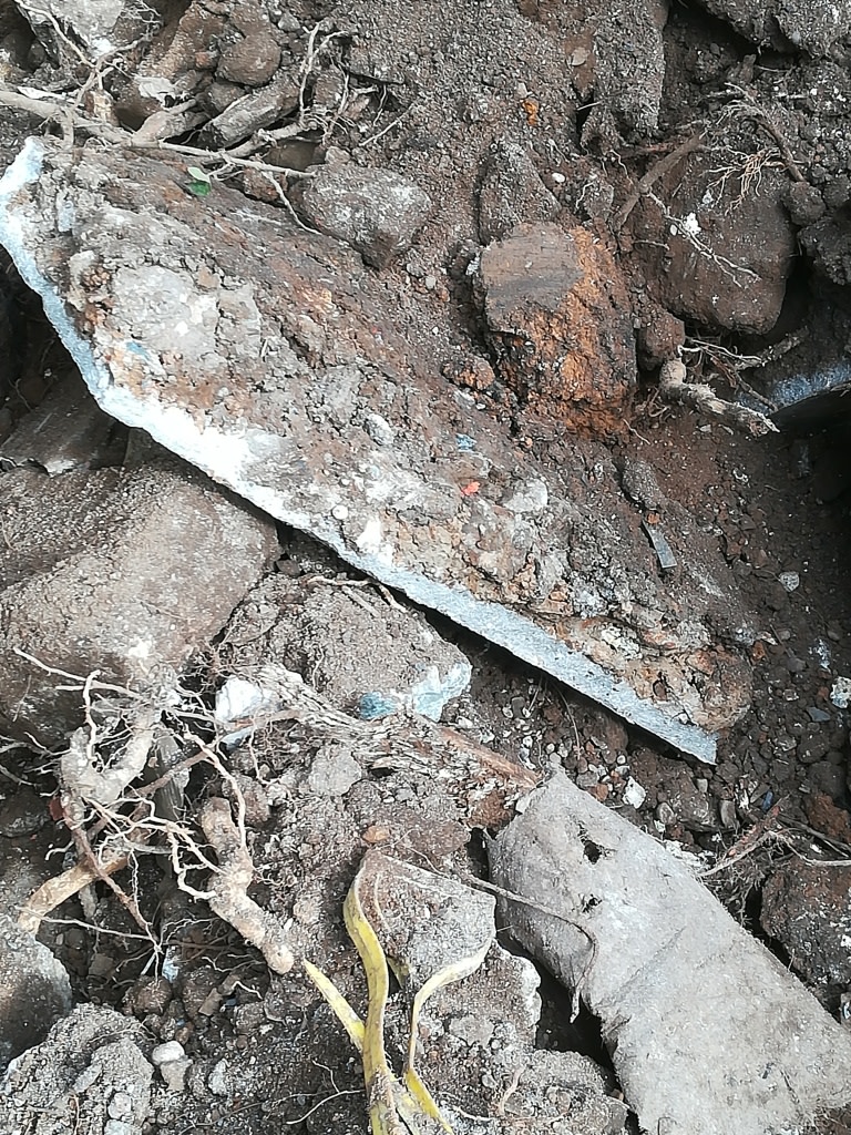

Thickness of the old base to the garage

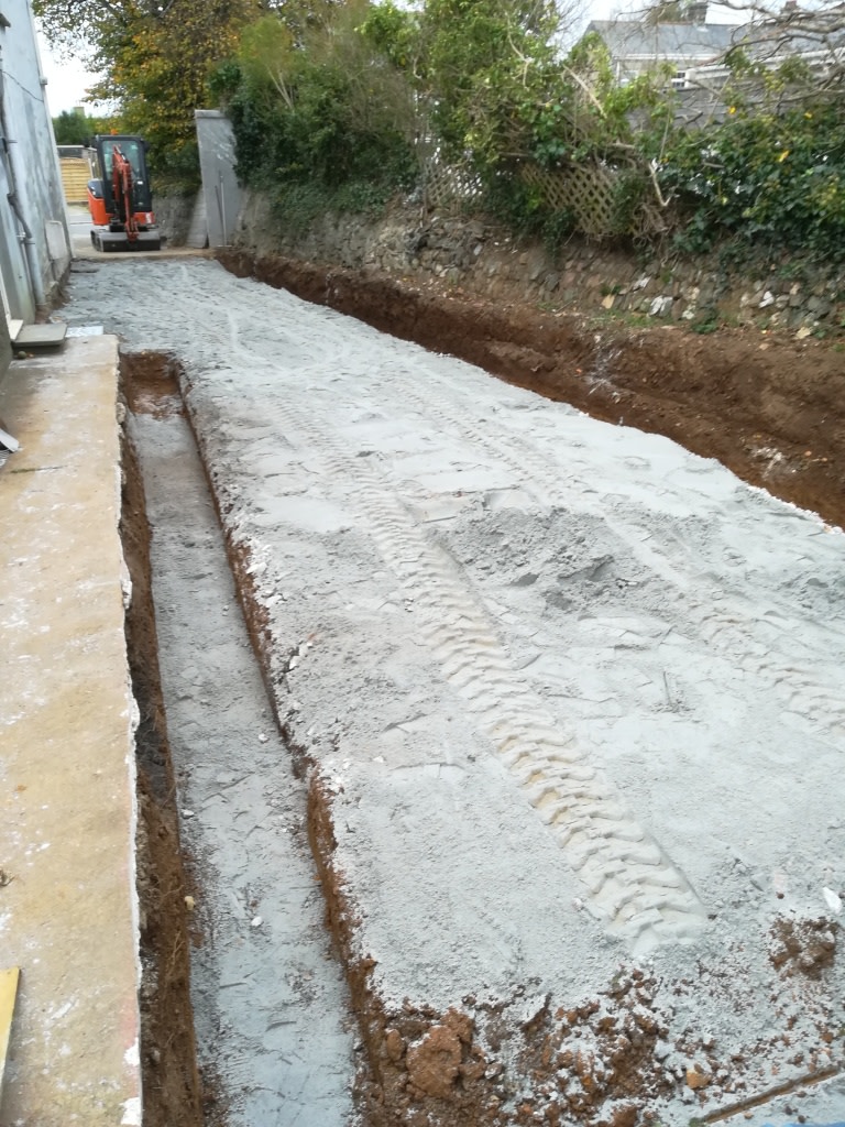

Got the edges of the raft dug, some 803 regulating layer in and the soft spots dug out and filled up.
Also managed to get the sand blinding layer in.
