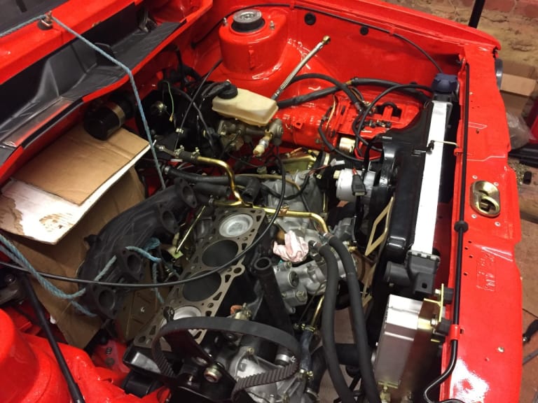

Gearbox finished.
Many new parts fitted including all bearings, needles, 1st/2nd Sync Hubs, 3rd/4th Sync hubs all 5 sync rings, diff bolt kit, starter motor bush, Clutch actuation parts, new reverse idler gear. Spent roughly £1000 on parts alone. Maybe over the top but as this was the actual box promoting the new 5 speed it kinda needs to be as right as it can be while the not so common parts are still obtainable.
big bit in over the holidays. Waiting on Head gasket now as never realised GSF supplied me with an 1800 one. 1600 gasket coming from Germany. IMG_0670.JPG IMG_0669.JPG IMG_0668.JPG
Using an old block to set up the valve clearances. I really should make a pair of proper stands. IMG_0674.JPG

I've always fancied tackling a gearbox (I have a spare). How difficult a job is it? I'm competent with engine rebuilds, but I'm guessing it's the specialist tools that make it less of a diy job.

You need a press for sure with the right size collars, plates etc etc, a bearing splitter for the main bearing that sits behind 5th, really an internal puller for the pinion taper bearing thats sat in a blind hole. You have to shim this bearing up so theres a chance you have to remove it a couple of tims in the process. I'm lucky I have access to a machine shop so can make any tooling that was needed.
have a look here for a step by step guide. http://www.brokevw.com/
