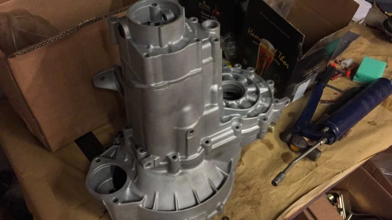

So after rehoning the engine and getting it skimmed I did a few more miles. However honing it as much as I had enduced some piston slap. Knowing how impossible it is to get pistons decided to pull the engine completely and get it relined and rebored in case I was causing further damage internally.
I took the block and pistons to my nearest engine machine shop who happens to be Robert Walker Engineering ( a legend in the Mini scene) and he did the necessary work. Another story has come from this visit to Rob Walkers but I'll leave that for another day!

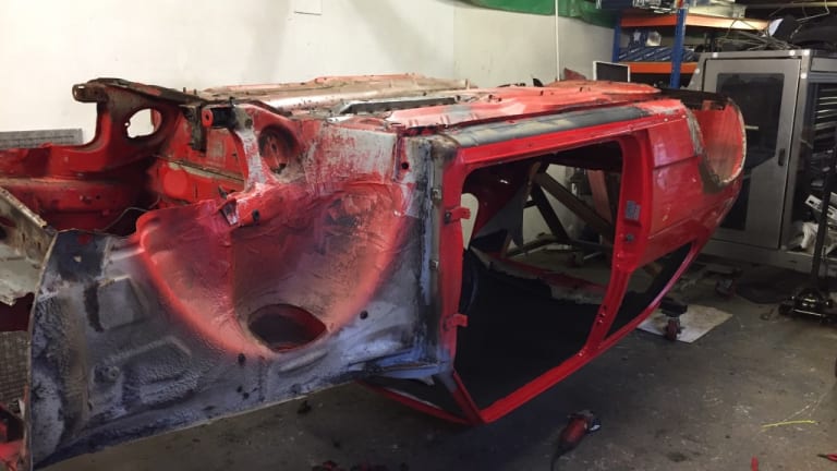

Now the engine was out the car I started to poke around and decided to pull the rest and refurbish the body.
I've taken the decision not to make it a show winner but just a nice useble car that will look presentable and will last at least another 40 years.

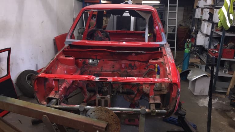

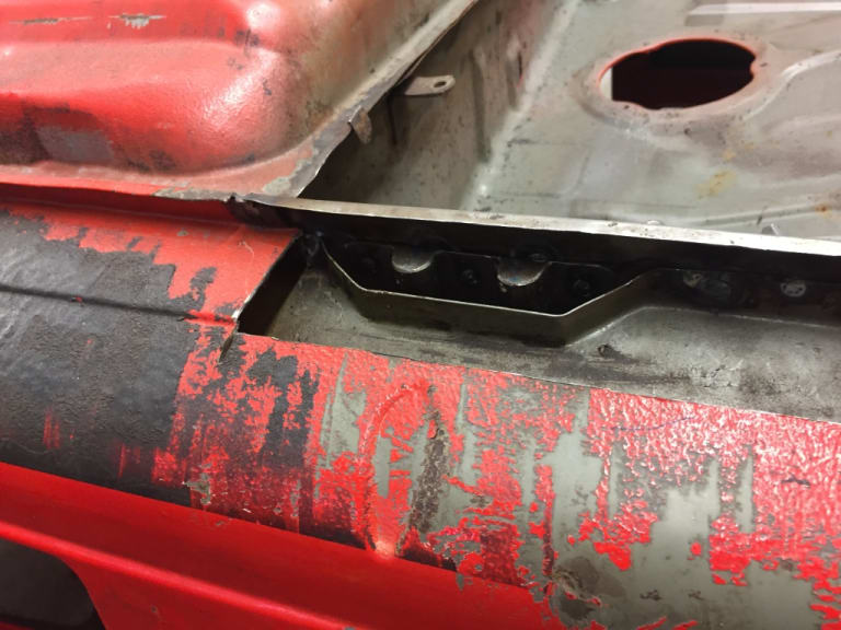

I knew it had some body issues when I got it but they suddenly become a lot worse once I got into it.

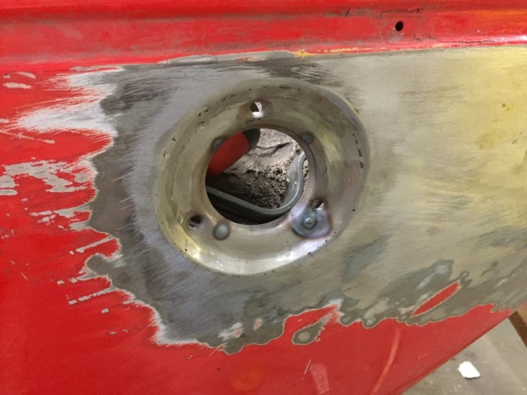

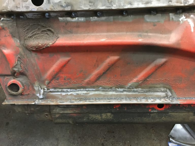

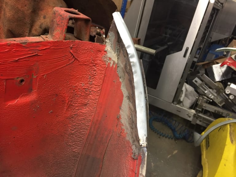

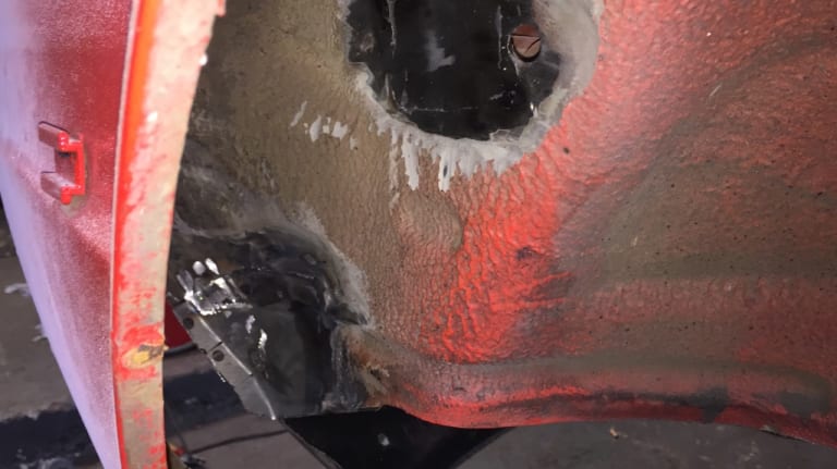

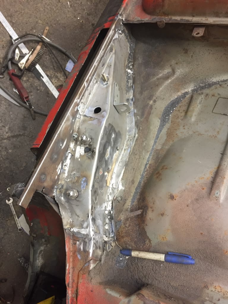

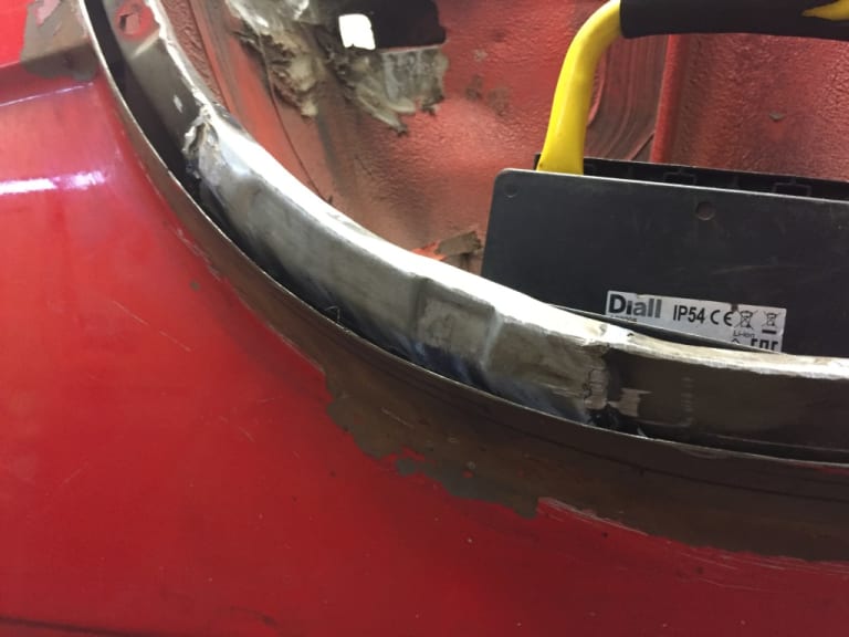

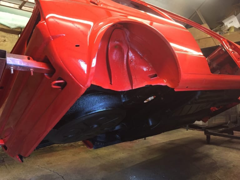

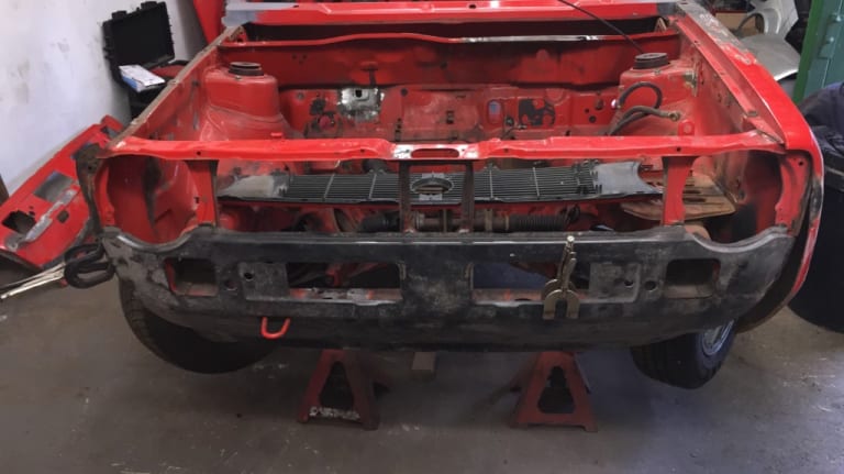

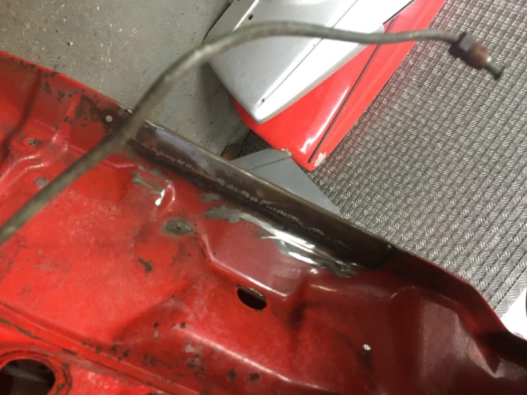

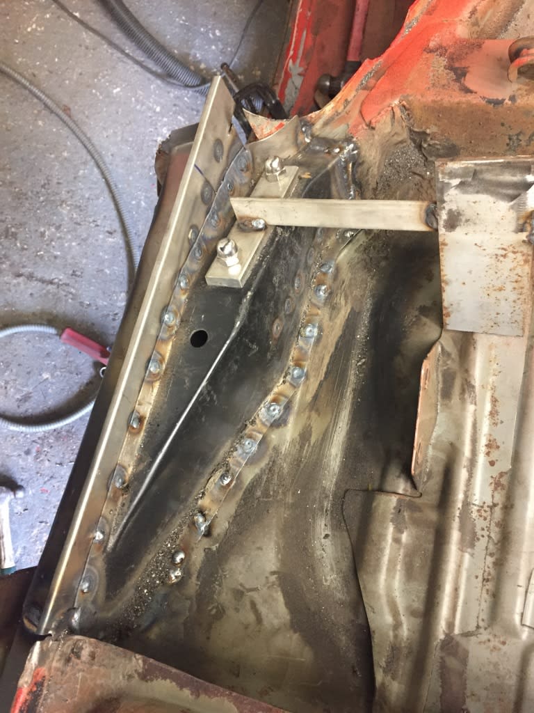

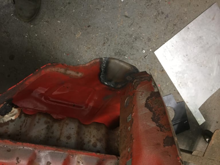

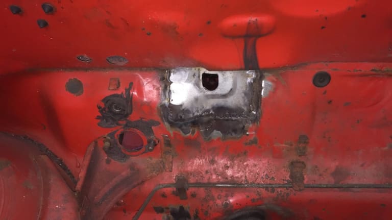

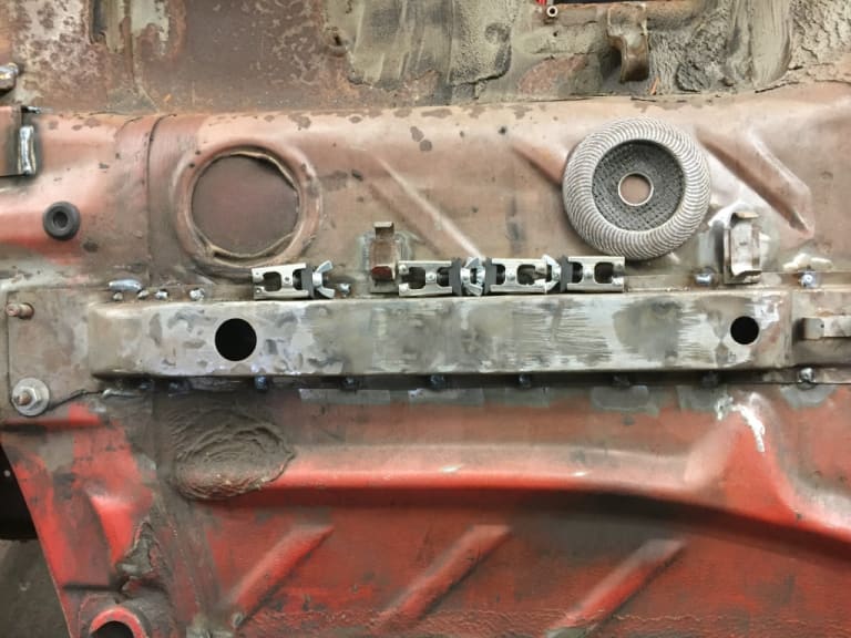

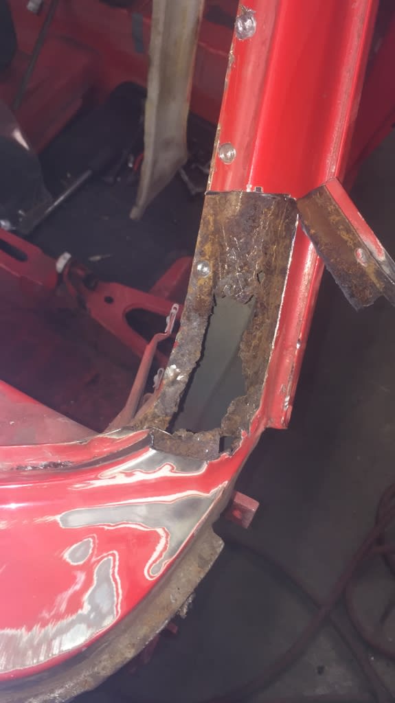

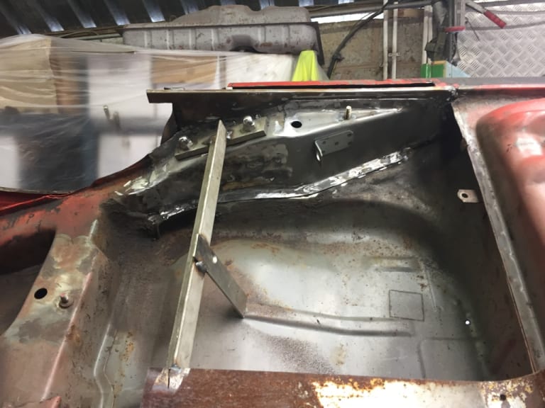

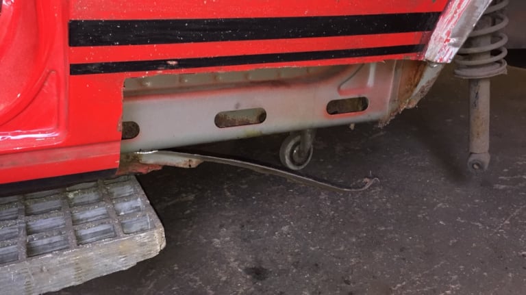

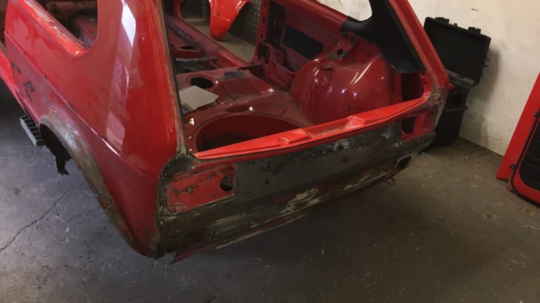

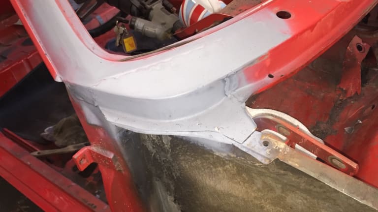

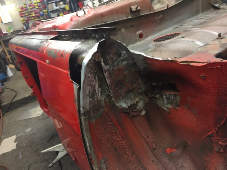

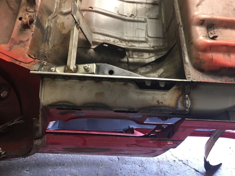

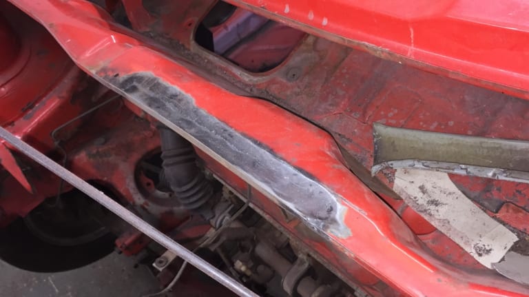

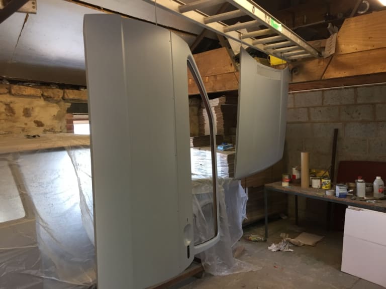

I've ended up spending 150 hours welding it up and this includes both sills, rear axle mounts, rear lower valance, rear arches, spare wheel well, fuel filler neck, front a pillars, lower front panel, n/s floor pan and straightened the floor runners, repaired the original wings where someone had filled the aerial hole with fibre glass and sourced some rot free doors.

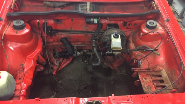

Some pictures…….
The old iceberg issue that 90% of the rust is hidden and only shows up when up you start to fix up the odd little bit that you can see.
Should be good for another 40 years use when you've done.
didnt seem that bad.

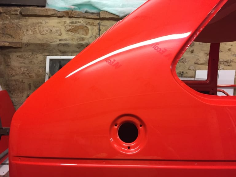

Totally disagreestichill99 said

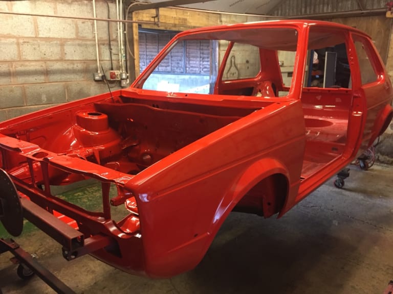

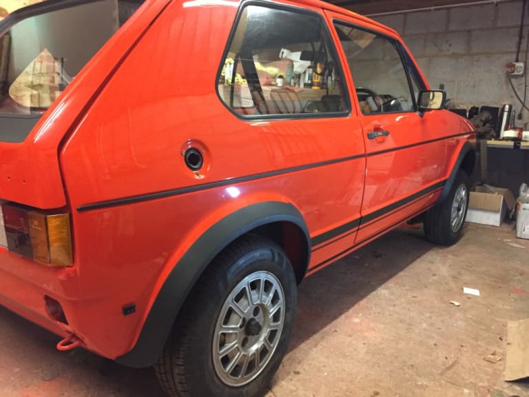

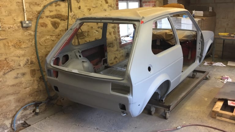

Fantastic work! Paint looks spot on!
There is a spec of dust in the spare wheel well. Haha. Will be a lovely car for sure. I’m jealous and it’s just a shell.
Given the paint a compounding for now.

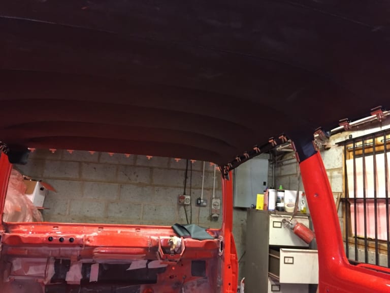

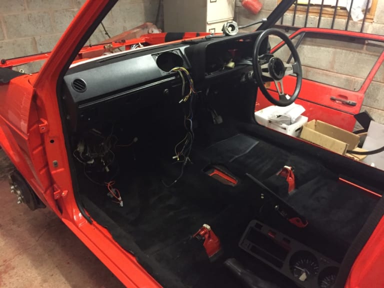

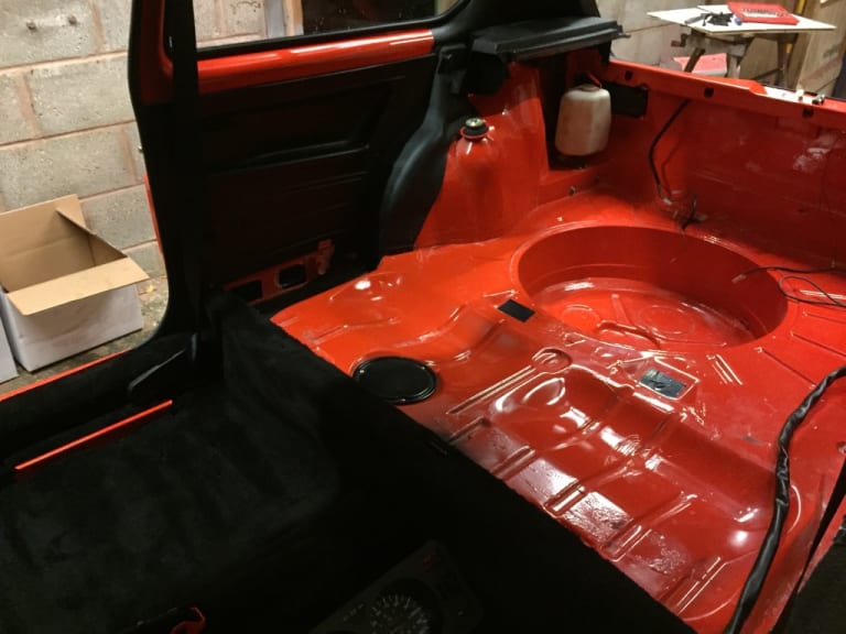

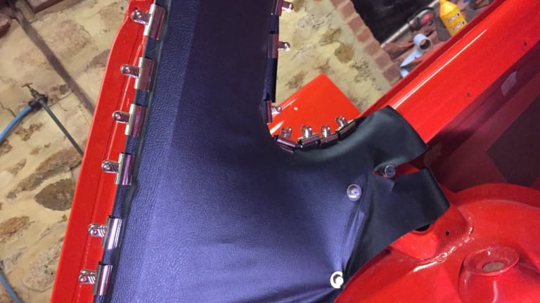

Now to start the build. First job is to get the dreaded roof lining in. I'll leave it on the clips for now to let it settle. Need to get the looms in and the tailgate on before it becomes permanently fixed. I hate this bit of the job! Makes a change from seeing red though!

Nice work! Are those the original arch trims?
No. The originals were tatty and I refuse to spend £500 on a set of original S1 trims even if I could find a set!
