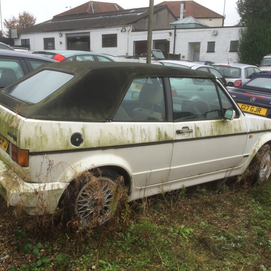

Well she is finally home and started to wipe it down.  Spotted few problems already.
Mainly the electric  roof won't go down but seems switch is broken but can't here relay clicking (unless doing it wrong) but gonna try manually.
Well few pics will keep updating this

Without the dirt imperfections are showing lol only a couple of touch paint spots the previous owner has done but it's a old car lol
Where did you find that? It was very green, I would of been tempted to leave how you found it just to be different :-)

Basically found it in a field of cars limit rust in filler neck tank was empty had new dizzy bushes Amadeus suspension put on between it off road and me buying it yea will do alternater belt as well.  Oil does look fresh and filter looks new but will replace and yea looked at coolant its pure water lmao
