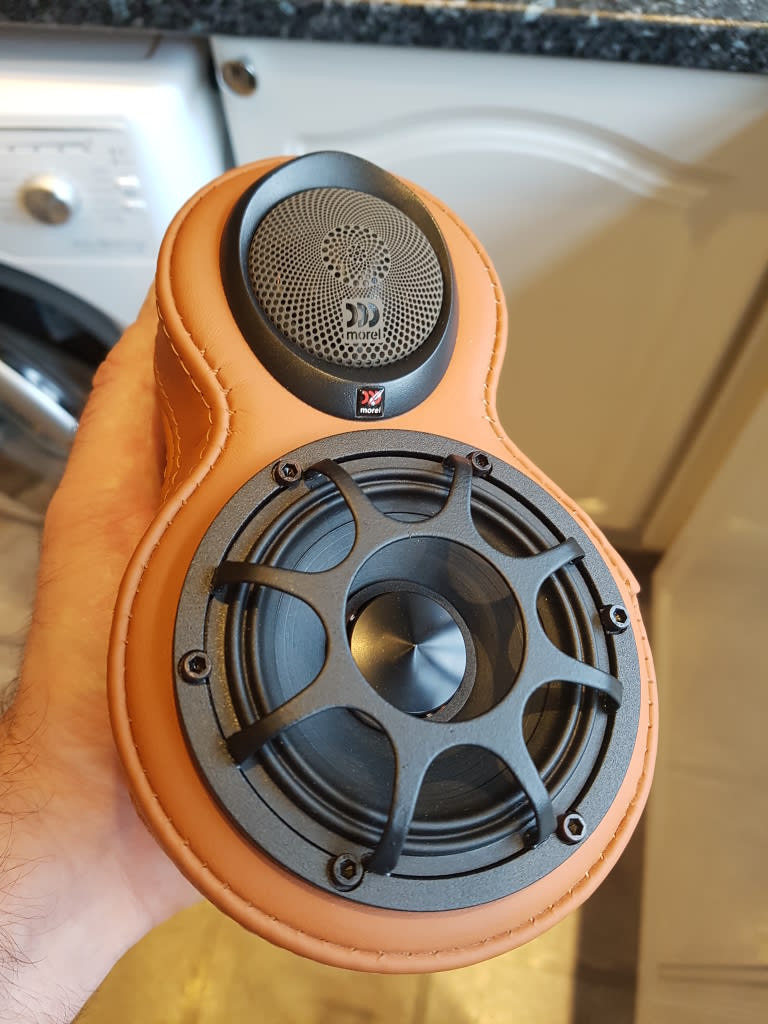

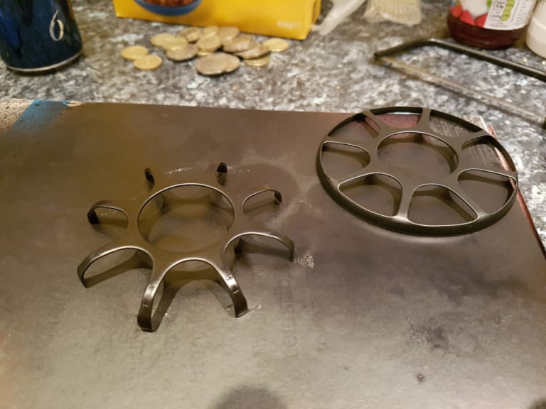

Ok, a quick update for anyone interested.. My last post was following the upgrade of the 6" speaker pods to 8".. As with most upgrades, they highlight limitations or weakness in other areas and as such I decided to also upgrade the mid range drivers and tweeters. I went for the Rainbow Profi 3.5" mid and the Morel Mt250 tweeter. The problem I had with this is that the Grille for the Rainbow driver is designed to help you fit it flush into a door panel. So I had to either leave the speaker without a grille or make one. So I chose to make one from the Morel mids that I replaced. It took some delicate fabrication but I think it looks great. Here are a few pics of that transformation..

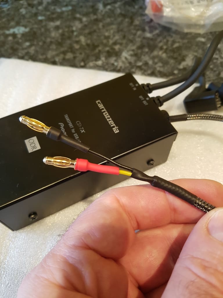

Following this upgrade, I decided to go the whole hog and buy the Pioneer ODR Ipod interface so that I could play wav files from a memory stick rather than keep changing cd's all the time. As the name suggests, the ODR (Optical Digital Reference) system connects via an optical cable to prevent loss of information at the pre amplification stage. So I bought the unit, optical cable and Ipbus cable so that the head unit can talk to the media interface and show what is playing.

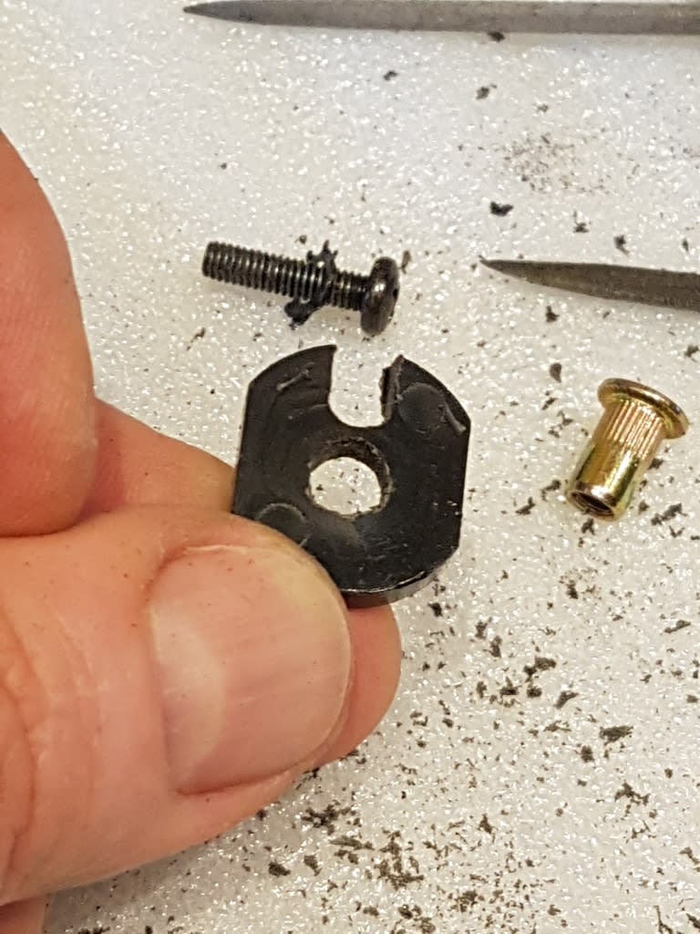

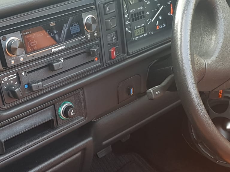

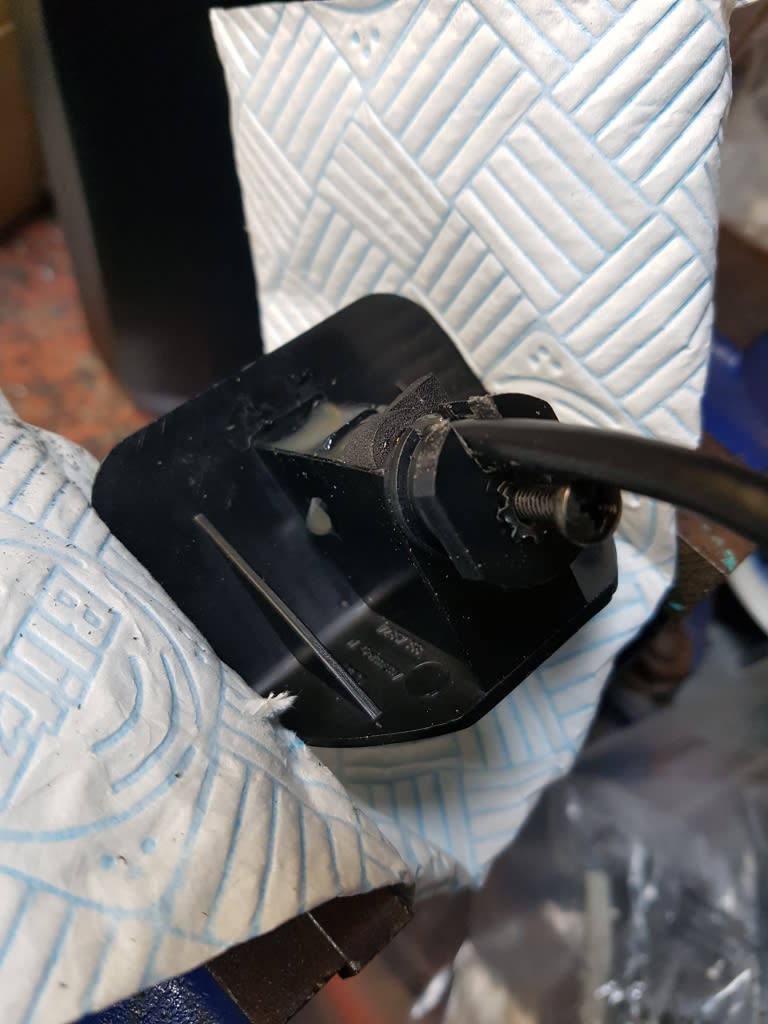

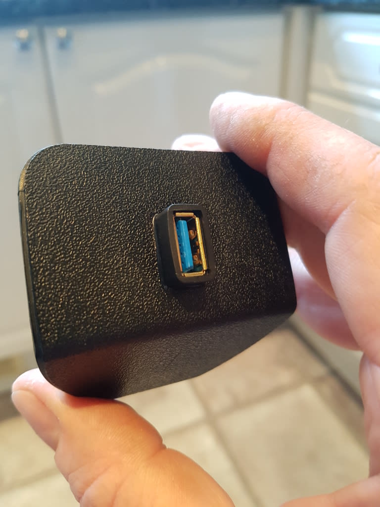

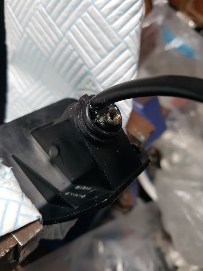

Hiding the ipod/media interface wasn't an issue, but having access to the memory stick would be. So I decided that I would use a good quality USB cable and fit it in a suitable blank in the dash. The obvious one for me was where the choke would have fitted had it had a manual choke. The blank seemed like a suitable size and in perfect position but when I removed it I realised that it wouldn't be as simple as just making a hole and fitting the cable through. My initial brief was not to damage the car in any way, so once I saw that there was only a small hole in the dash where the blank was held in place from behind by a screw, I almost gave up.. But.. With a fresh set of eyes the following day, this is what I managed to do.. I bought a second hand blank off ebay and modified it as per the following pics.. 20170228_103618.jpg 20170228_103656.jpg 20170228_104816.jpg
The result from the dash view is as follows.. 20170228_104557.jpg 20170301_152633.jpg

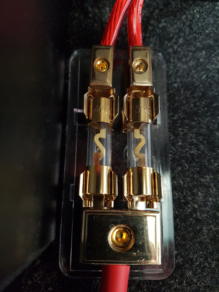

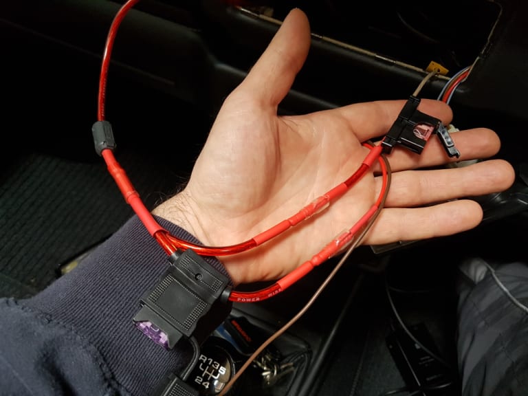

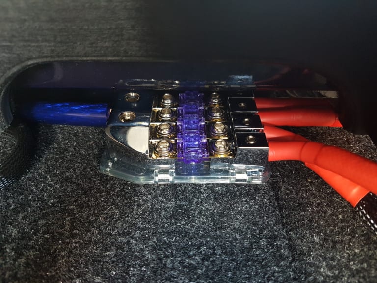

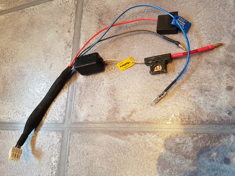

Following the speaker upgrades and USB upgrade to be able to play wav files, I decided that I would go through the whole system and rewire it all to ensure that everything was fused to competition standard. This in itself took three or four days, but it was worth it. Every time you change down the rating of the positive feed, you must fuse down accordingly at that point. So here are a few pics of what I added / tidied up along that way. 20170302_150812.jpg 20170303_112049.jpg 20170308_113810.jpg 20170427_175254.jpg 20170428_103146.jpg
