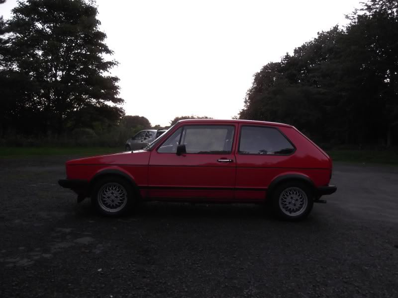

Here she is bless her!!

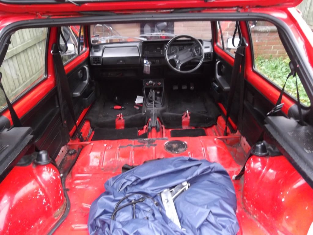

Made a start on the strip down today, I've got until the end of Jan before she goes away for restoration but thought I'd start early.
I've left the front carpets in for now as I'm still driving her until Wednesday.

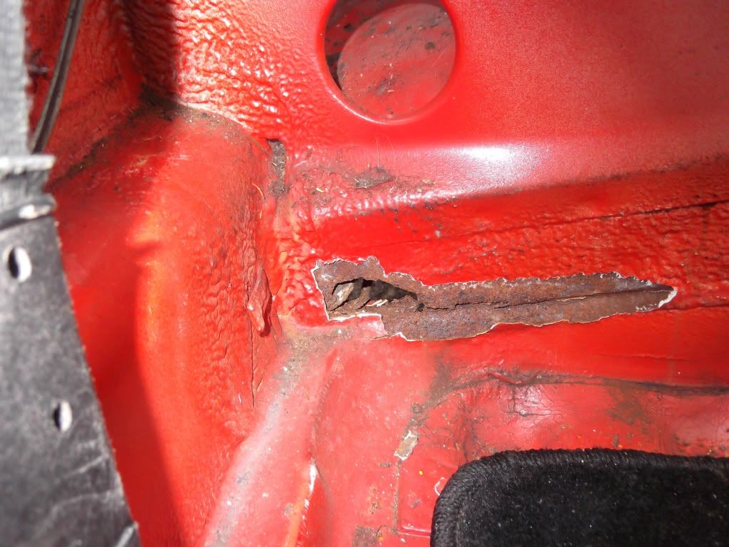

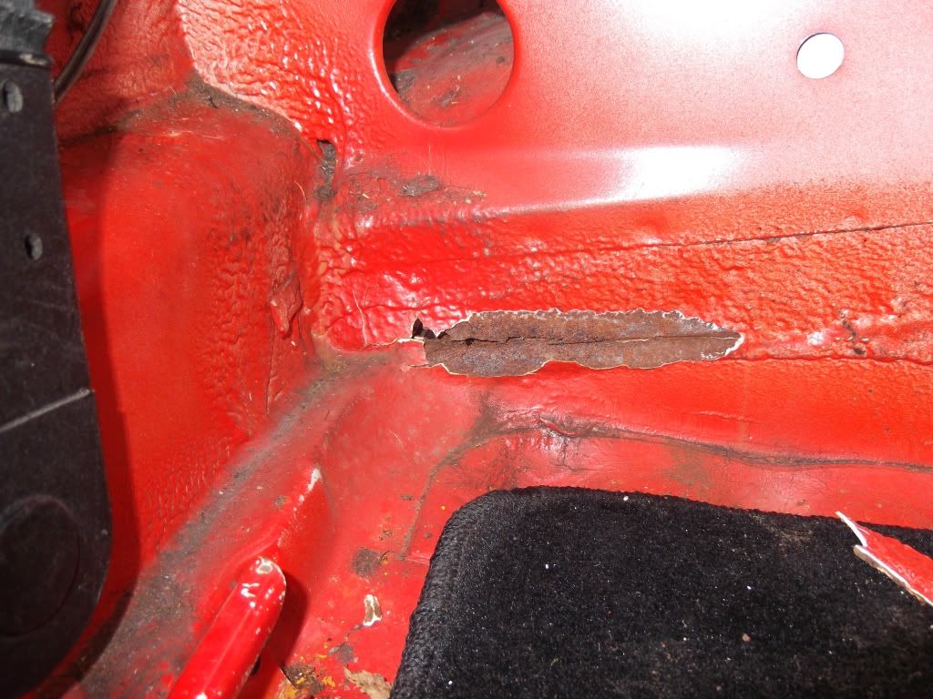

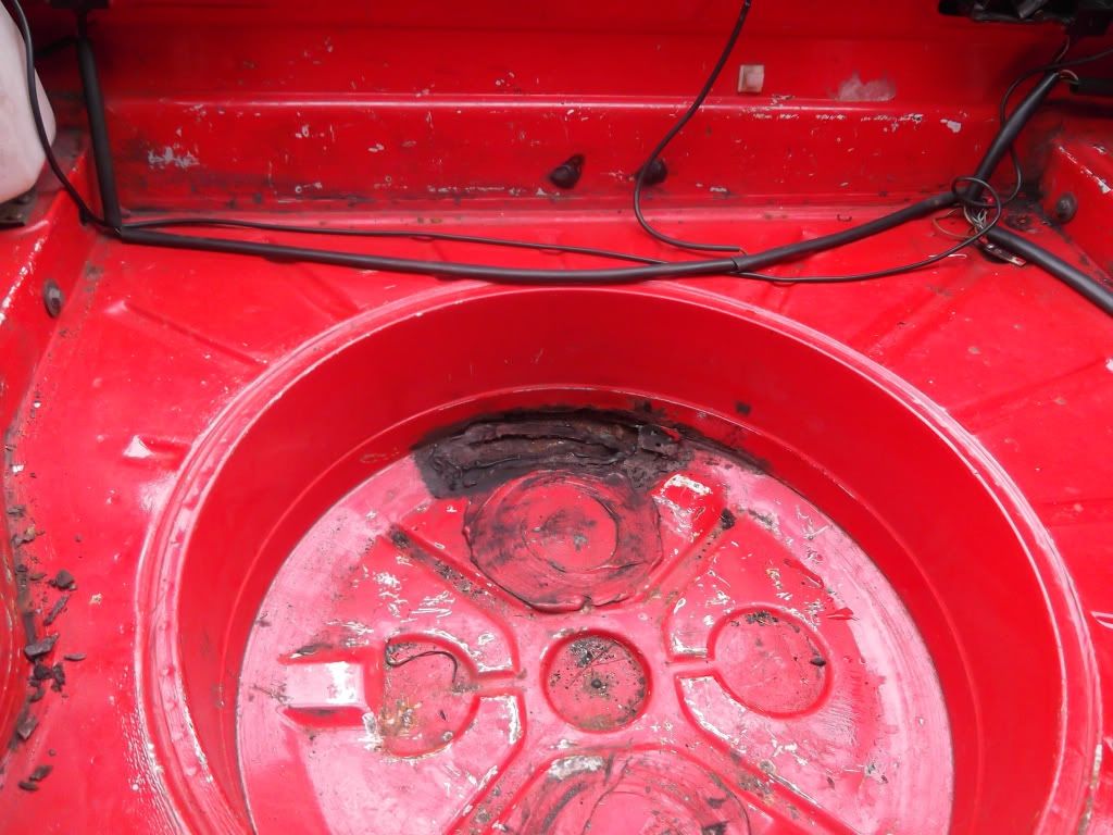

Spare wheel well repair needed

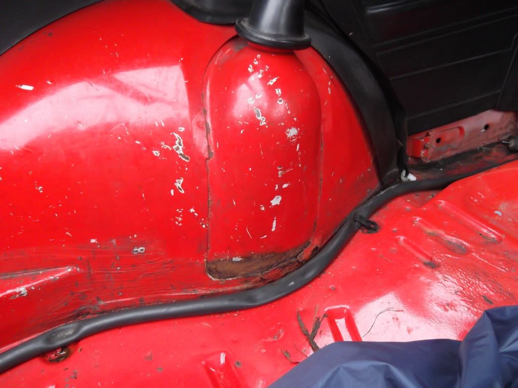

Passenger side turret at the bottom not looking too clever

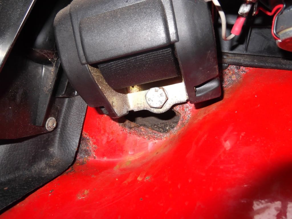

drivers side rear seat belt anchor point is goosed!!

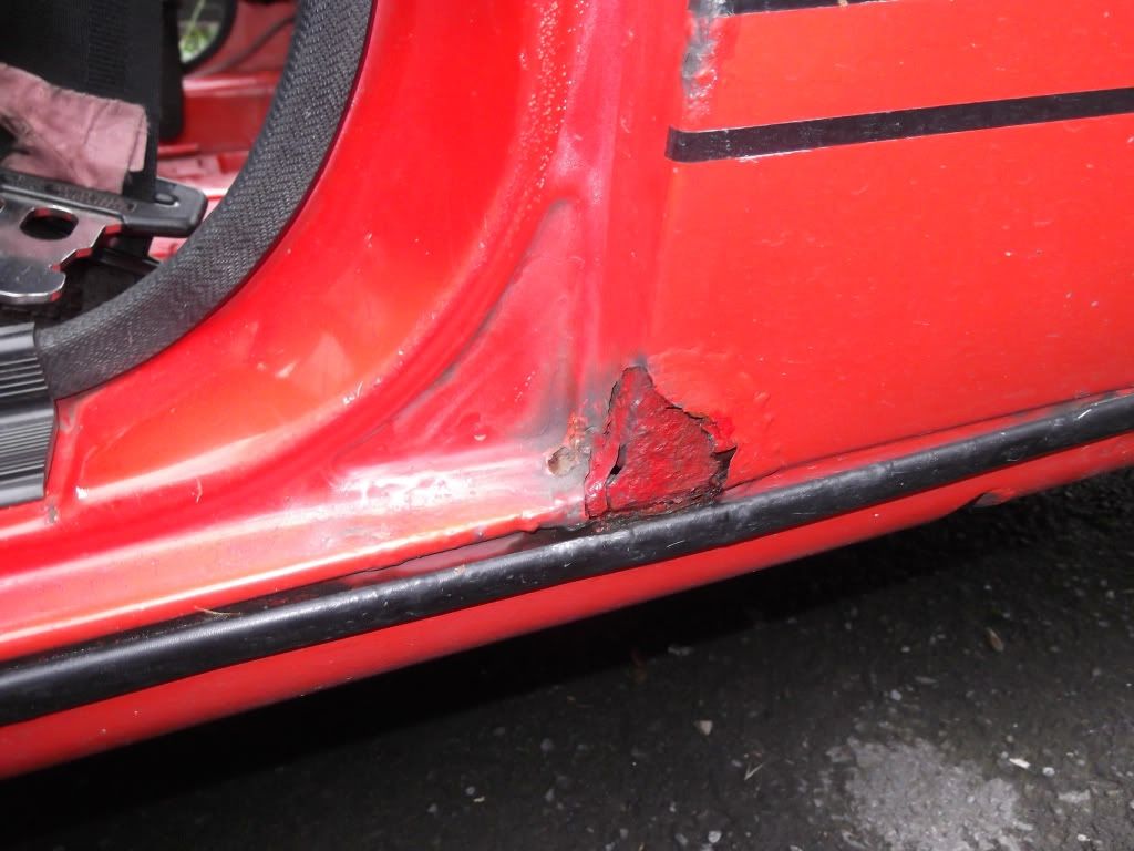

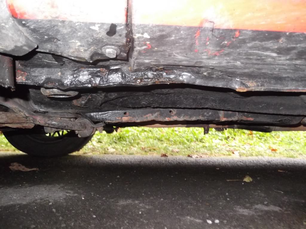

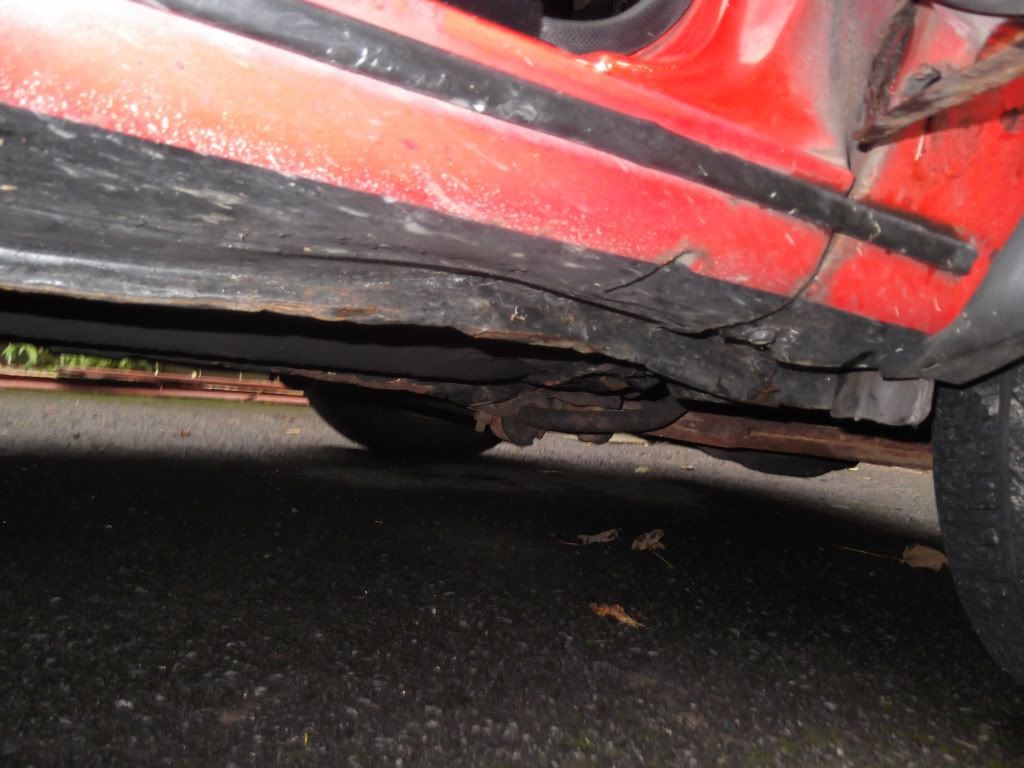

Sills are shot
Drivers side where the rear bench meets the floor
Pushed my finger through it here lol

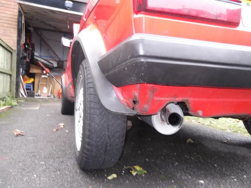

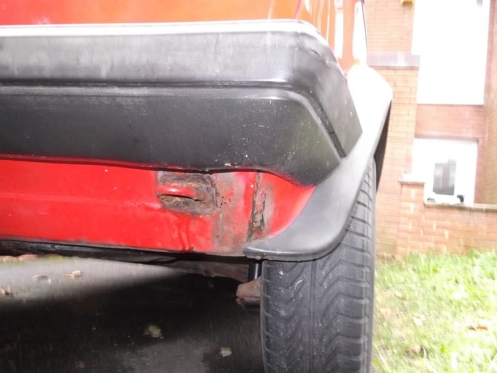

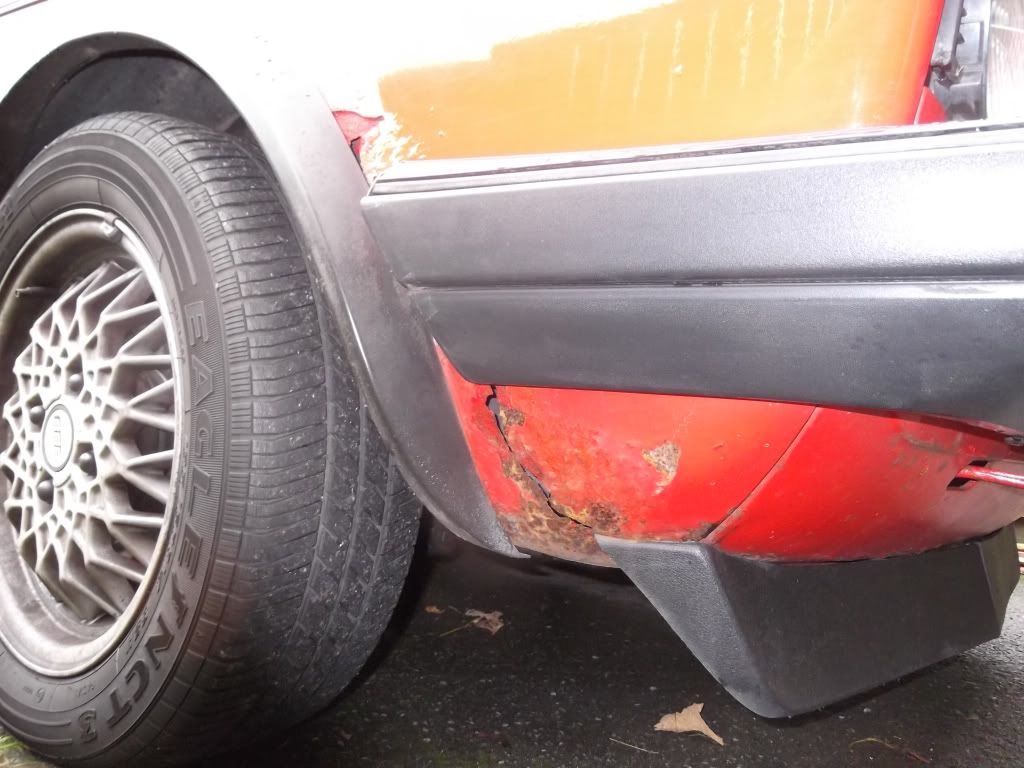

Rear panel and rear wing bottom both sides

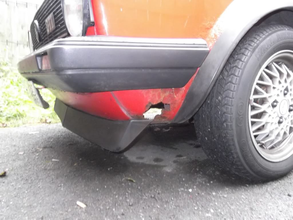

front panel and wings both sides

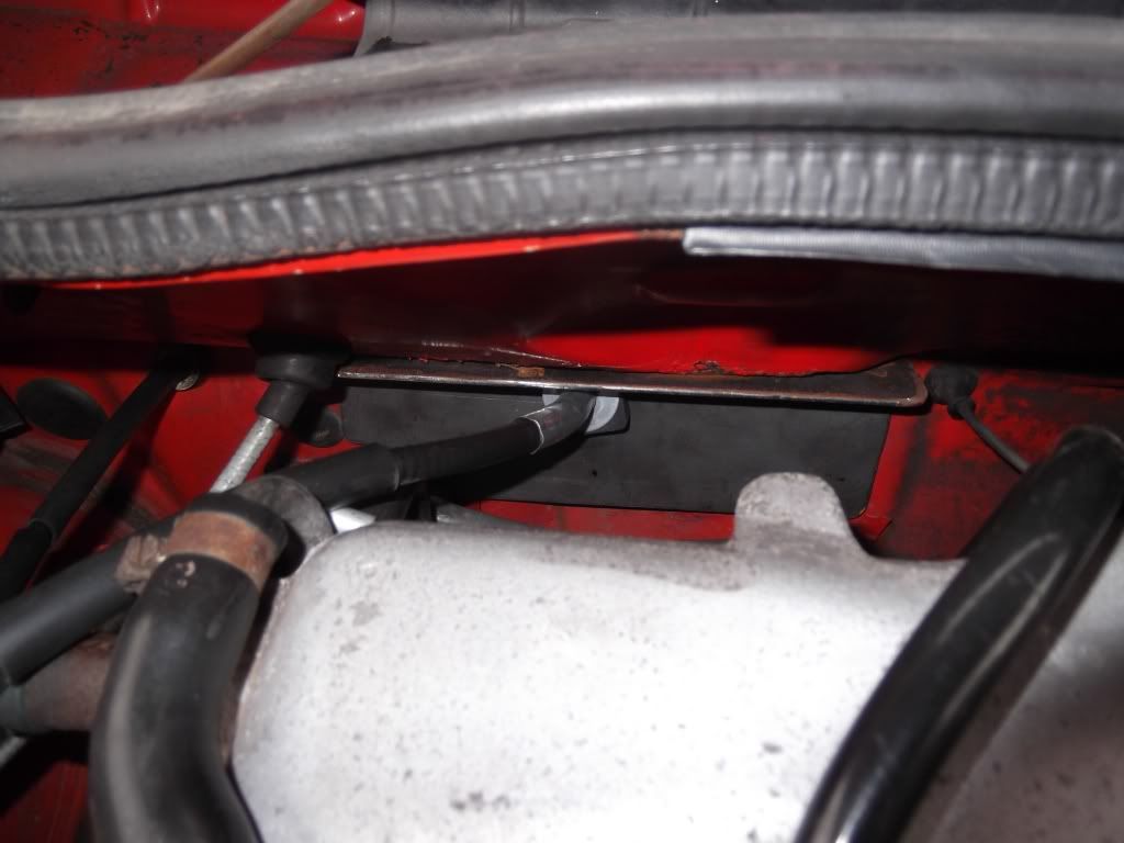

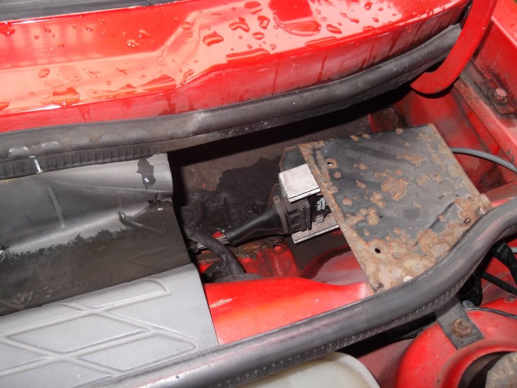

Skuttle panel is holding water on the fuse box side and letting water in to the cab, thinking of removing it altogether maybe?

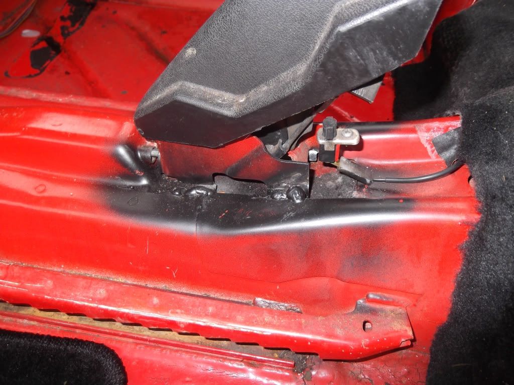

my bodge job of temporary bulkhead/clutch repair :redfaced:

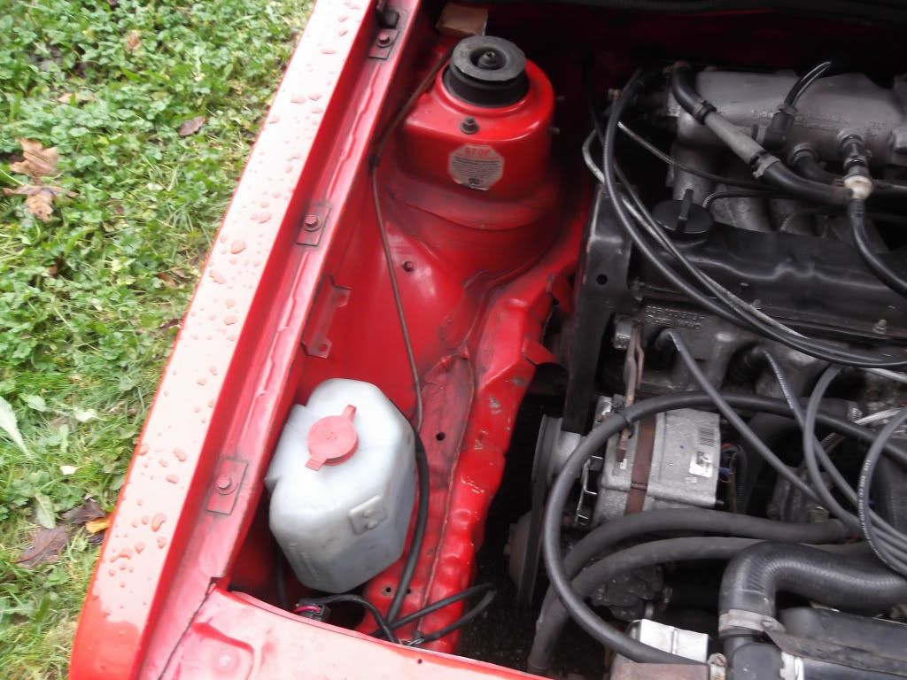

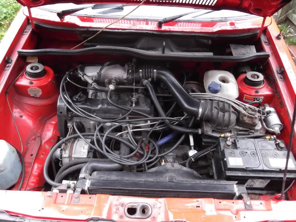

Engine bay isn't too bad tbh, both chassis legs are clean and inner wings don't look bad at all
