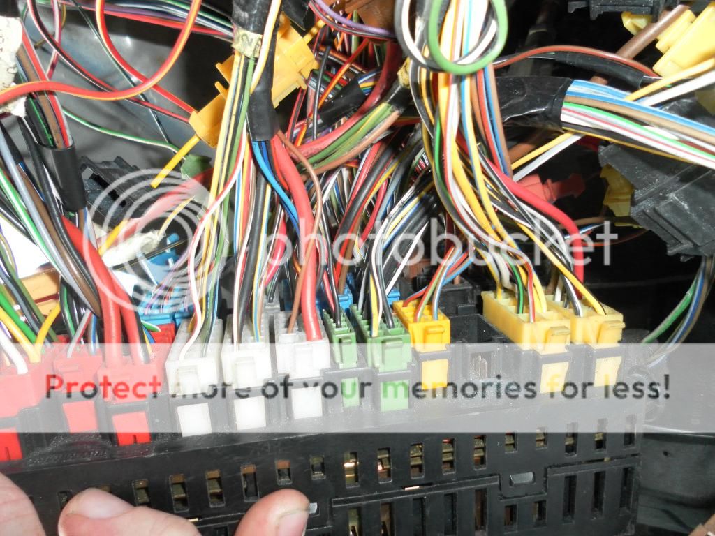

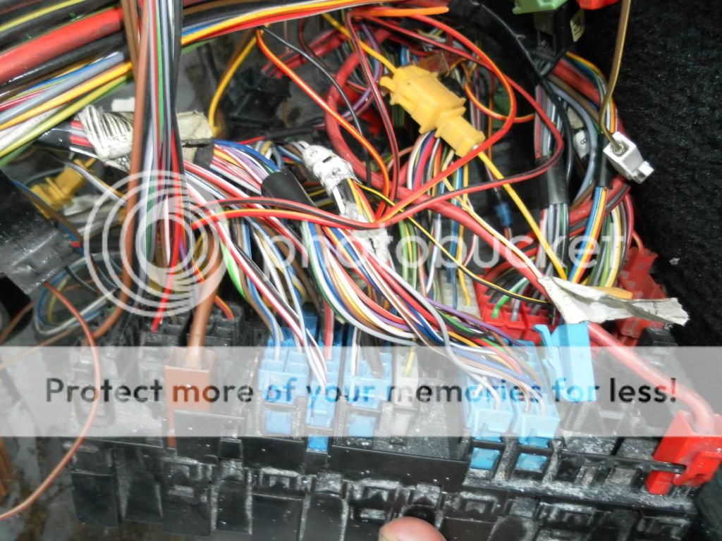

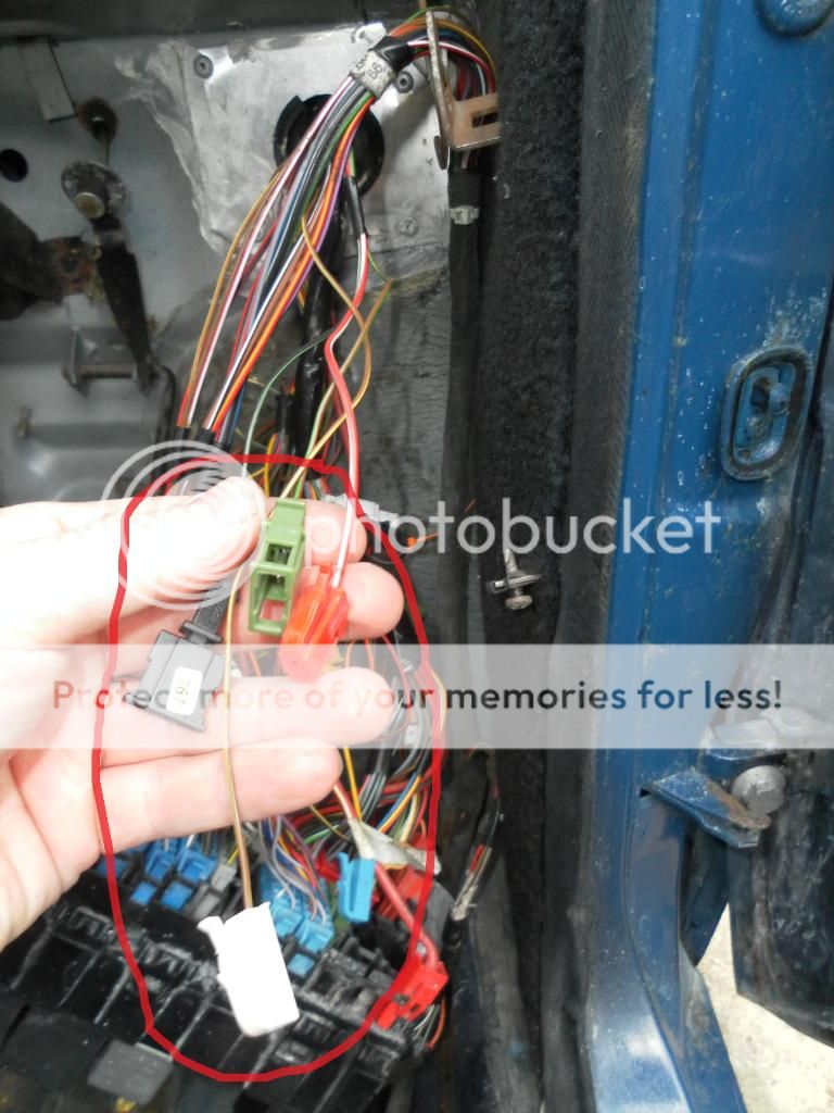

have a few pics here of the fusebox, hoping you could point me in the right direction and tell me what some of these are, feul pump related etc?
if you need better pics let me know!
Thanks!
MOTY 2013
fuel pump power goes to plug M, i can see its plugged in already. the red/white wire with red plug needs permanent live, it goes into socket Y or the big red jumper block between 30 and 30b. the other single wires leave off for now, the brown/white is probably the interior light though.
for more info:
http://www.clubgti.com/showthread.php?219775

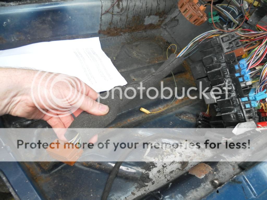

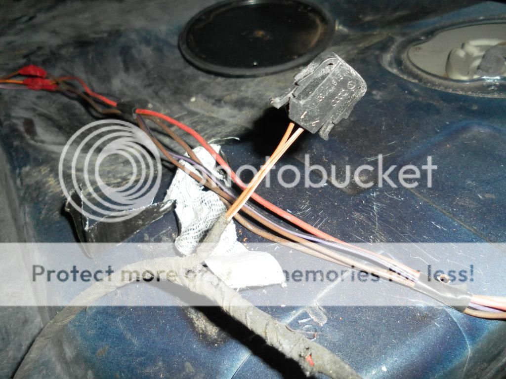

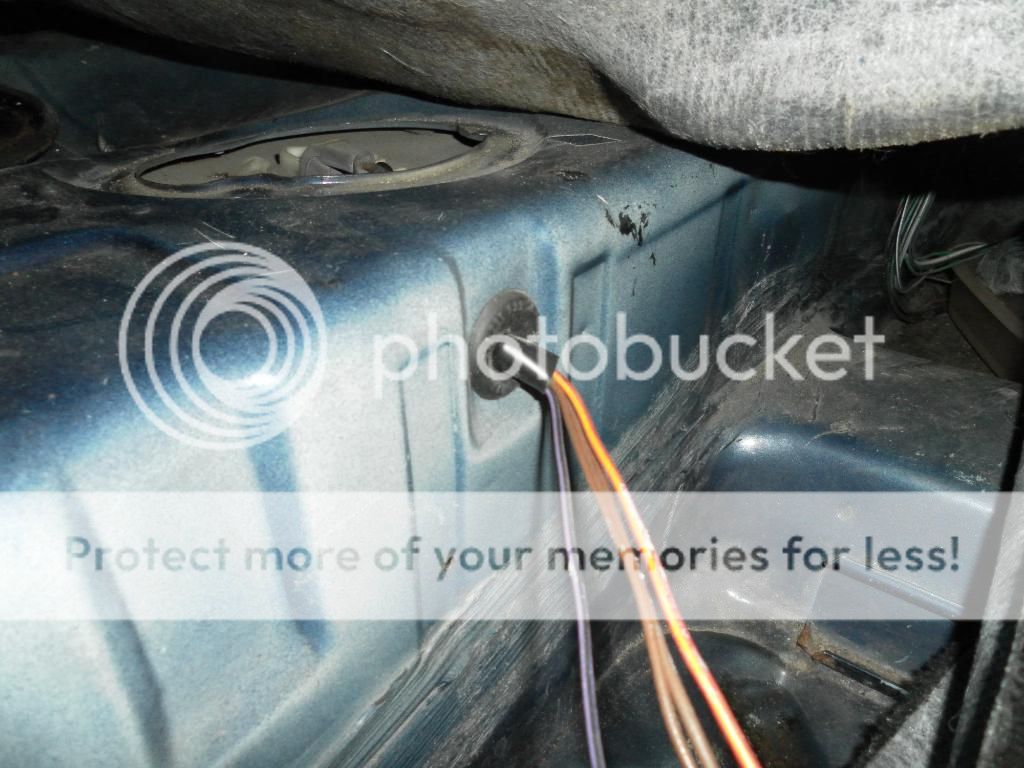

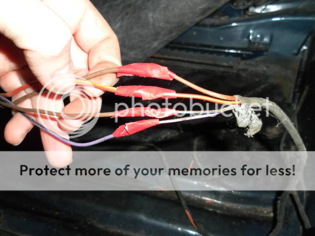

O.k, correct me if im wrong but if I connect the 4 wires coming from the fusebox (feul pump/tank wires M) directly to the 4 wires coming from the MK1 fuel tank/pump……shouldn't this just work?
See pics…
VR6 feul pump/tank connecter removed….
4 wires coming from MK1….
VR loom connected with Mk1 wires…..
O yes…and just curious what is this little plug running of the same loom but seperately if you know what i mean?….
MOTY 2013
2nd plug not 100%, its nothign to do with runnign of car anyway. if it was a 5 door id be tempted to say its for rear door pins?
