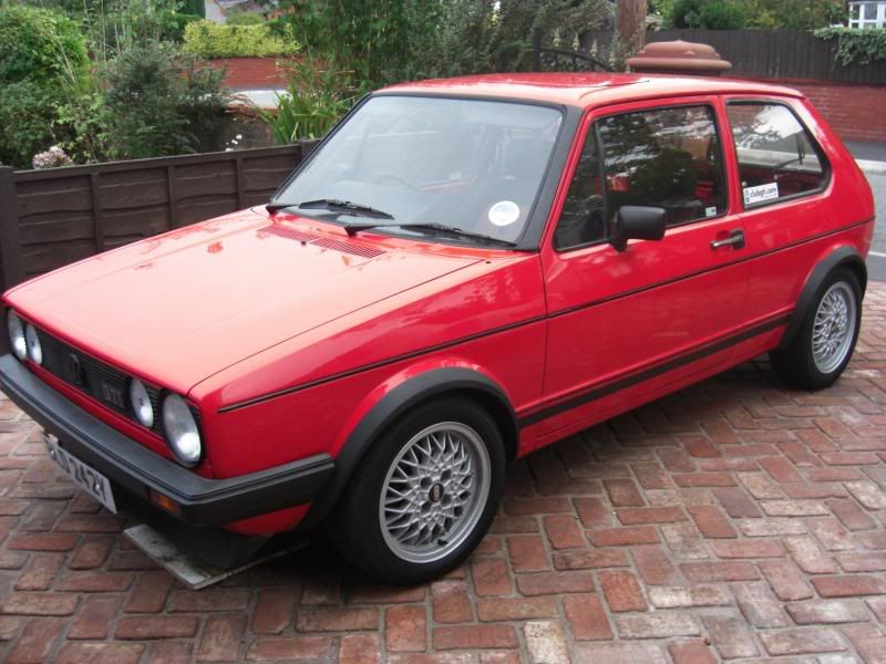

The 1.6 has been getting a bit long in the tooth, smoking when its floored then the water pump started leaving big puddles on the path i decided what the heck i would drop a 16v in….
Ive borrowed the Curby pics from other threads so big thanks to whoever took them [=D>]
New wheels, dont you love e-bay, not bad for ?77 [:y:] just needed a bit of a clean up and new tyres. The carbon fibre centre caps i already had…

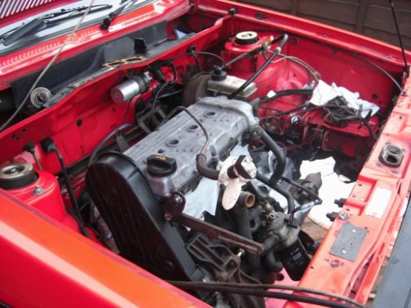

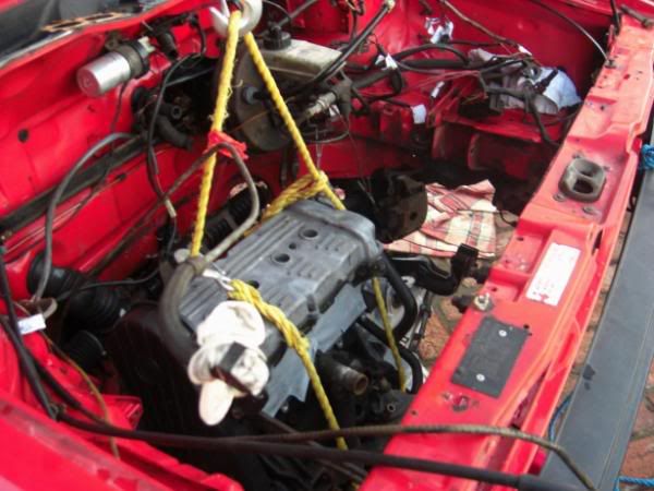

Went to start stripping the ancillaries off the engine and got a bit carried away…. this is probably how NOT to remove your engine, doubt you will see it done like this in any manuals, but ive not found an engine hoist yet and you know what its like once them spanners are out !

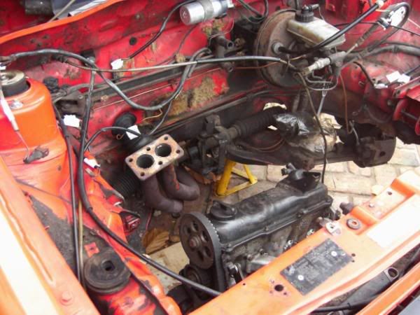

Whilst the engines out i can give the bay a good clean and replace some of the bits that are usually hard to get at, should keep me busy whist im waiting for an engine !

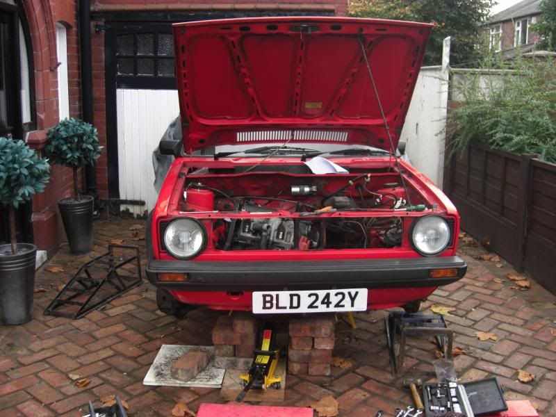

Engine bay as it was…
and following a bit of a clean up with a pressure washer, tar remover etc etc…

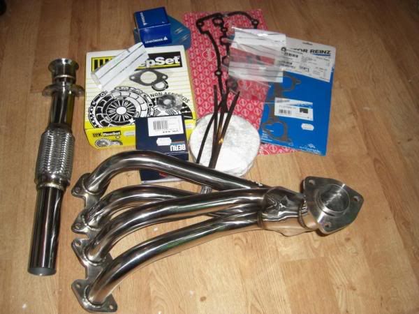

Some nice new bits ready to go in, new clutch, rocker cover gasket, gearbox seals manifold etc etc

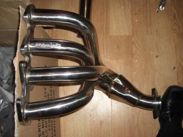

Nice shiney manifold, seems a shame to wrap it !

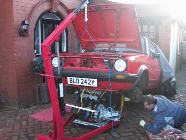

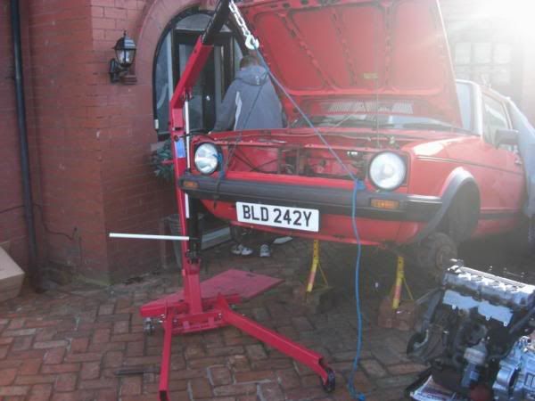

Decided to stick the engine in from from underneath, so lifted the front end of the car up with the hoist, supported it on axel stands on bricks (to get the height) then lowered the car… worked well.
Lifting the engine the last bit…

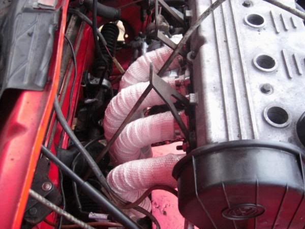

Manifold fitted
