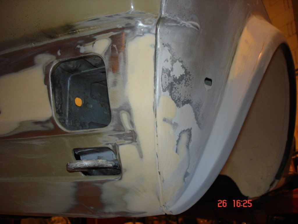

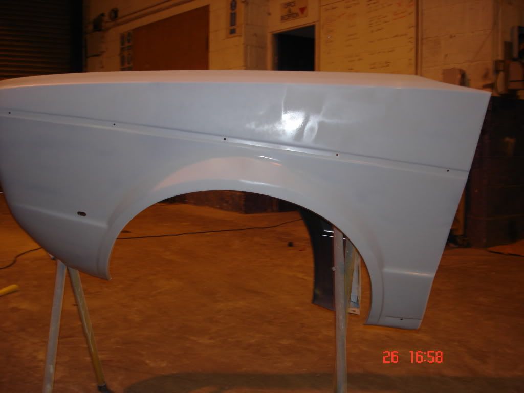

the rear end needed the rear panel finishing off and the joins between rear panel and rear quarter panels. this has now had a quick blast of etch primer just to seal the bare metal and also to see if there is any imperfections in any of the filler work.
the front wings had a few minor dings from been stored and been non genuine parts. so the dings were filled smoothed and then etch primed the wings.
hairyarse here is the rear corners as promised been shaped to standard as for cracking they should nt but will has some body sealer ran down them which should help.
passenger rear corner groove
rear panel with filler work (light skim over welds )
drivers side view of rear quarter and rear panel all etched
rear panel with etch primer
drivers wing etched

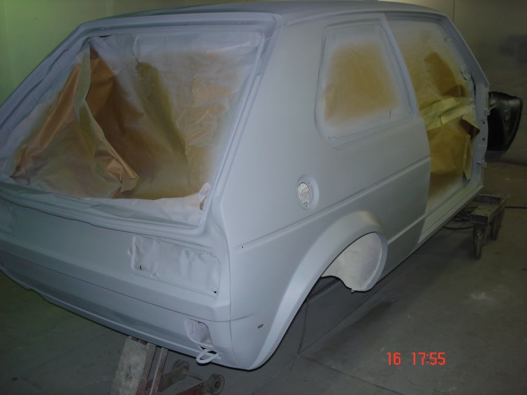

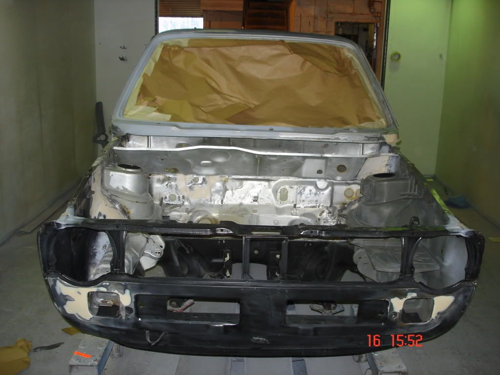

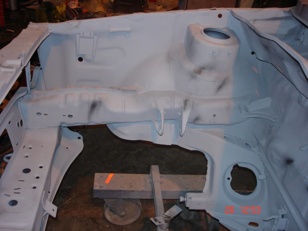

first had the make suure it was free from dust and rubbish from the body shop. then masked it all up which took for ever. etch primed the whole shell to make sure there was no bare metal showin i missed which was mostly the engine bay but i thought it would nt hurt for the whole shell.
then 3 coats of filler primer 2 pac then when satisfied i gave a light blast of black aerosol just as a guide coat for when it all gets flatted.
heres the pics sorry not so many battery in camera died.

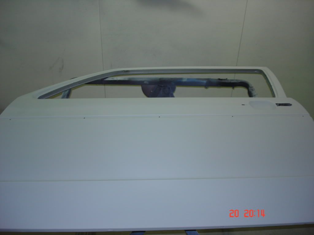

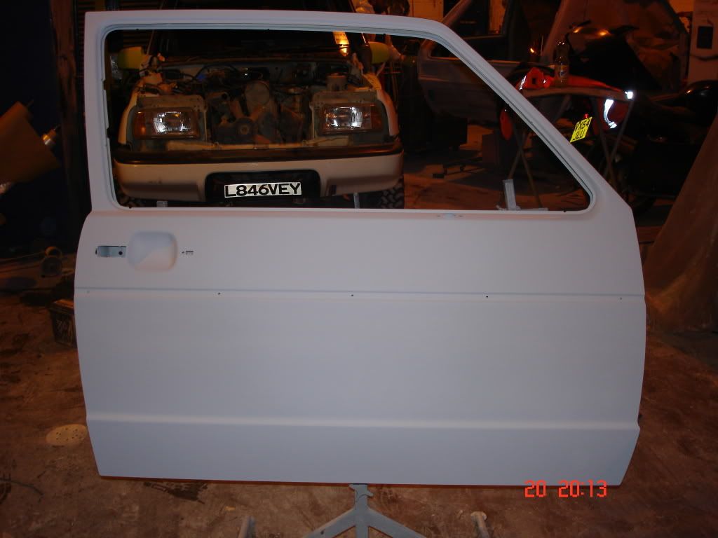

heres the latest update and some more pics of the primed shell. the shell i have started flatting today and also primed all the panels door etc etc
heres the pics
