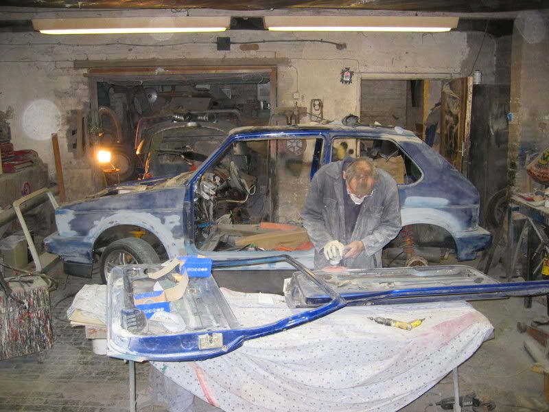

I then took the plunge and got her booked in for the bodywork with a local guy who had been highly reccommended :
Here he is checking out what he has let himself in for :

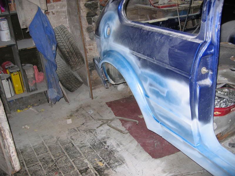

usual rear arch rot :

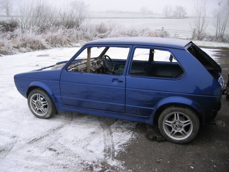

I had him lift the arch up about 10mm, as i wanted to put 8's on the rear without having to bugger about with ballache arch mods.
new sills :
bit of a jump to the primer stage, but got that many pics…lol

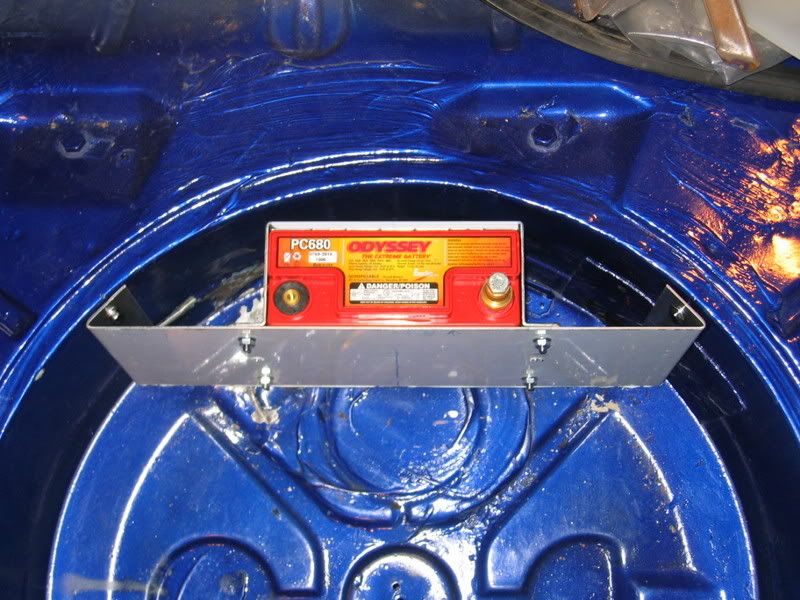

Got rid of the battery tray :

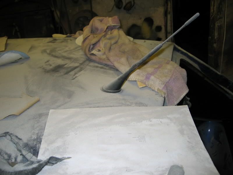

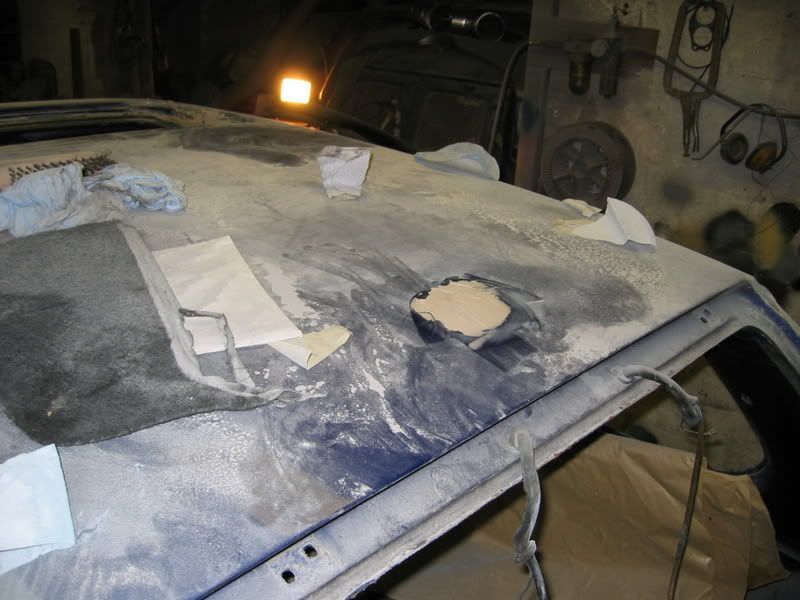

For some reason it had, had a bee sting ariel put on it, that had to go :

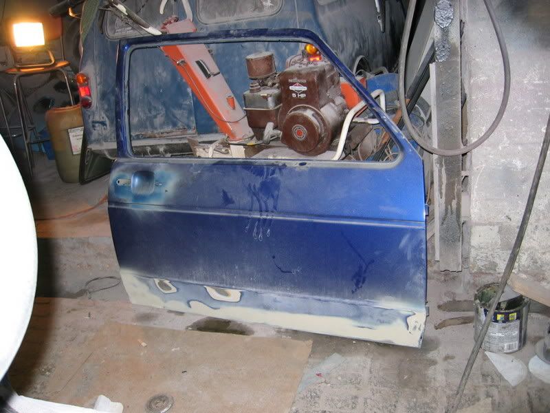

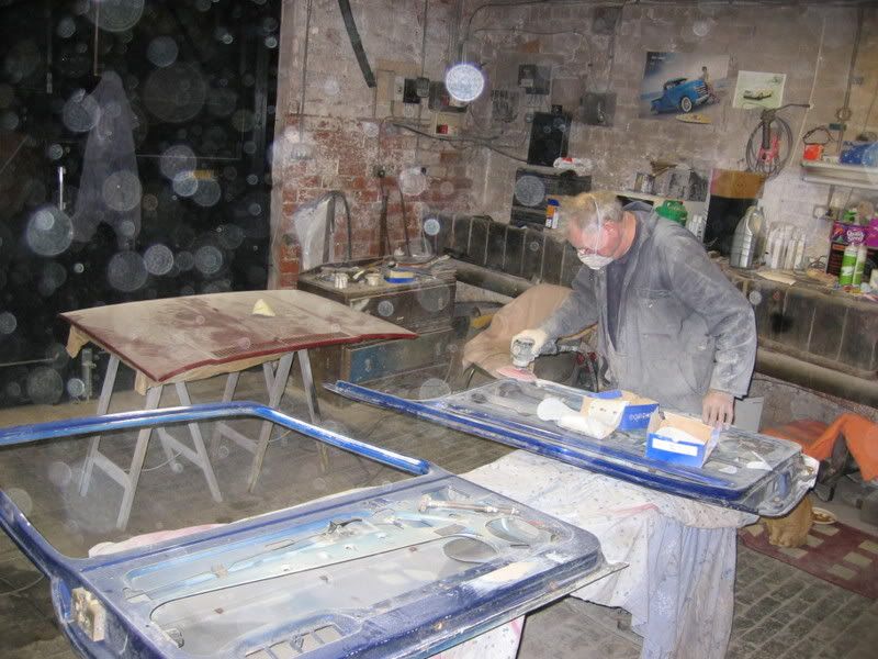

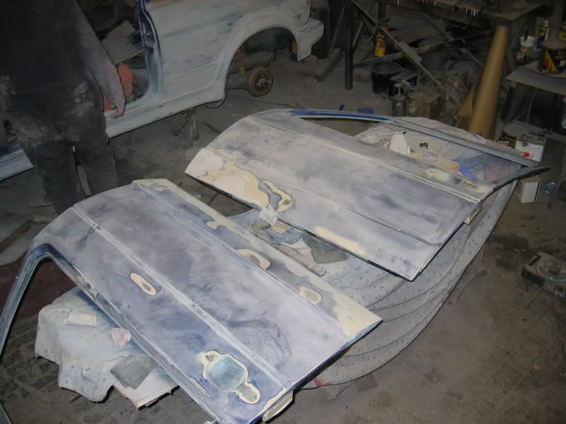

Doors off for bringing up to scratch, dont think had been touched for a while :

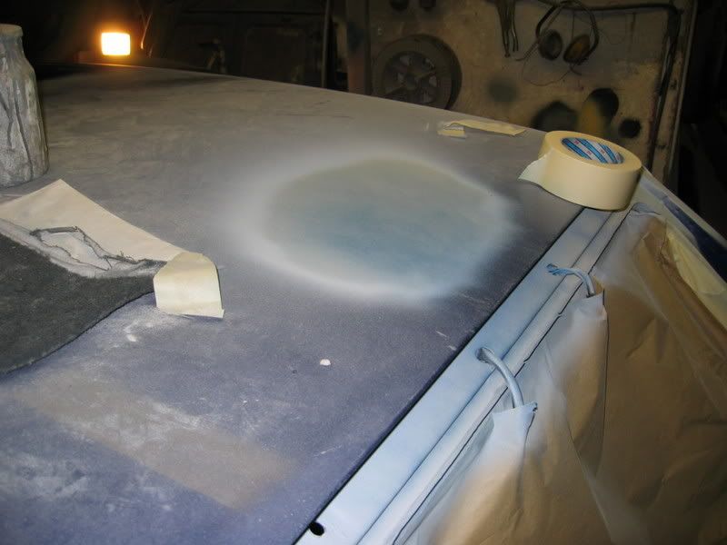

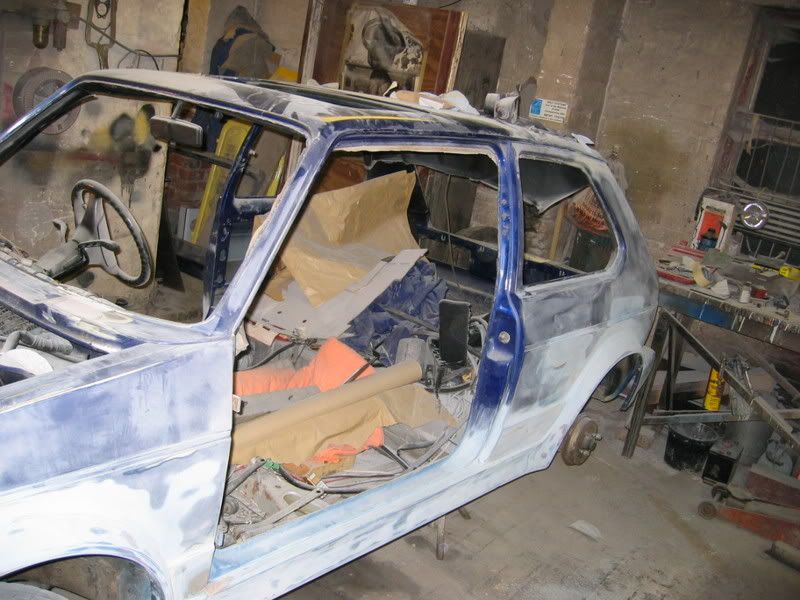

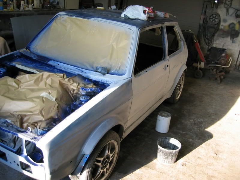

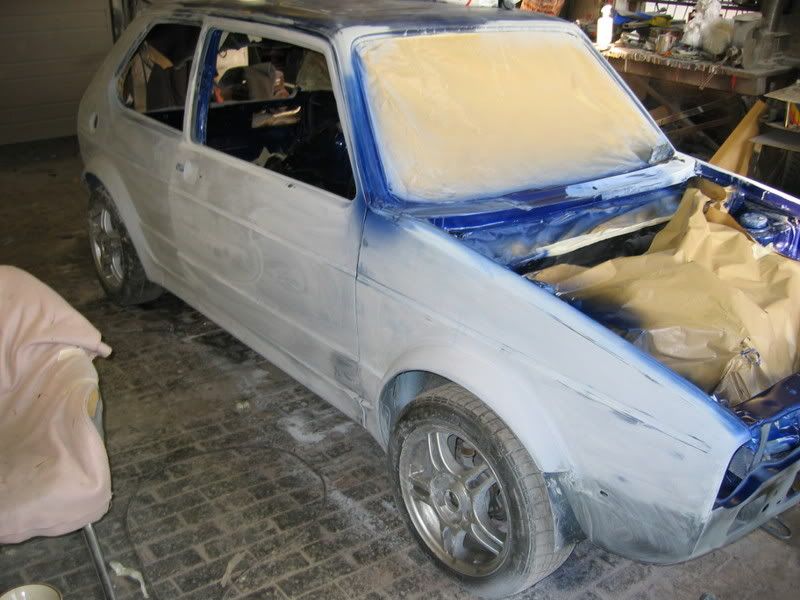

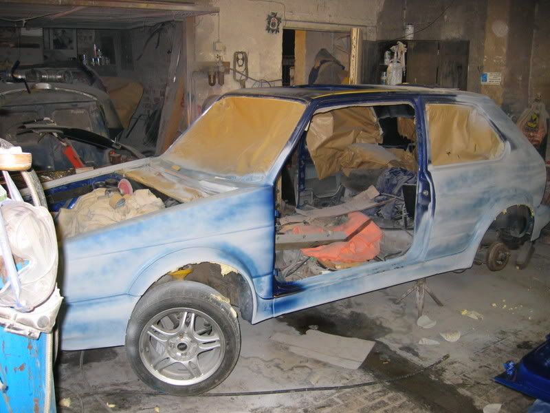

Primer stages :
Ariel hole :
Battery tray :

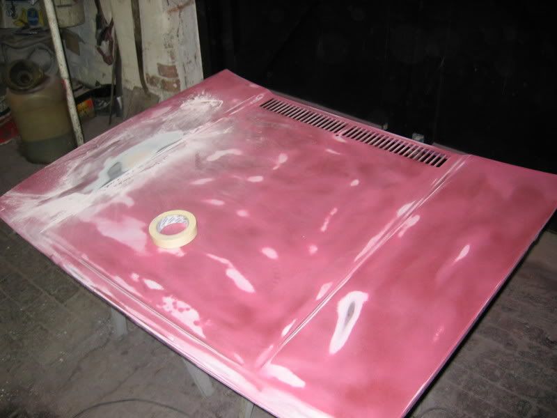

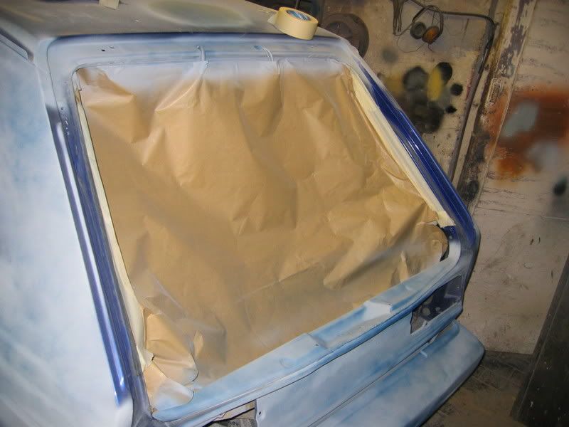

Bonnet prep :

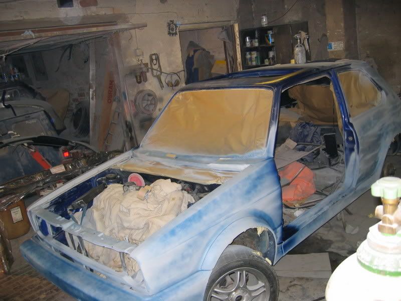

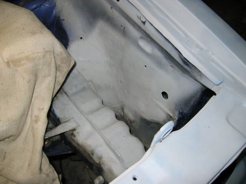

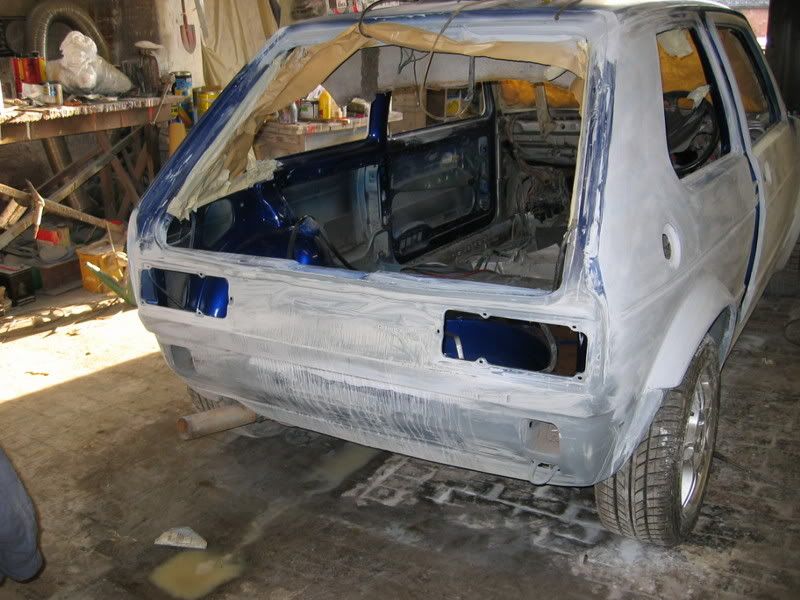

Body getting put in primer :

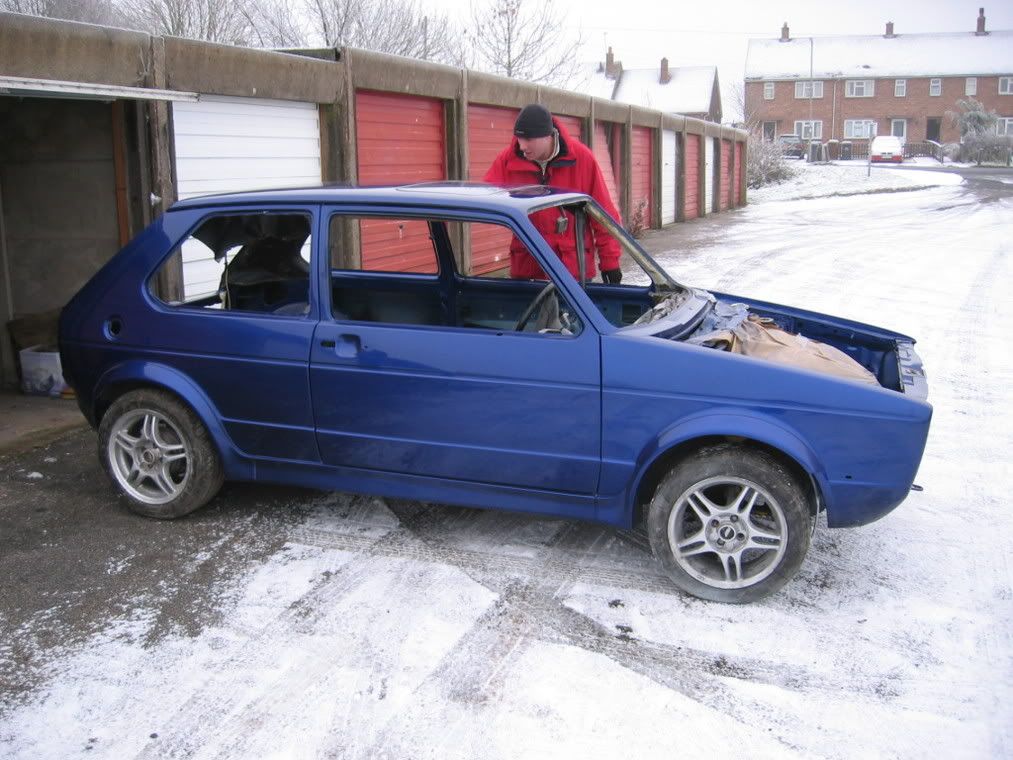

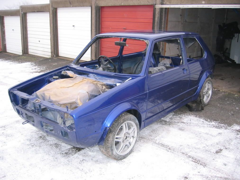

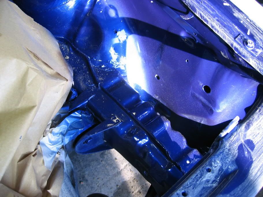

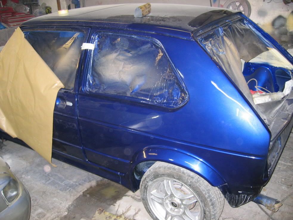

First glimpse of the new fresh paint :
The day i collected her back from the bodyshop :

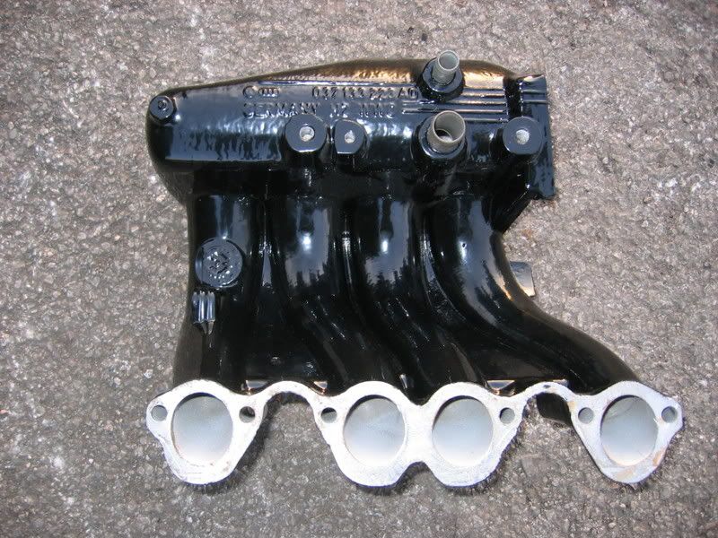

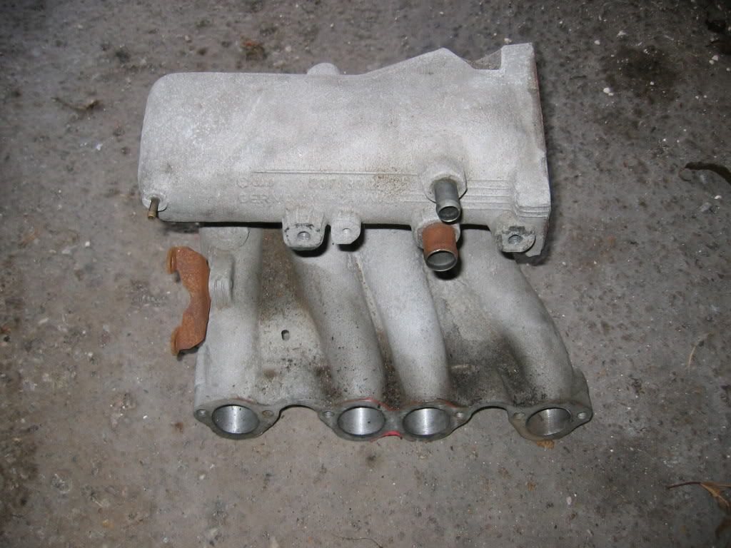

Old inlet manifold:
New powder coated inlet :

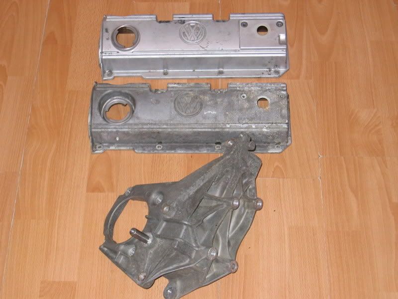

Old charger bracket ( and a few rocker covers:

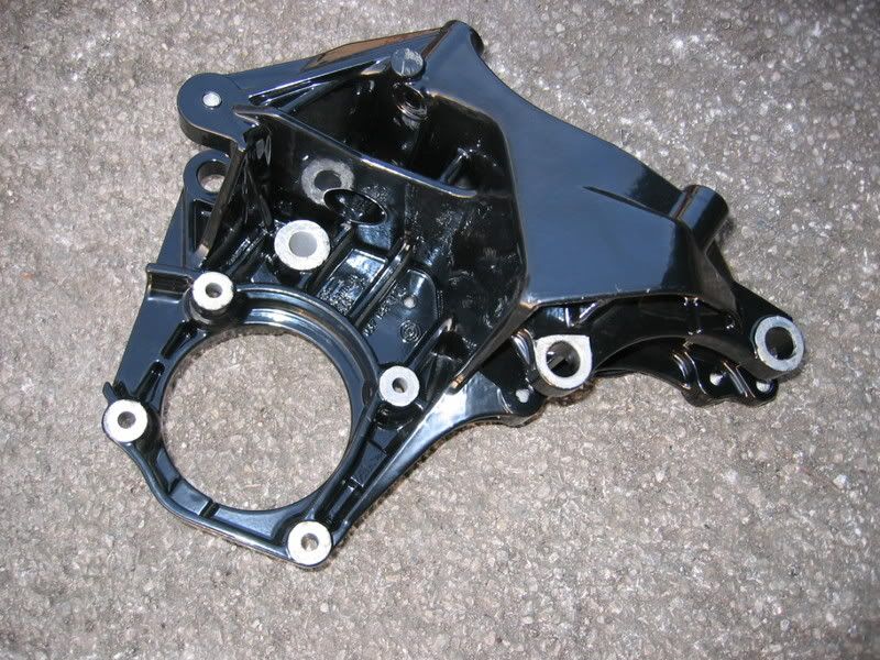

New charger bracket :

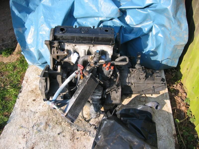

The old engine :

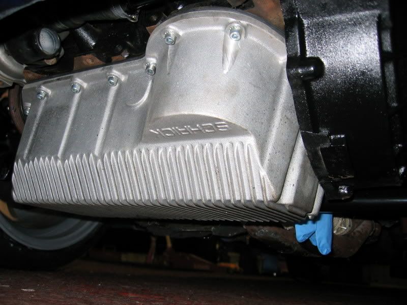

I then invested in a shrick sump :

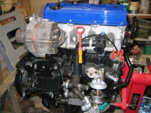

The engine built up minus the charger and the old alternator used for the mo :
In the engine went :

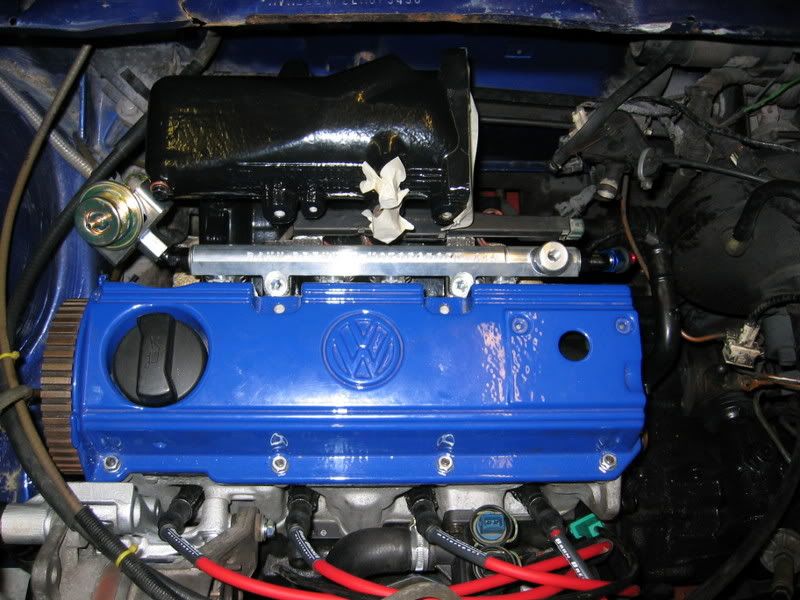

Billet brenner fuel rail :

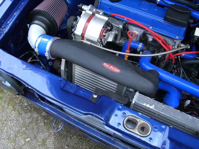

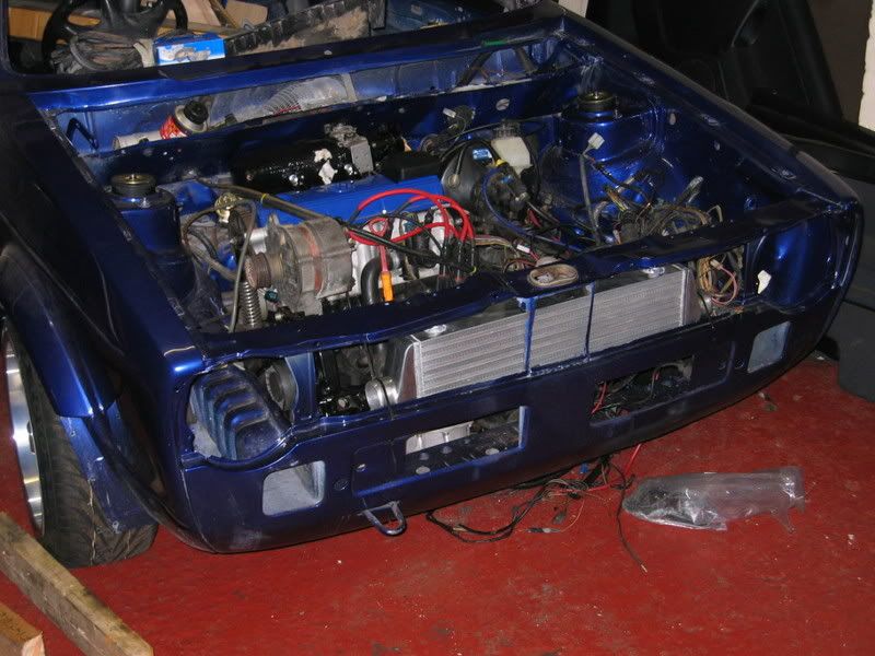

offered the intercooler up :

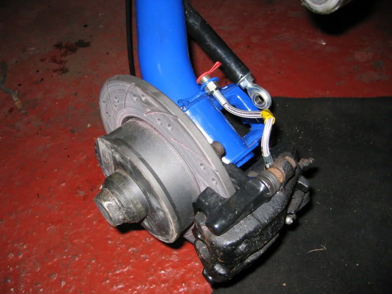

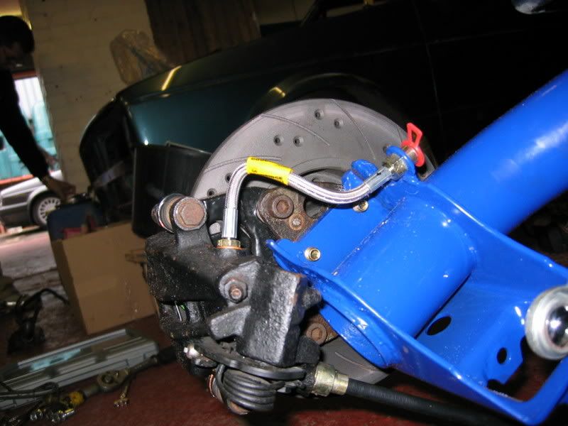

Rear brakes (now using mk4 rear callipers) :

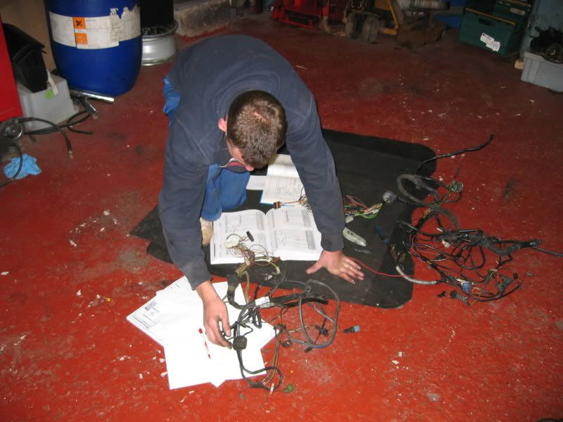

A mate who is a whizz with wiring, getting stuck in :

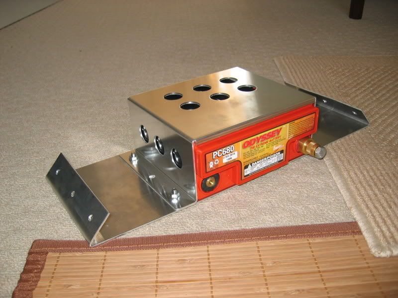

Battery relocated in the boot (using oddysey pc680) :

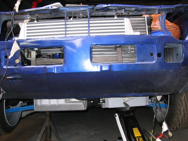

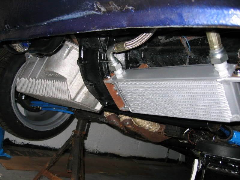

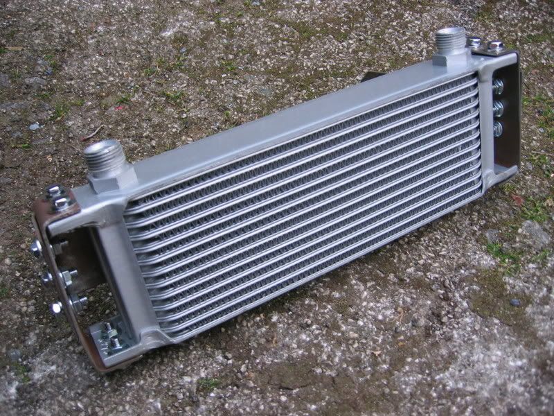

External oil cooler :
No space anywhere else in the bay, so it had to go here :

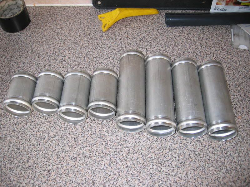

Boost pipes :

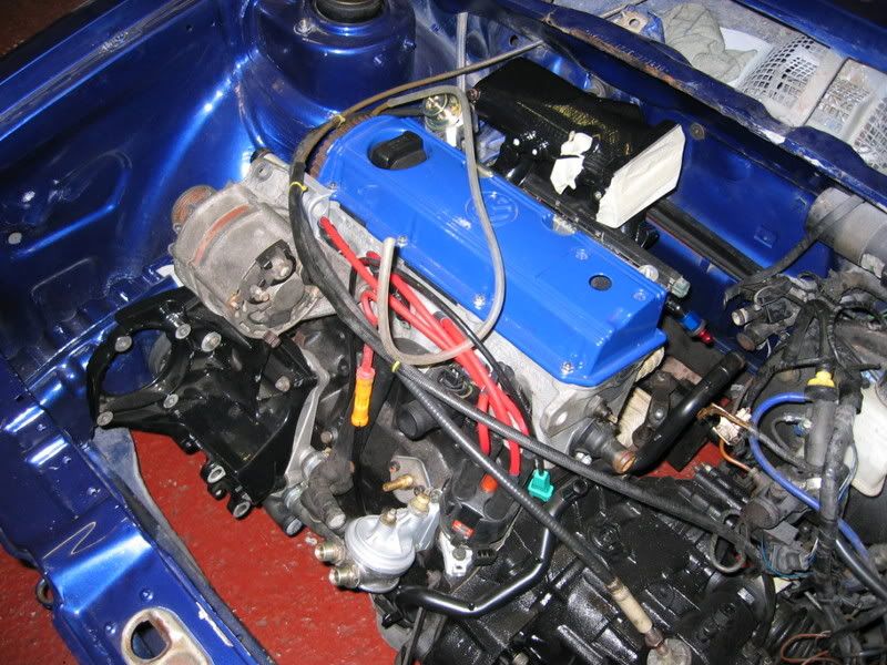

Again skipping the boring bits, the engine built up in the bay :

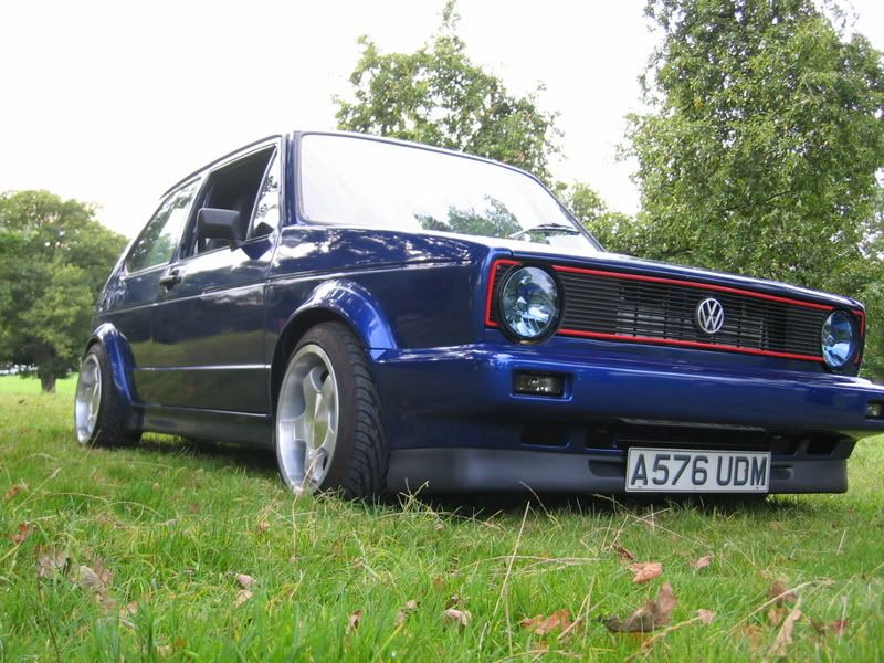

The car as it is now :

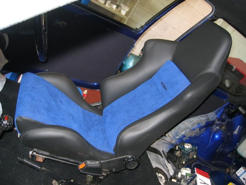

The seats :

if it helps, thats the first clipper style car ive ever liked!
looks nice, normally well OTT, but looks good, not too keen on the amount of blue used on some parts but still looks smart and as long as you like it, thats all that counts mate, i think its a good example of something retro

One thing - do you have any cowling or guard over your oil cooler? It's really exposed down there to stones / debris on the road / speedbumps etc… and it'd be a real shame if it got a hole in.

Well done on an excellent job, what colour you done her in? Only concern would be that oil coolers location to getting holed. Maybe a heavy mesh couple of inches in front ...
Rich
you say exposed but its not really, the sump is lower than the cooler so if any damage its gonna be expensive anyway, the underside of the gearbox's never really have any abrasive damage from road debris, so im not overly concerned. But i do get that moment of oh my god every now and then. plans afoot to get it safe guarded.

Well done on an excellent job, what colour you done her in? Only concern would be that oil coolers location to getting holed. Maybe a heavy mesh couple of inches in front …
Its a ford colour unfortunately, imperial blue.

Thanks all for the kind words, she isnt everyone's cup of tea, but i like her, and she goes very well. Mapping in august, with a few other bits to be added, she should be pushing around 200bhp, if not hopefully a little more.
