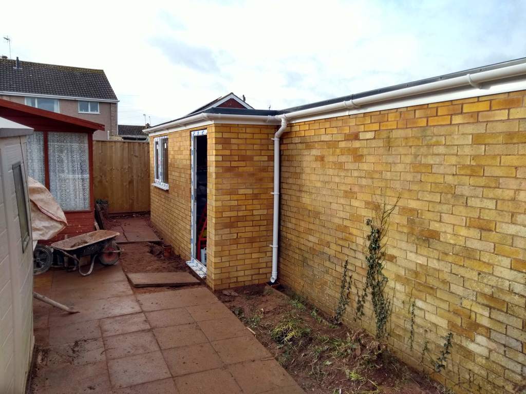

Got gutters on this morning and looking much smarter.

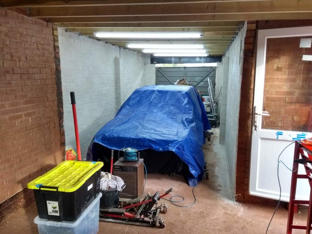

Got the lights fitted in the old section. Just temporarily connected up to check everything is working and boy they are bright :lol:.
IMG_20190115_160640994.jpg IMG_20190115_161517833.jpg IMG_20190115_170605965.jpg IMG_20190115_170612350.jpg
I've got to tank that section of the room first before the consumer unit and sockets are fastened to the wall. Dad is cutting the bricks flush with the wall tomorrow on either side which means I can make some room in the old bit to push the Golf in and then finish the piers on Saturday.
Should get the final 4 lights up in the new bit  and it should be super bright :D

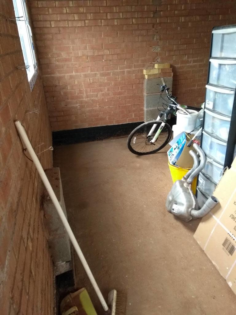

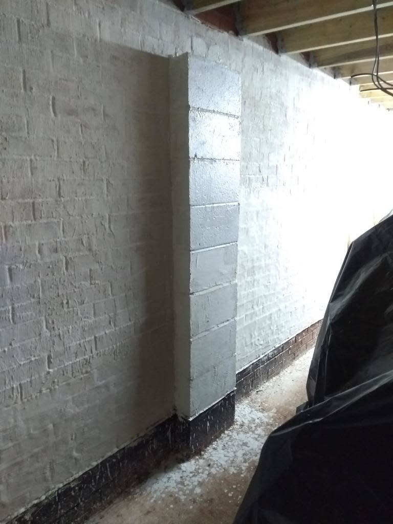

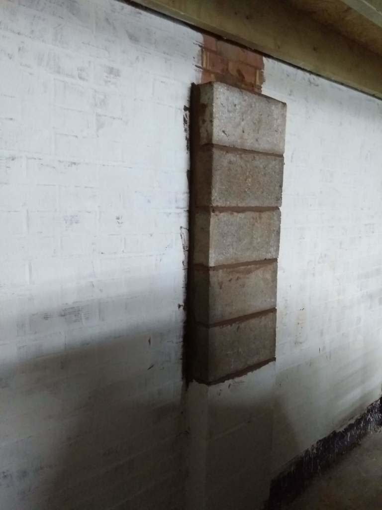

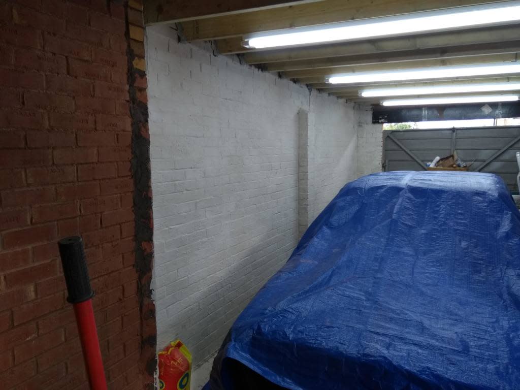

Got some slurry on today :DPretty hard work to get an even finish but got there in the end. I plan to give it a coat of paint once dried but certainly has brightened the place up.

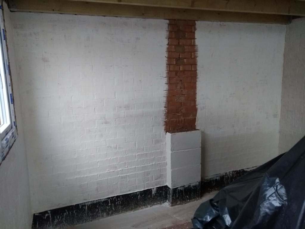

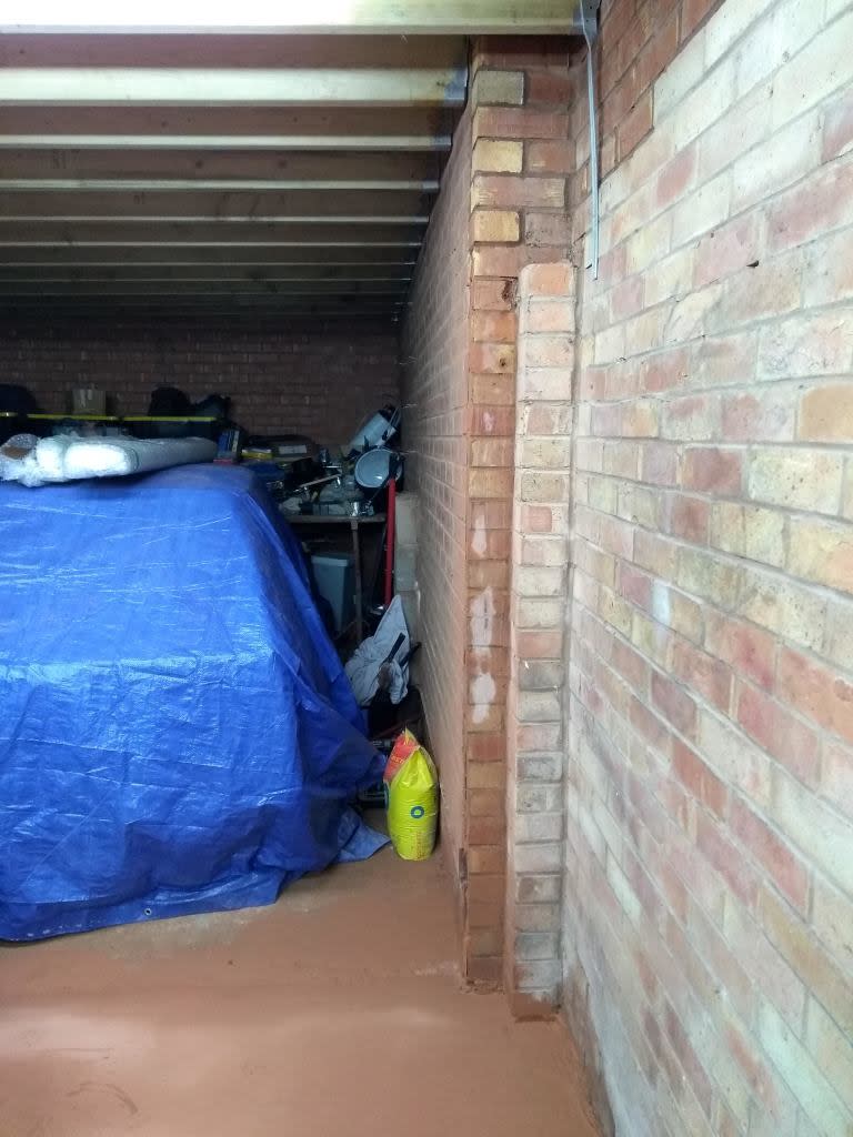

Next I cleared the room for the next phase. Plenty of room to finish the piers off ;) IMG_20190119_135530781.jpg IMG_20190119_135538271.jpg IMG_20190119_135544697.jpg
Even with the nose of the Golf a foot back from the new bit I have at least 2.5 metres behind :D IMG_20190119_124023000.jpg

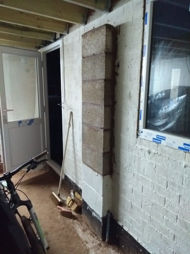

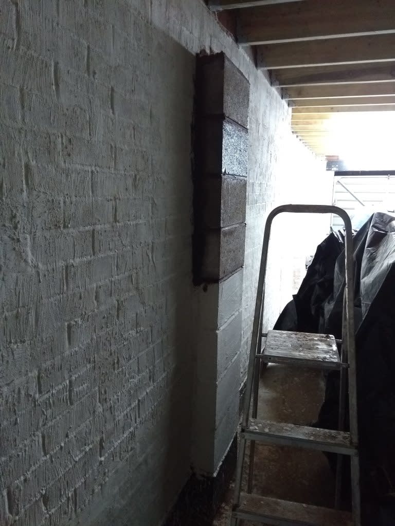

Got the other half started today. Piers are going in tomorrow so will put the second coat on when they are up.
First fix electrics should be mostly done this week. Saturday going to insulate and board the new bit so dad can get the lights up the following week and then the following weekend remove the ceiling lights insulate and board and should be done :DOh the garage door should be due end of next week or early the following so that will finish it off :) IMG_20190120_142452048.jpg IMG_20190120_142500274.jpg IMG_20190120_142507191.jpg IMG_20190120_142512966.jpg
