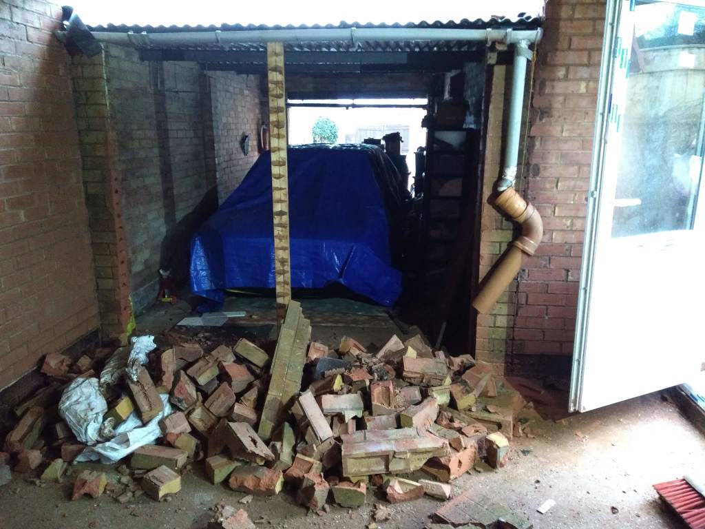

knocked through, this a rough cut just to get the Golf in
Then cleared up

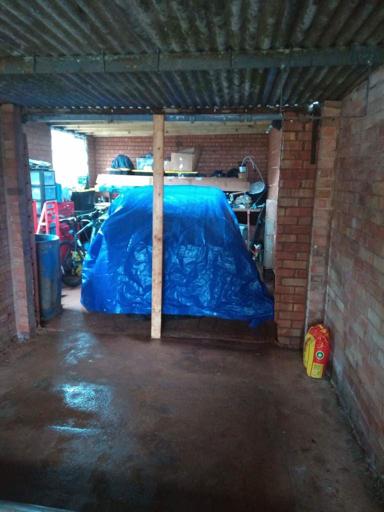

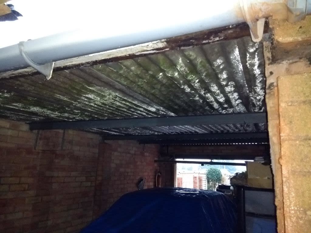

Pretty dank in the old part!

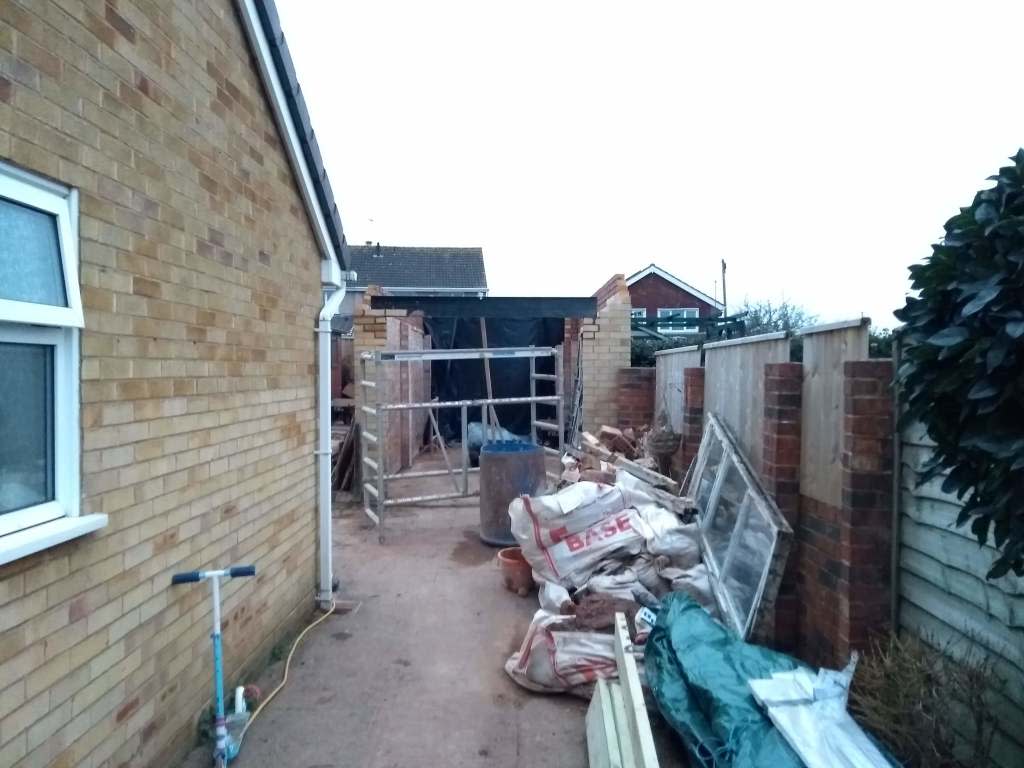

Monday we will take the old roof down and get the sloped bricks removed ready for the new bricks to be added.

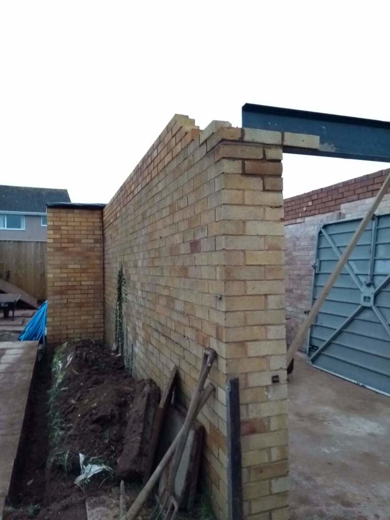

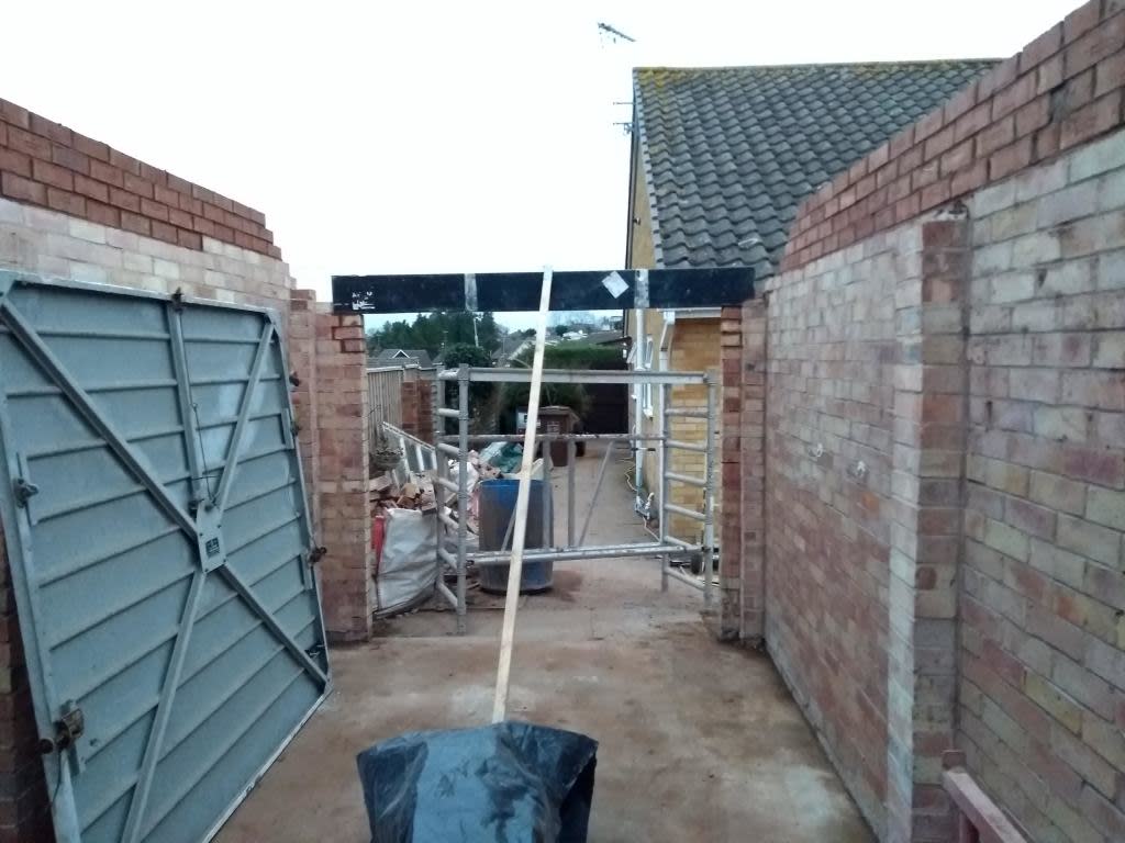

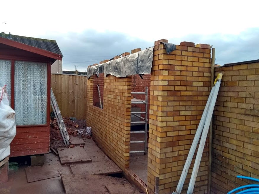

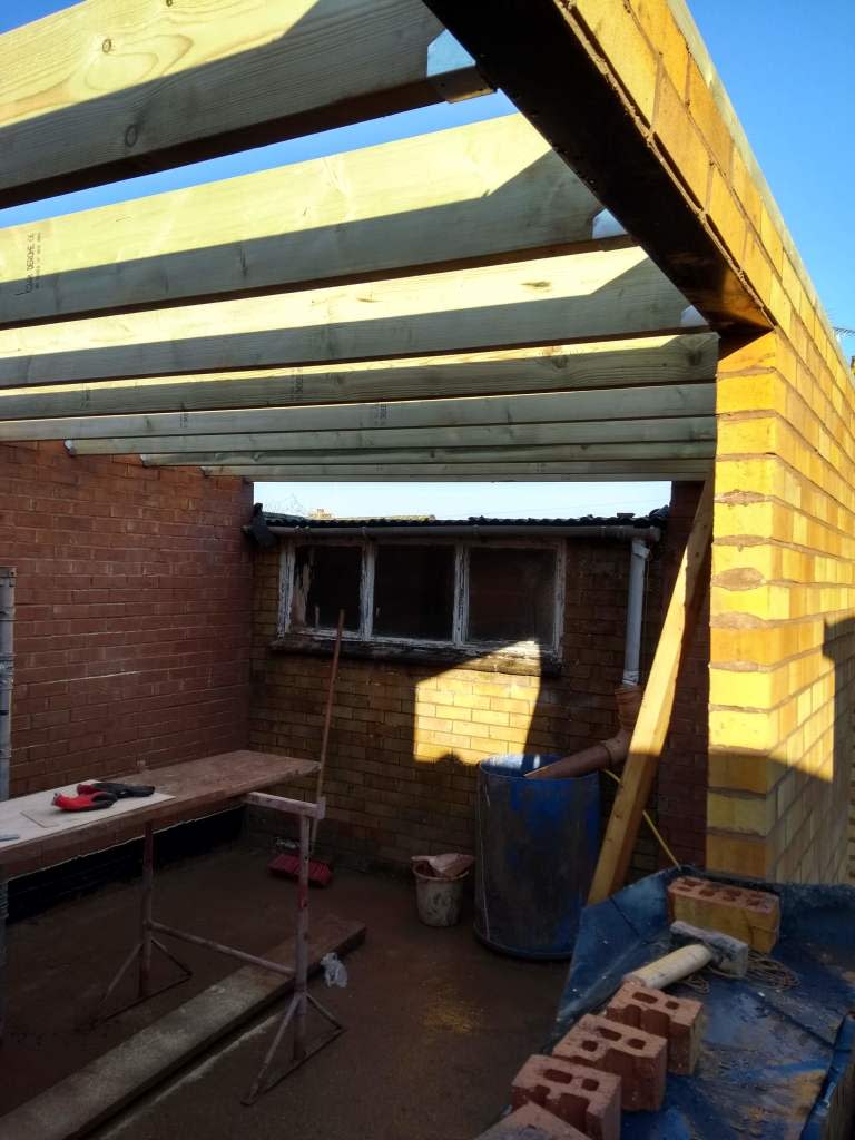

Monday old roof off, remove sloping bricks and cut remaining section
Tuesday building walls on either sides with wall plates plus new lintel at main garage door end.
Probably rest on Wednesday and to let the walls harden.
Thursday joist hangers and joists, then roof boards on Friday and hope for dry weather to put the rubber on Saturday maybe

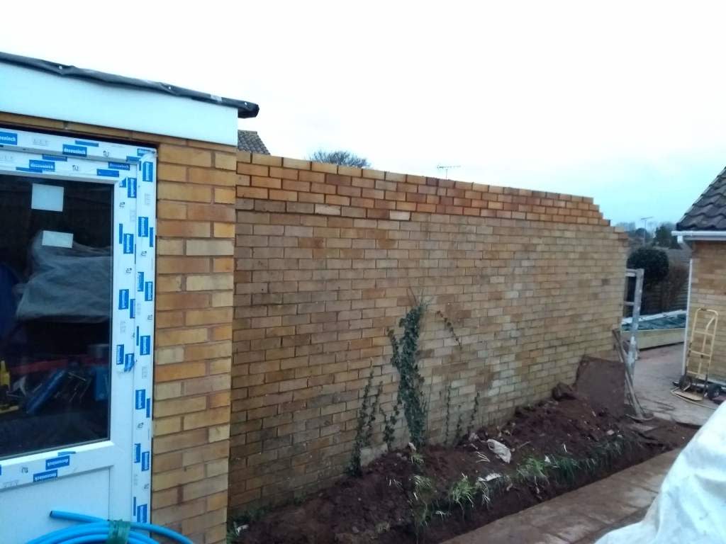

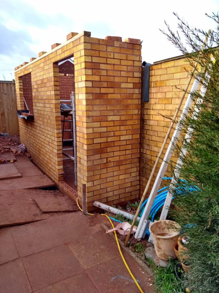

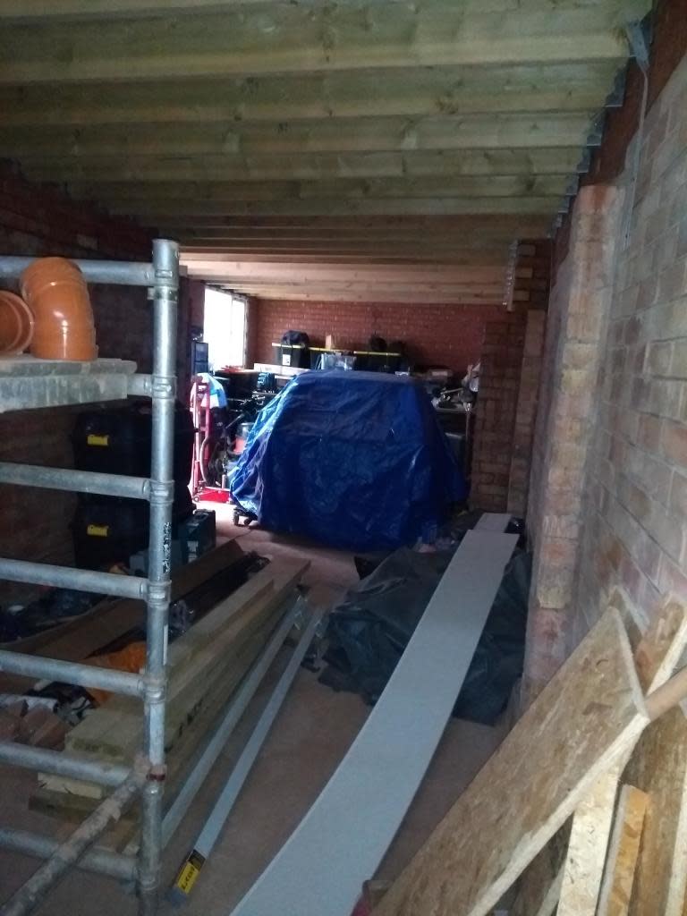

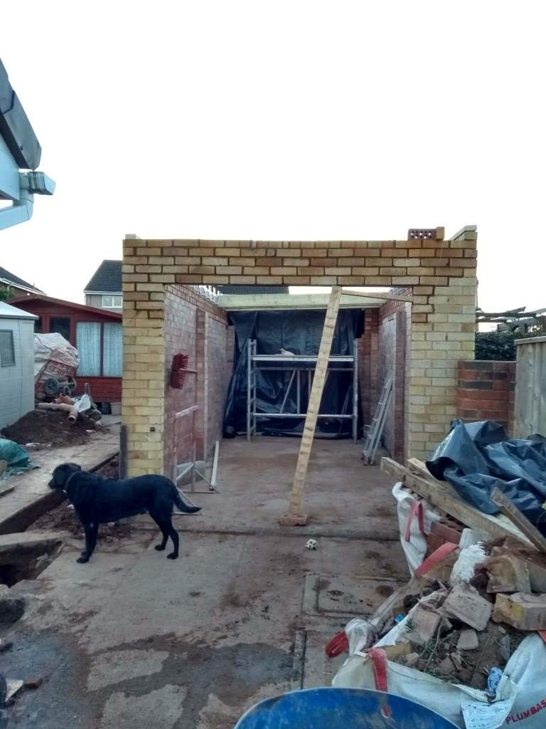

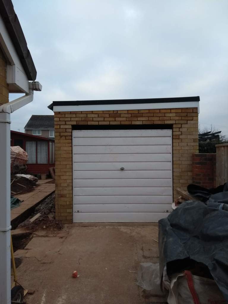

Going up again. Should have the front finished tomorrow, utilities dug out and wall plates on for Roof structure on Thursday
Got lots done, temperature pending (the fastening adhesive for the roof needs to be done above a min temperature) it looks like we may have the rubber roof attached on Saturday!

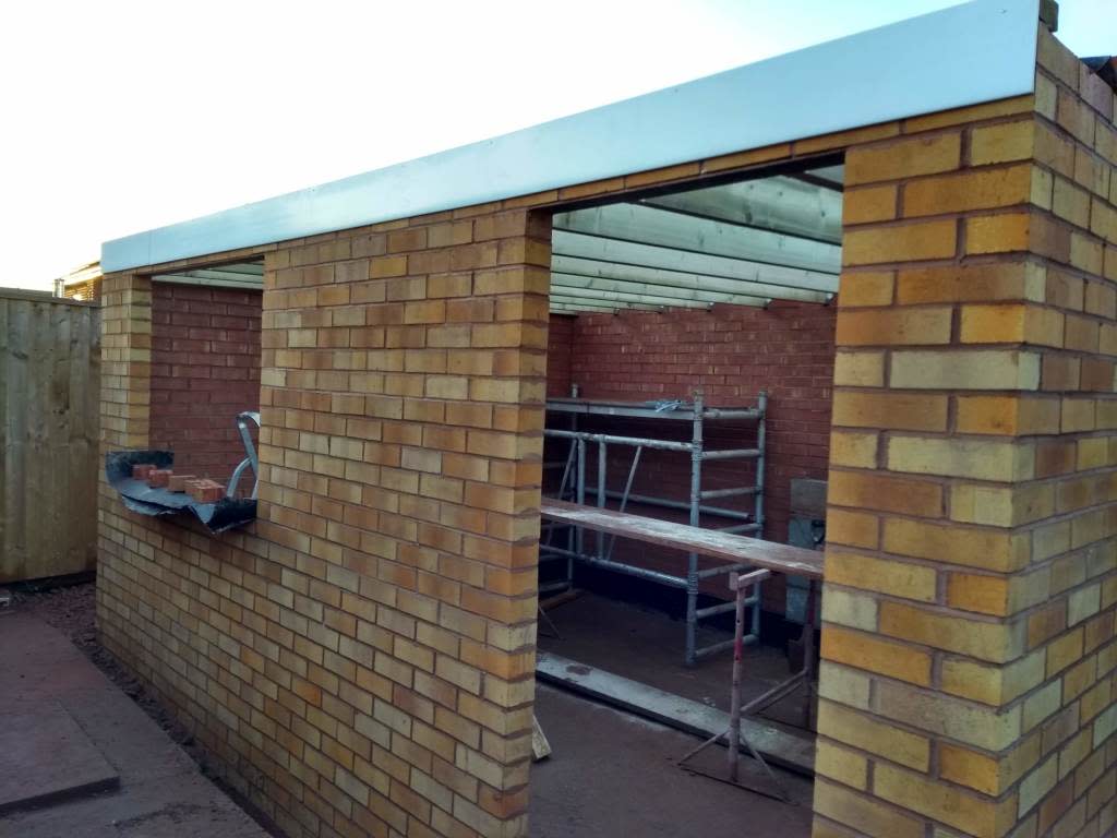

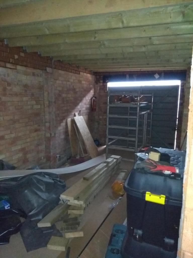

The rubber roof went down surprisingly well.
I'm really pleased with the internal space. Just needs a bit of finishing and storage space.
I have an insulated electric roller door ordered up to replace the old door.
Next week the drain should be in, gutter up, remaining piers built up to the joists and the middle opened up by cutting the bricks jutting out on either side. Following week should be electrics hopefully

Dad and I almost had a heart attack lifting it on the roof. It came as a bundle on a pallet, dad reckoned it weighed 400lbs for 11m x 5m. There was quite a bit left as due to the staggered nature I had to get wider than necessary.
Very easy to put down. I had dad and brother in law to help out. There are loads of training videos on their website, the bit that is quite difficult is manipulating the sheet and watching you don't fall off the side of the roof with the sheer weight of the sheet. Took about an hour to glue the sheet down and then about the same to tack the trims on.
I used Condell Ltd for the lintels. Very good price and quick delivery. The bricks are IBSTOCK golden multi buff which were meant to match the LBC golden buffs.
There is a bit of a colour difference with the existing bricks as they are over 60 years old so much lighter with lichen and sun exposure and the motar needs to dry as it's quite red at the moment but will go much lighter when it sets. I need to do some final pointing and maybe a touch of brick acid in places but really happy with it overall
