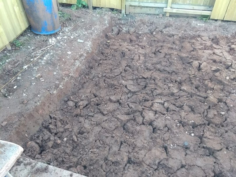

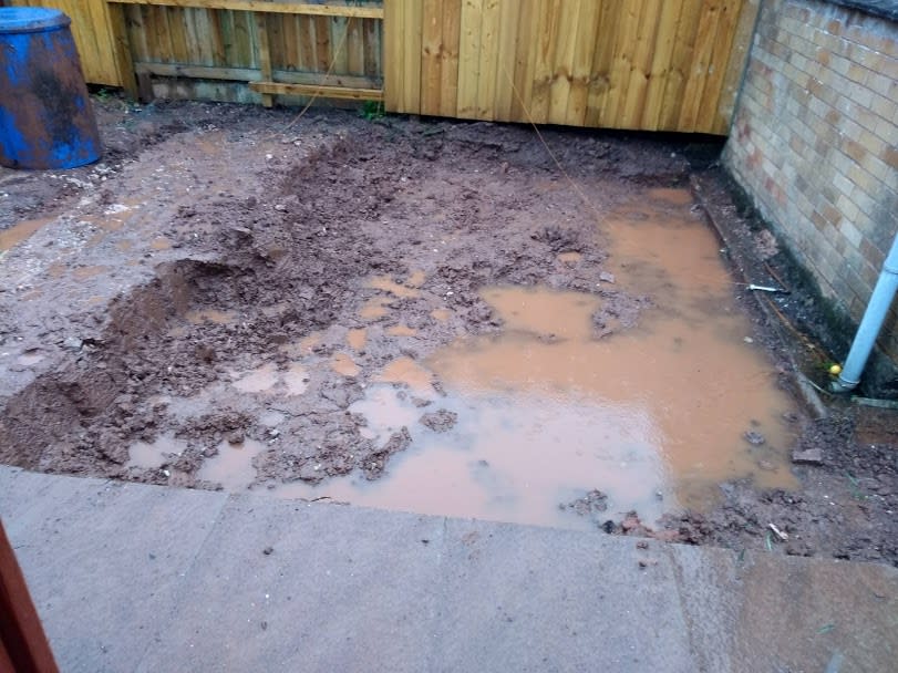

So broke up the base:
Last edit: by Rich.
Its not like we had a lovely summer or anything. Did you wait for the rain so you wouldn't sweat too
Looks nice. The good thing with a smaller build is that it is possible to do the ground works yourself. Mine works out at about 35t to come out, 10t of stone to go in for the base and then about 18 cube (3 lorries loads) of concrete. Plus about 3 tonnes of steel!
I'm beginning to wish I'd gone smaller!
Good luck with it and hopefully we'll have a dry October for us

Oh I was still sweating but it was hard to make out from the rain
I'm hoping to get this done pronto before the more extreme conditions kick in, I hope the beast of the east doesn't make a return :O

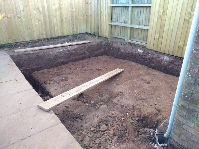

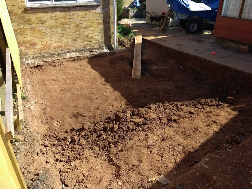

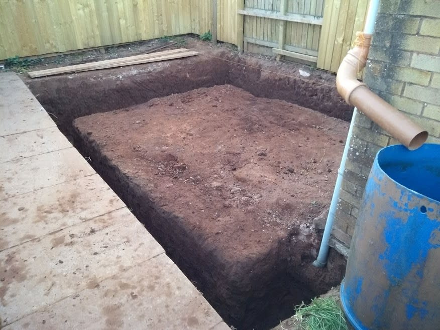

All broken up and we should finish digging on Saturday.
More exciting earth pictures
The existing structure is on a raft so going to keep it the same. Compacted 803 sub base, reinforced 6" concrete on top. First course of bricks with visqueen membrane tucked over and then 3" screed to level with existing floor.
borednow said
Holey hole Batman![]()
I cheated even more than you![]()
Found virgin ground yet? or is it all backfill?
What's your plan for the base?
Ian

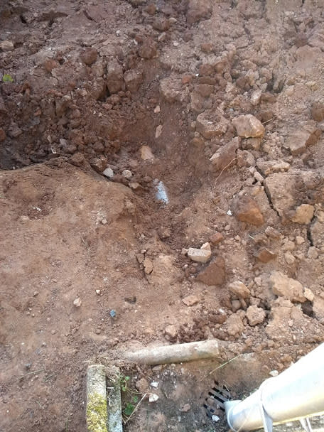

So last night i put in a few hours and found this beauty:
Fortunately in doesn't go anywhere and the end was covered in a cowl of bricks. Make shift soak away. Wasn't expecting to find it going in that direction but no problem as going to dig a drain going down to meet the existing drain.
Got folks coming round tomorrow to help bag the remaining bit. They are up on Monday and Tuesday to help nib away and ensure I have a consistent level for the slab
Last edit: by Rich.
Uncharted services are a pain ain't they?
I found the original gas main and water main tucked in against the side of the house. Fair enough. The previous owner did say he'd had them replaced with alkathene pipes.
But we also found another 5 metal pipes of varying diameters running up through the excavation! Always a bit nerve racking to say the least!
Going for a screed as well eh? Cool. I'm hoping my concrete will be good enough to leave it as the florr of the garage.
Happy digging
Ian

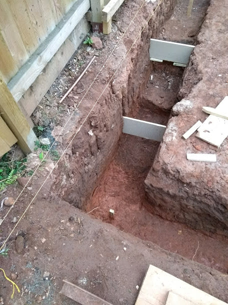

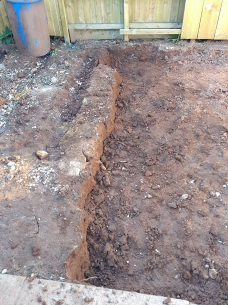

Going to go strip foundation, cleared the area down to around 2 foot.
Unfortunately there is an area in one corner where the earth is very soft so going to have to dig down any way so might as well put in strip foundations and go down with blocks a bit further than the other sides.
The reason for the screed was to get the final floor level and introduce the dpc between the reinforced concrete and final screed floor. No worries now as will just do the final floor in one go.
A lot easier
borednow said
Nice.
Happy digging
Ian

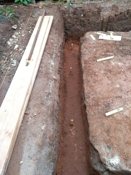

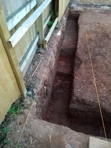

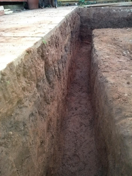

That's all the digging done phew
borednow said
Aching much?![]()
That's a good looking trench![]()
Ian
It was nice to have last weekend as a break
Tidied the trench. Pegged out to 200mm for concrete

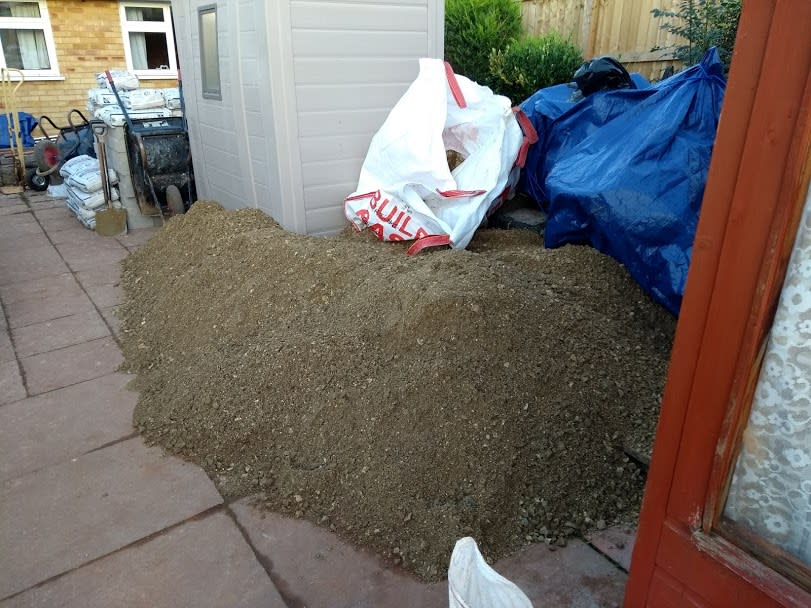

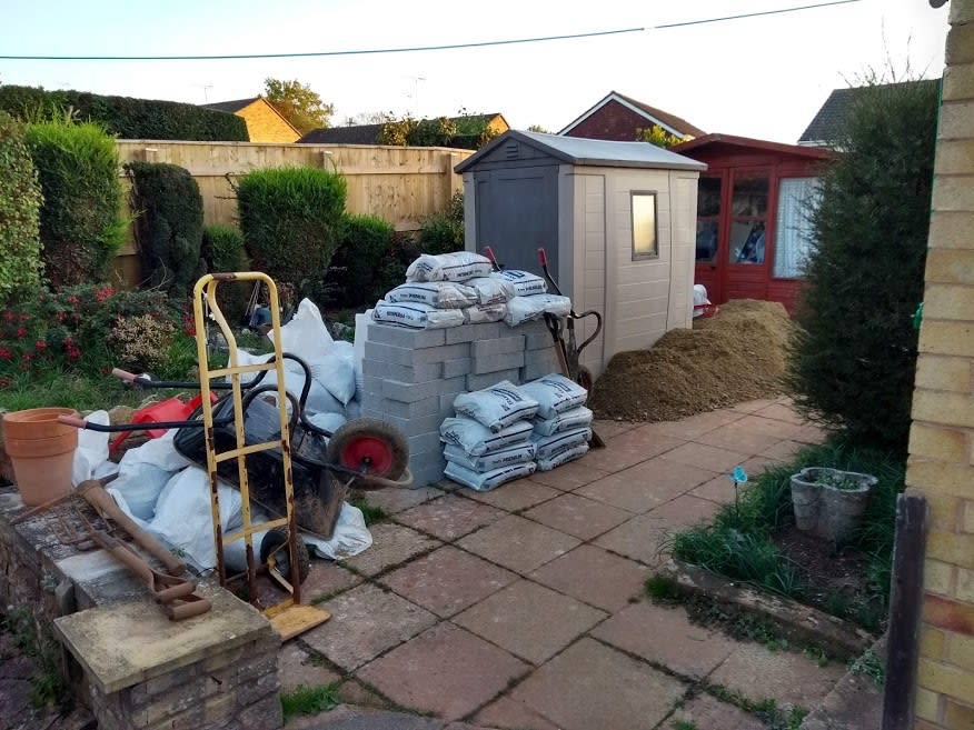

Material arrived at the break of dawn this morning
And carted to the back garden ready for Saturday
