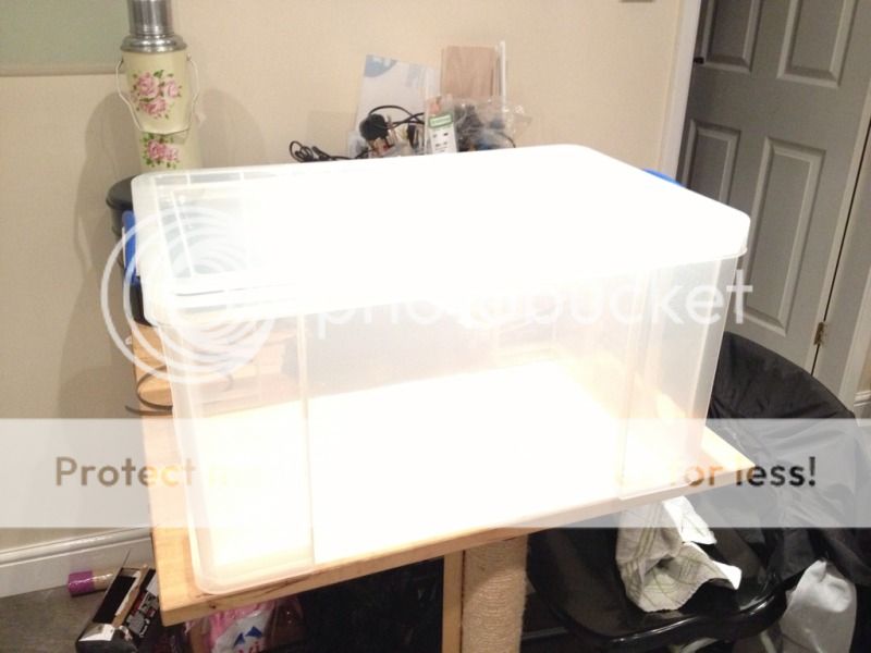

to make any good cabinet it needs to be a complete unit to start, like a oil drum or a old metal water tank… but with none of tho's around it got me thinking…… i have a bit of a addiction to "Really useful boxes" (other boxes are avaible)
so a 84L box was purchases for the huge fee of £16 english pound

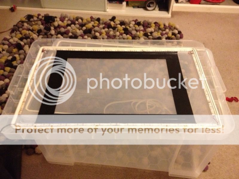

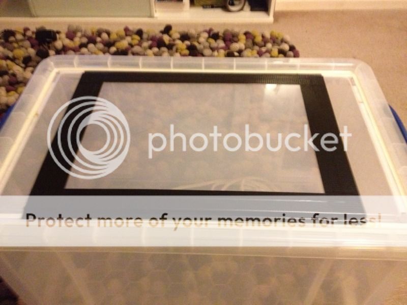

i've gaffa taped some clear asitate to the inside and outside of the lide, this is to help maintian the clearish finish as blasting will frost the perspexs very fast
then i got some p shap draft excluder to try to create a seal around the join between box and lid

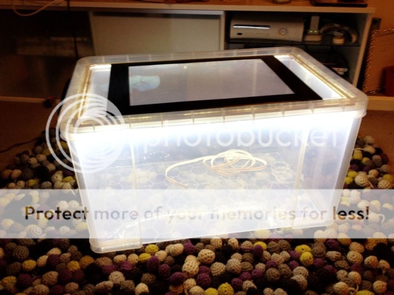

also added the left over ribbon LED from the diorama around the lid
all lite up, should help me see in there

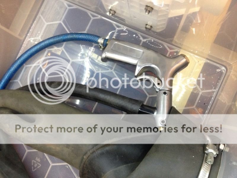

5" hand hole cut out then a a fitting bolted in and rubber gloves attached
4" inline fan bolted on the side, this shifts alot of air which is a good things
a grill and ductin from the box to the fan

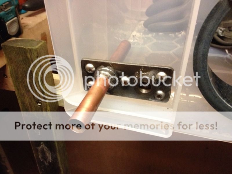

made this at work, it's a fitting to take compressed air and the media, should hopefully take both into the box without and leaks
all fitted up to the box
fun installed, i need to find some nice flexable pipe as this stuff is very stiff making it difficult to use
as it stands tonight
thats it for now, i tried it out and everything is working as it should just need some media and some nice flexable pipe work
