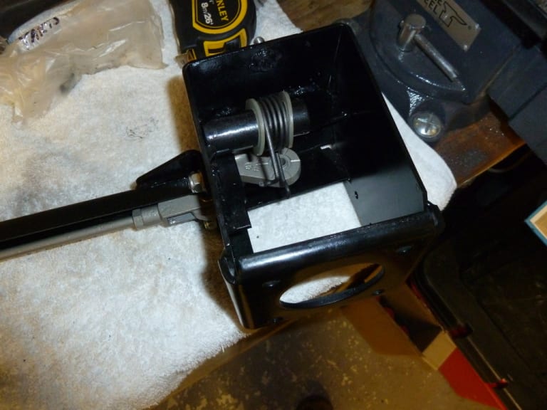

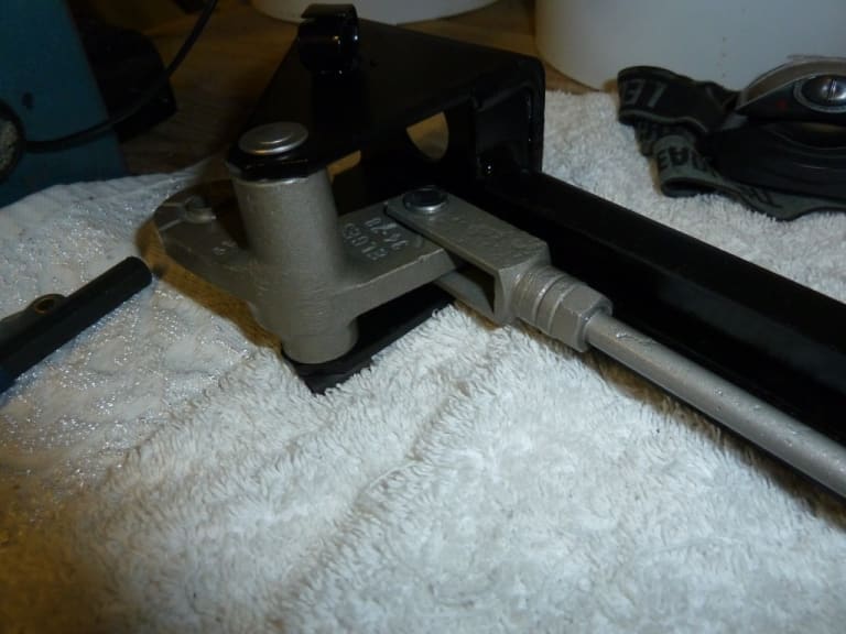

Firstly, the brake linkage:-

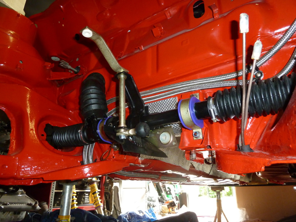

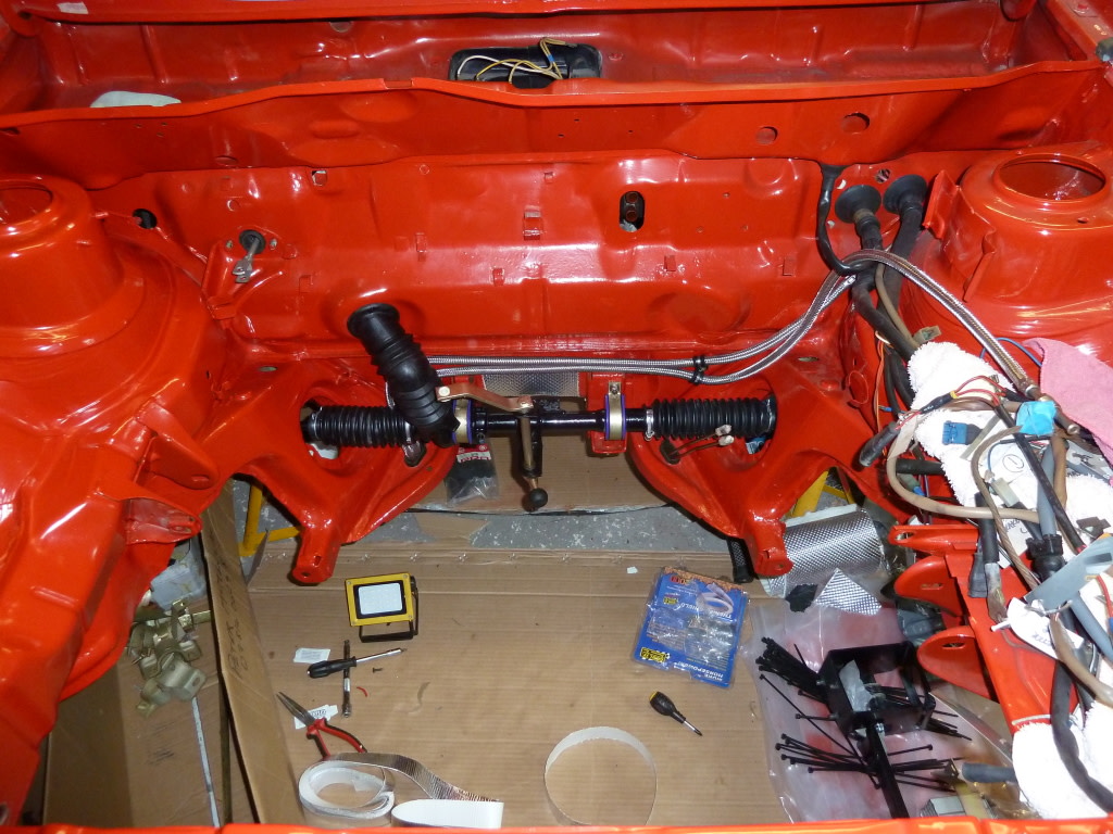

The new Crazyquiff fuel lines are run in and tied in across the bulkhead.

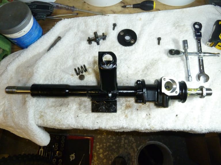

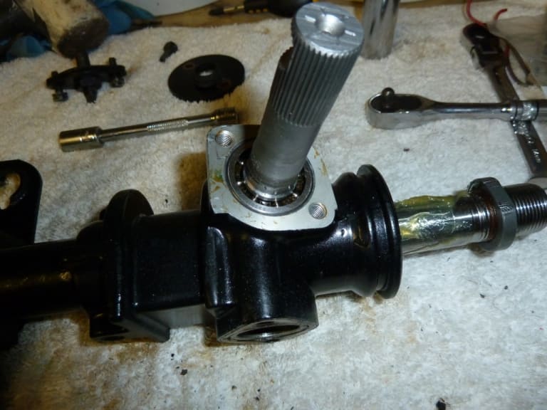

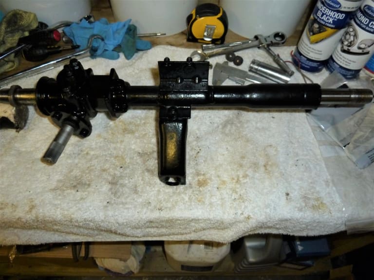

Steering rack installed with new Powerflex bushes, new tie rods, new gaitors and new genuine clips. Have installed some of the refurbished bits of the gear linkage too, which were all glass bead blasted and zinc plated, then fitted with new linkage bushes.
I will be wrapping the steering rack boot in heat shielding in case there are clearance issues with my stainless manifold. I wasn't planning on wrapping the manifold, but I would be keen to hear opinions on this.

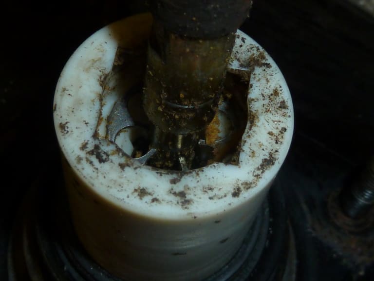

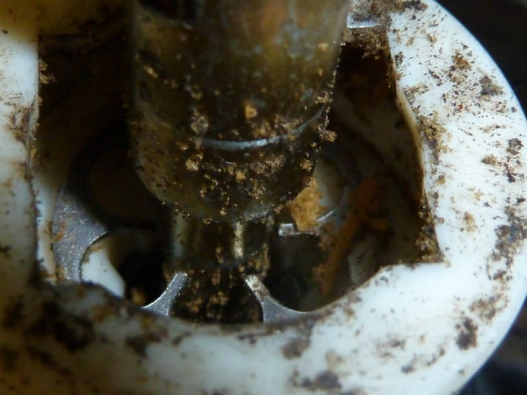

Not the best pic but I can't take the boot off as trying to get that linkage on the re-threaded rod was a b'stard.
I'm not sure if it's purpose is just to stop non-linear movement of the push rod. Given there is a boot over it anyway I'm not sure any muck would get in there.
