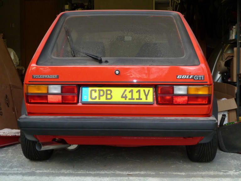

Almost 6 years have passed to the day, and I'm hopefully on track to fire her up exactly 6 years to the day on 01/02/2020!!

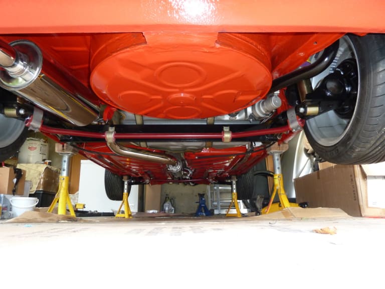

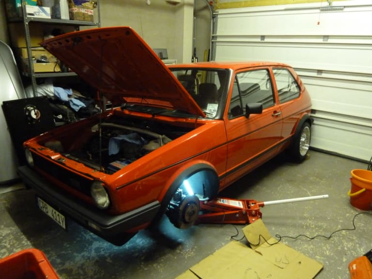

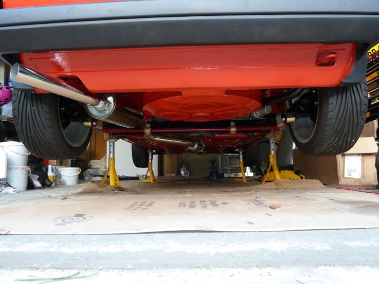

Have had a couple of minor niggles to deal with but nothing major. I managed to get her back onto all 4 wheels again this afternoon for the first time in those 6 years!!
The layer of dust kind of hides the amount of work underneath!!
Need to find my washer bottle and get that cleaned and fitted, then bonnet on, put some fuel in and see if she fires up. Once I've had her running, it'll be a full detailing session to get the paintwork back to tip top condition. And then show season 2020 !!!! At last.

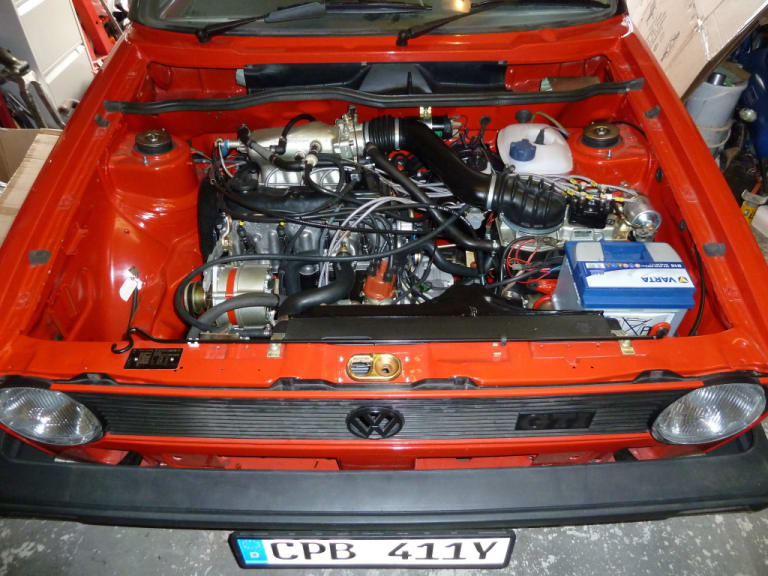

I have a set of CrazyQuiff braided fuel lines like yours. Did you put any protection around the pipes where they are held by the under car metal lugs?? Clearly you cant use the original rubber protectors.
I also see you have used a couple of P-clips in the engine compartment to hold them. Would the original fuel pipe clips not hold them in place? I see you talk about a fuel pipe lug breaking off - is that why you used them?
I would appreciate if you have any more pics of your brakes servo pipework set up. I have a 22mm master cylinder and larger servo like you. My previous setup used the three way adaptor as well. Would you mind posting a few more of the pipe work for the servo/master cylinder as you appear to have done it very neatly.

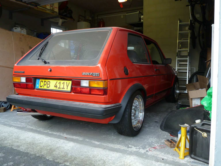

Thanks for the kind comments Harvey. I've had a few niggles to get her back running again, but had it out for a quick run round the block. Had to adjust the gear linkage slightly as 1st was not quite right. Got the indicators at the front fixed with some new wiring.
I haven't had a chance to get it fully detailed, want to get my garage sorted first so have ordered an epoxy 2pack floor coating.
As always, there'll be more updates to follow!,
Good news:-
I took it for a quick run round the block and it drove really nicely, but obviously still needs to get the fuelling properly set up. The exhaust is catching ever so slightly on a heat shield near the axle, and the gear linkage needed adjustment.

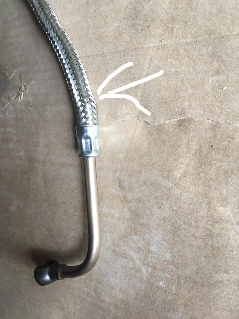

After adjusting the linkage, thought I'd take car out of garage to check I could get all the gears ok. Couldn't understand why it was turning over and not firing up again (thought I was back to square one with the previous issue). Then noticed a large pool of fuel under the car at the fuel pump. After further investigation, found the new braided hose from pump to accumulator has suffered a fairly major failure of the hose under the braid. Looks like there's been a flaw in the crimp. Now waiting on the replacement coming from CQ's.
