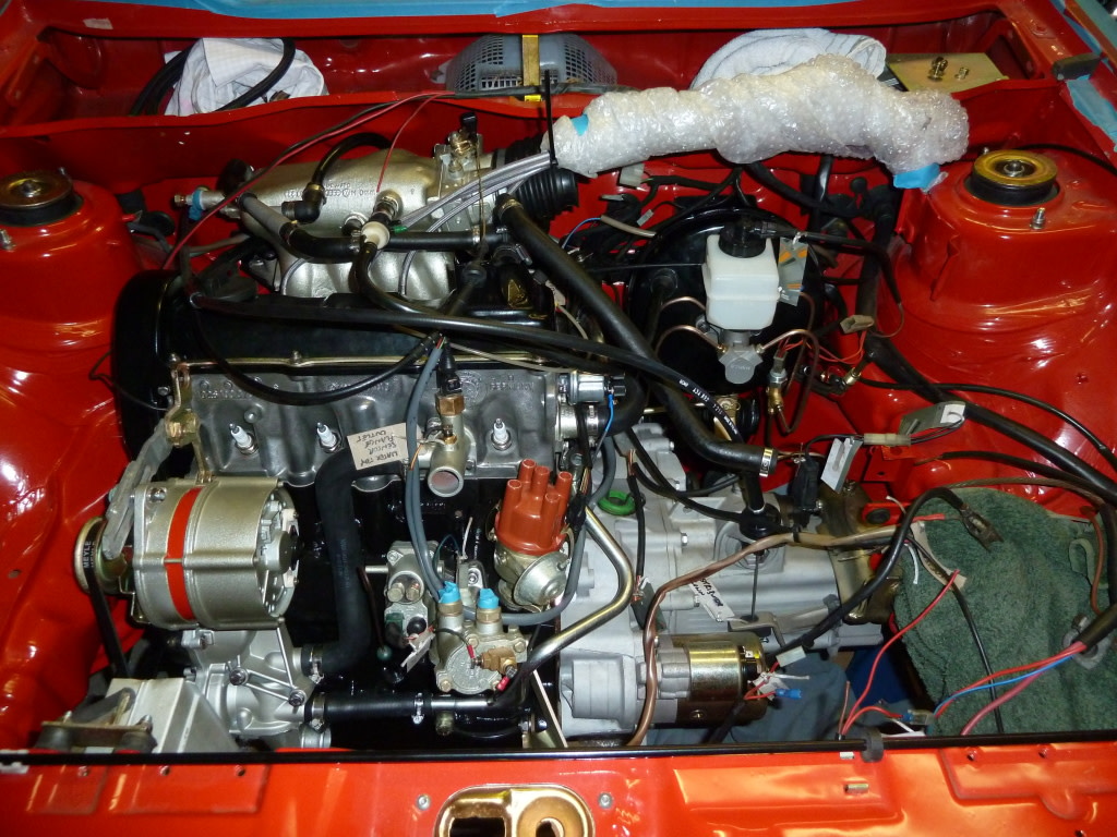

Managed to get the new genuine brake reservoir fitted, but my God this was a serious wrestling match to get past the new master cylinder seals.

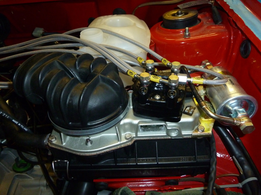

Metering head and new HEL stainless injector lines installed. The quality of the HEL stuff if fantastic, although I might cut off the yellow labels as it's a bit in your face. The main fuel supply/return lines all connected up and all but the battery and fan wiring is connected.
New genuine coolant header fitted, although I'm not sure the hose I've been supplied is the correct one as all the bends seem unnecessary. Anyway, that's the latest update from tonight. Tomorrow's challenge is to trial fit the exhaust so I can measure up for the adaptor from the manifold to the front silencer.

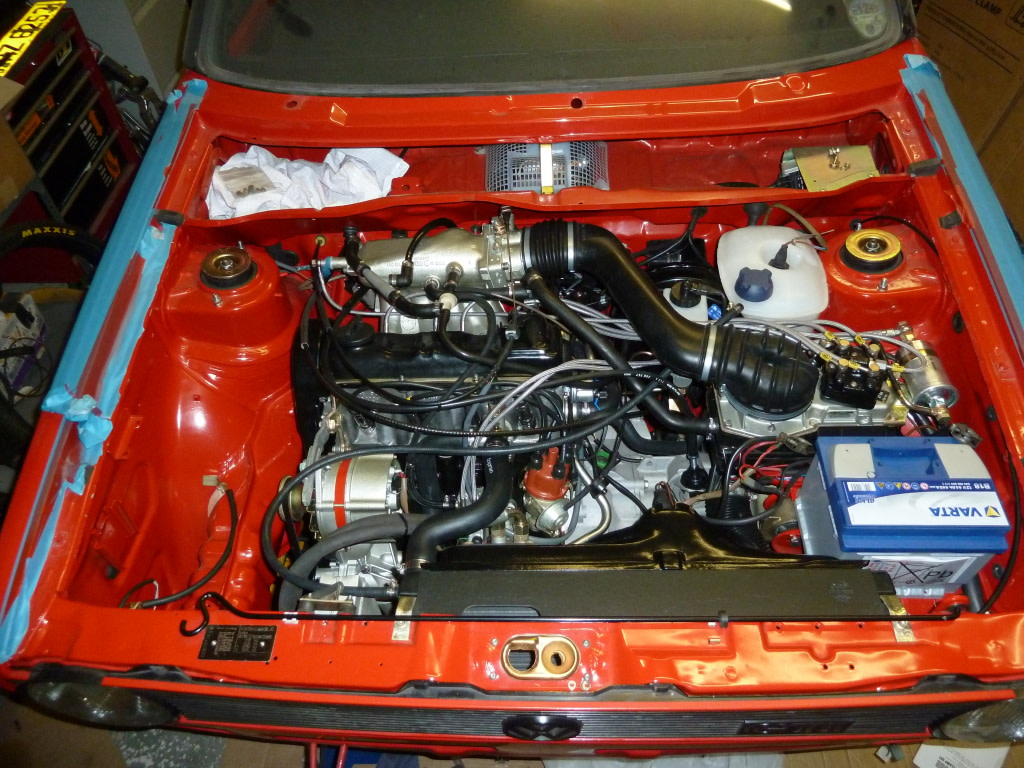

Front Eibach ARB fitted (at last, this was a proper wrestling match).
Powersprint 60mm race system fitted. I love the rear silencer on this.
Engine bay latest.
