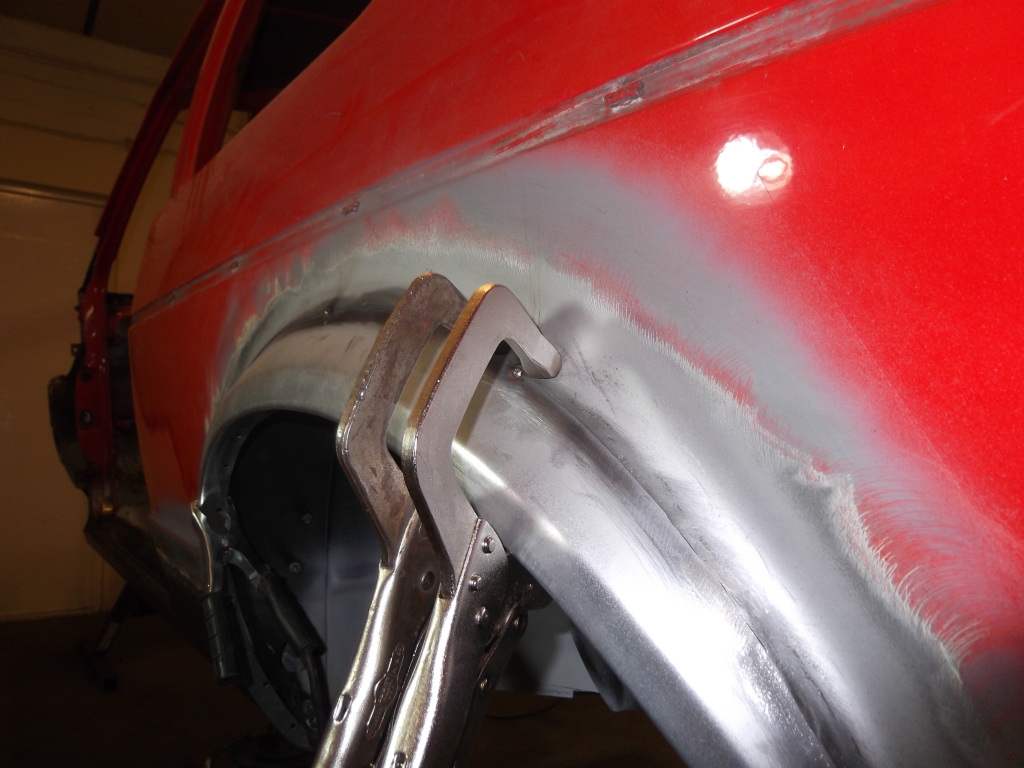

Hi all, small update.
I've been working on the N/S rear outer arch for the past week or so, grabbing a couple of hours where I can. Finally got it to a stage where I can finish it off with some lead. I've never done leading before and will be giving it a go over the Easter weekend :cool:  Taking Yomps advice I did the spot weld and leave to cool before moving on to the next method, worked a treat!!
Here's some pics…….
First few spots
holes for spot welds on the arch lip
bit further on
Almost done, arch has no warpege at all

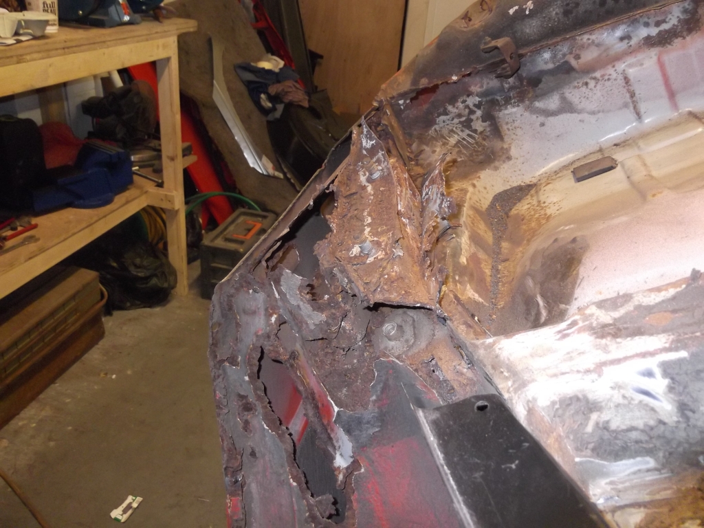

I also made a start on O/S Chassis leg/Axle mount, it's in a right state lol O_o  at least now I've done one of these before.
Removed chassis leg and offered new one up, it's a good fit apart from the panel has an extra cut out for something, not sure what though?
This view you can see the extra cut out which I will patch over before fitting.
More pics of the rot
After a bit of a clean up
These are a few of the things I will be looking at over the Easter break. I'll have another update on Monday night hopefully.

That arch looks pretty good to me! I'd be proud of that. I doth my cap!
Regards your lead kit, let me know if you have any questions regarding the application of the flux etc.
The important bit now is not to get too much heat in it when applying the lead and undo all the good work so far!

One thing I was wondering about is that the new arch is galvanised, I've cleaned the area where I will be leading but there might still be traces. I'm hoping that the tinning process might help.
I've been watching video's on youtube to get an Idea of what to do. Like you say though, I'm just going to have to be careful not to put too much heat in.

DA the galv off on the areas that need lead. Don't under estimate how much area will need to be used to blend the join.
Nothing worse when the lead won't stick on a place that you need it as it makes it hard work.
I'll take it further back than I need to then. I thought it might cause problems. Cheers mate.

That O/S axle mount is well ripeO_o.
You'll be an expert by the time you've sorted that!:thumbs:
Riper than a ripe thing on a ripe day :lol:
Hats off to you Andy for taking that on. :)
Yeah the Axle mount is definitely ripe lads :lol:  It needs attacking from all directions. I'll get it sorted though :ninja:
Great work Andy, looks great!

Just had chance to look at the You tube vids Andy.
He forgot to put tallow on the paddle at the beginning but yea thats pretty much how you do it.
I can tell you have a good feel for metal so you'll soon get the hang of it.
If you need to, you can add a little bit of water to your flux over time otherwise it can thicken, leaving the lid off etc.
I would also use a whurly wirewheel on your spot welds lightly just to remove those last bits of engrained carbon deposits around the welds. Although the acid in the flux will also clean you want that to have to do minimum work ideally.
It looks like you only have one flat paddle with your kit. A half round one is needed ideally as well to get around the inside radius of the arch (above where you spot welded)
