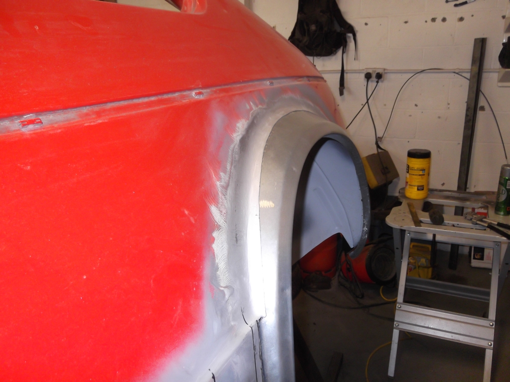

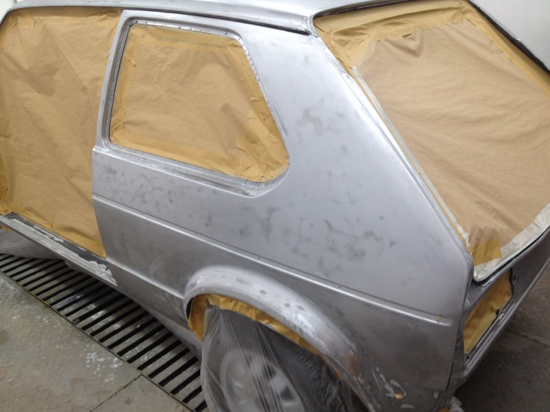

Pictures say a thousand words!
This is a replacement arch I did and then lead loaded. This is bare metaled without filler just a bit of lead. You can't see the join and needed the thinnest amount of dolphin glaze filler to bring out any remaining flat spots.
Well worth taking your time.

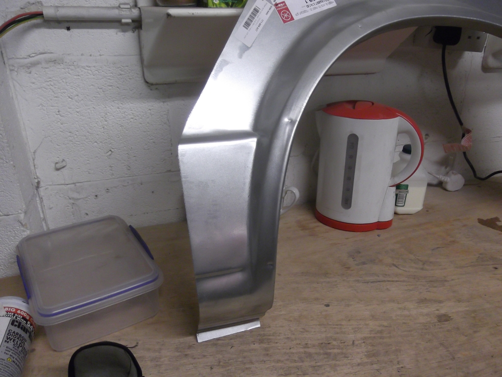

My main concern at the minute is which way to tackle the sill to rear arch area. I got ahead of myself and cut away some rot (maybe too much) at the front of the arch before I fitted the sill.
I now have, the original panel underneath, the new sill coming in over the top and then I'll have the new arch coming in from above lol, so I'll have three pieces of metal coming together to make one. Not sure which piece to cut away O_o My thought was to cut away the arch part of the sill and continue the new outer arch to the bottom if you know what I mean. Here is the new arch..

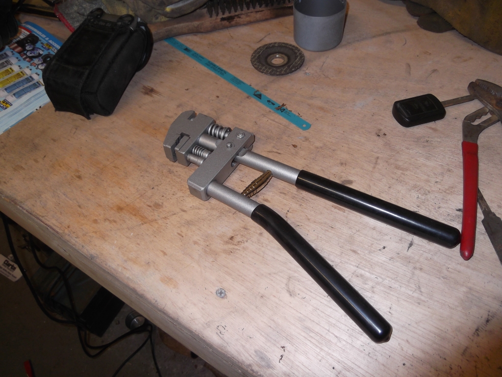

If it were me I'd keep the arch panel hole and cut the sill/rear corner to suit. Your arch curve will be right all the way round then.
However you should ideally  joggle the joins so they fit flush to each other on the outside edge. Again keeps a better shape without requiring as much filler.
A tool like this produces a small step on the edge of the panel.

Cheers man, that's what I thought. Already bought a joggler/hole punch, it's a great tool. It's saves a lot of work drilling too!

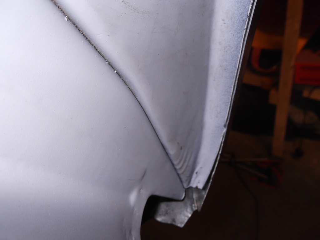

Hi all,

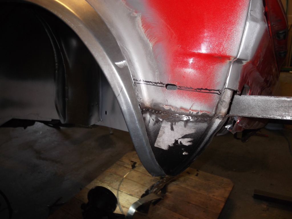

Small update. Made a start on the n/s rear wheel arch. Having never done this before, I'm taking my time. Today started off with me cleaning odd the rust treatment I applied last night and then on to marking up the repair panel and the rear corner. I took my time and made sure I didn't remove to much using the 'measure 3 times, cut twice' method :lol:
Here's a few pics….
Rust treatment before I removed it
I then removed the last return edge of the arch and taking Yomps advice on being careful not to cut in to the arch tub, I put a piece of the old arch between the two so as not to damage the tub
New panel marked up
Also had a repair at the rear corner to do
Arch panel cut to size and trial fitted, still haven't welded it in yet, I'll get that started in the morning before Band practice and crack on again in the afternoon
Back corner from inside
It seems to be a good fit all the way round so very pleased so far.
That's it for now, I know the progress is slow but what's the hurry :cool:
Cheers, Andy.

That  looks spot on!
Might be too late but……..
Can you still take out the new arch panel as you need to drill or punch (using your joggler-if it has one) a series of small holes (about 5mm dia every 50mmish) around the lip of the arch so you can plug weld it to your tub and then grind the welds back. If your not sure what I mean I'll draw another diagram but it wont be until later as I have to work today!
Cheers mate, I'm pleased with the way it's turned out. I still haven't welded it in yet. I'm going down the lock up after band practice this afternoon so I'll punch the holes in then.
