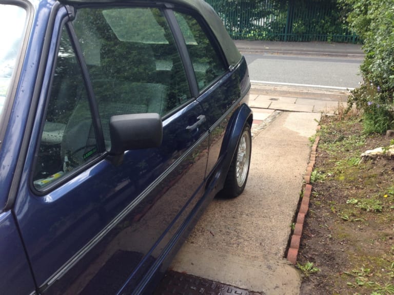

Ok heres the car from one or two favourable angles, doesn't look too bad for a car of its age but the lacquer has peeled off from a large proportion of the bonnet and top of the wings so will need a bit of a respray at some point. Also needs a new mohair roof but i just wanted to make sure everything was mechanically sound before i proceeded.
