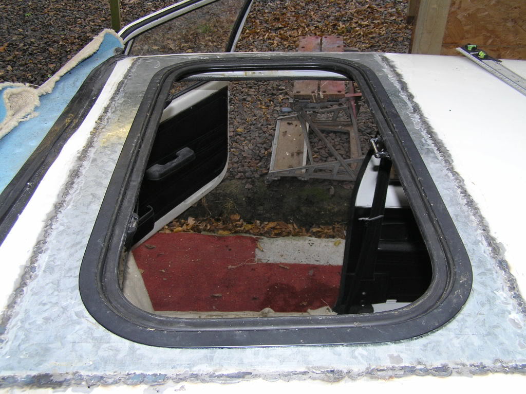

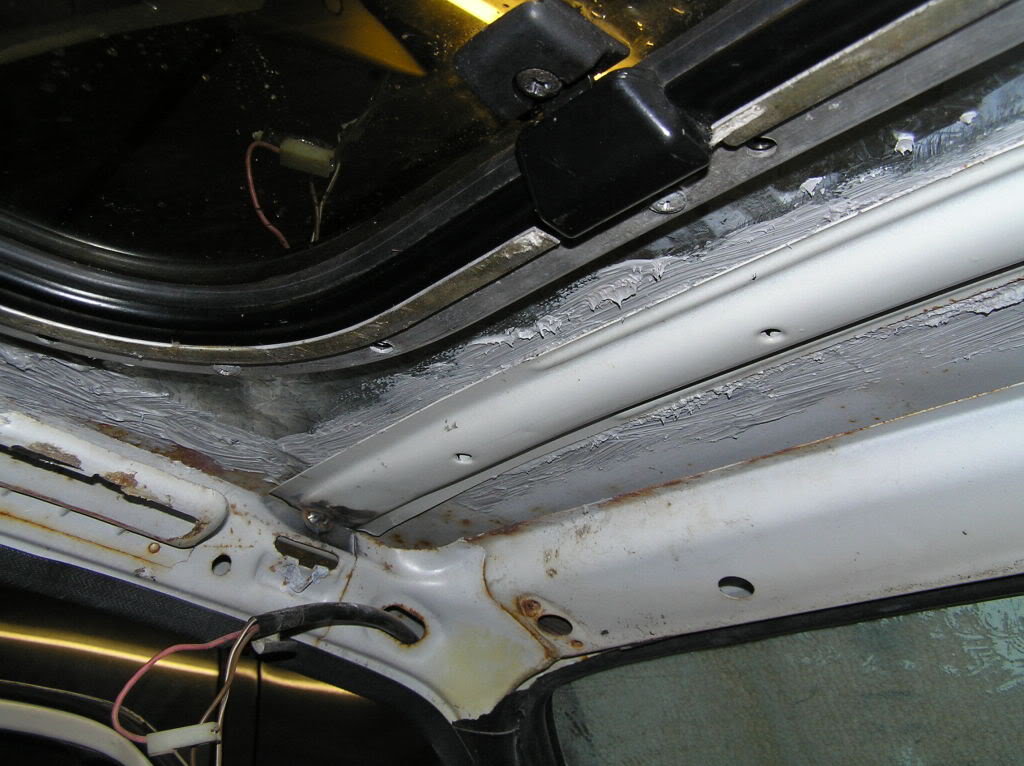

Anyway, the sunroof was a mess, it leaked badly and it transpired that even the roof around the aperture had previously been perforated by rust, and had been pugged with fibreglass prior to the respray that had been done before I bought the car. So I couldn't just put a new roof in since there was nothing solid to set the frame in.

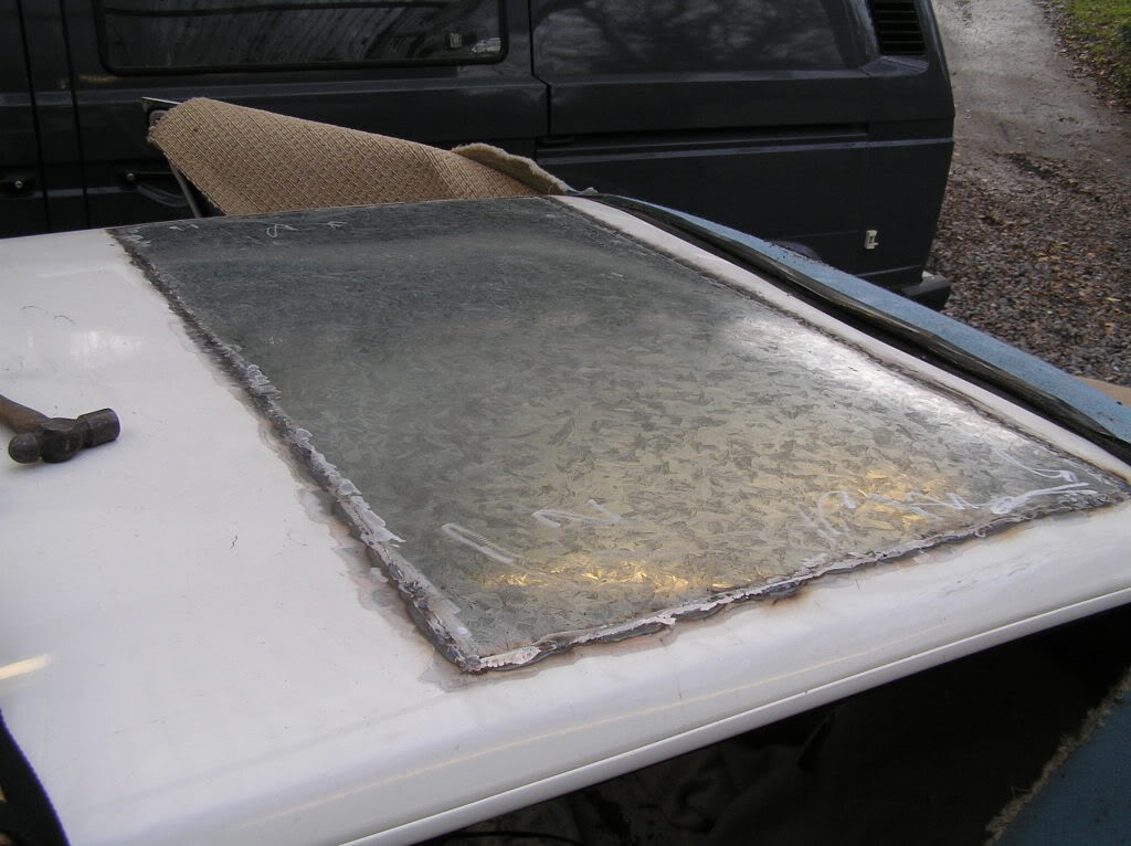

So, I got radical… Cut a big hole to where there was decent metal, and graft a new panel in..

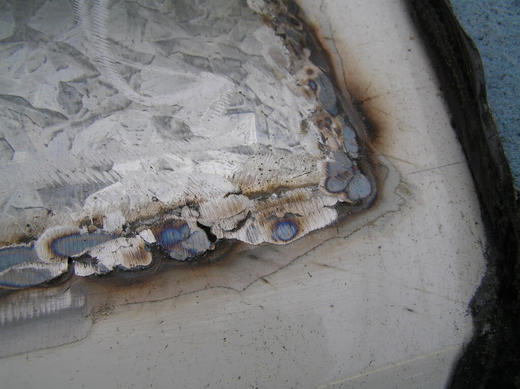

I managed, by very careful measuring and cutting, to get the panel the same size as the hole and graft in in flush, butt welding it. Bit disappointed with the welding, but it's strong enough.
Then ground the welds down, and a bit of beating the restore the shape after a little bit of heat distortion.

Trial-fitted the frame;
And glass
I need to keep the frame in while I do the filler, otherwise the roof shape is all floppy.

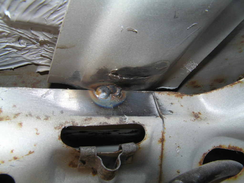

I also robbed a strengthening channel off the underside of the Audi roof, lengthened it slightly, and grafted and welded it to the Golf, for a bit of extra stiffness.
