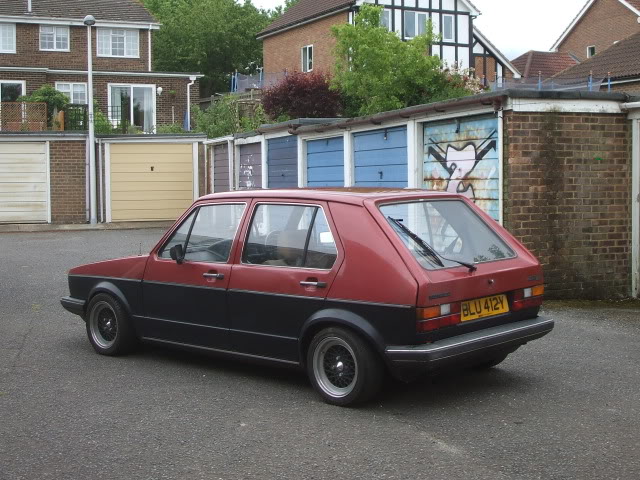

My OLD MK1

Been inspecting the paint closer up, the lower half of the vehicle on both sides, and rear is bad, it's very very faded, it's been crudely blown over and rubbed back, so I've decided the lower half is now going to be black below the trim line!
The front valance is sprayed black (although I fear I may be chopping that out and sorting it properly..) and the rear lower valance on both sides needs a new section to meet the arch, so it's a perfect resolution for trying to blow in some of the same red paint, and getting it to look ok!
This is the exact same colour as mine, and has black, but IS NOT MY GOLF! Just so you can gauge how it would look:
