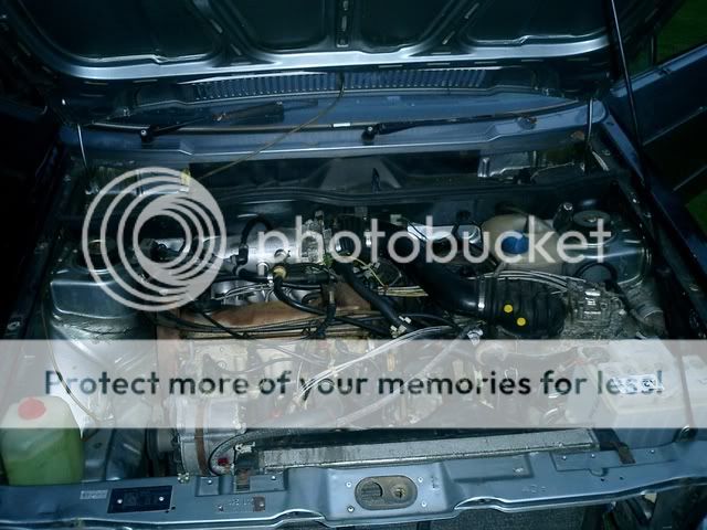

Engine bay was pretty tidy but not for long

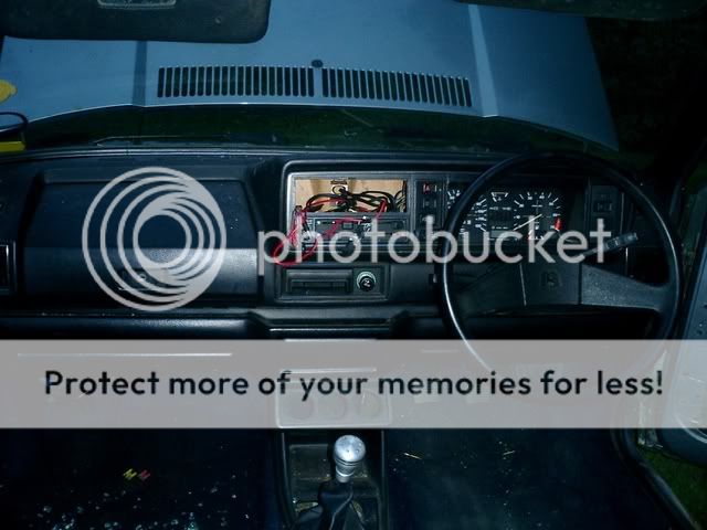

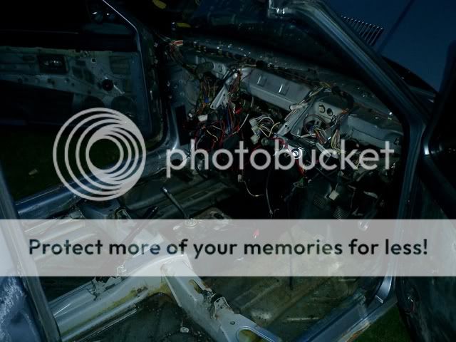

Striped all the interior out:

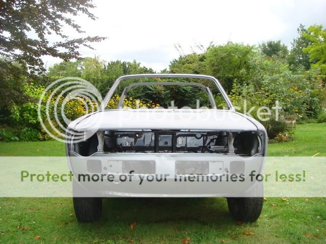

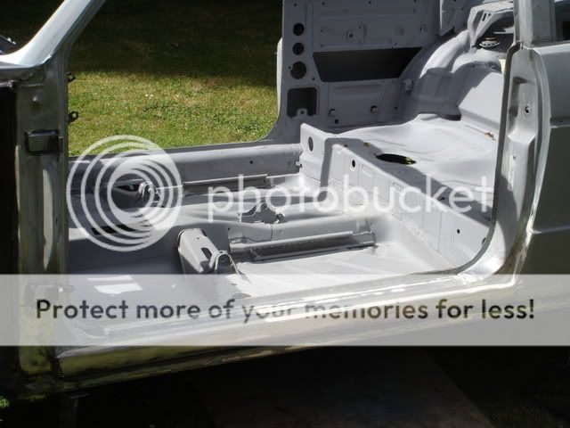

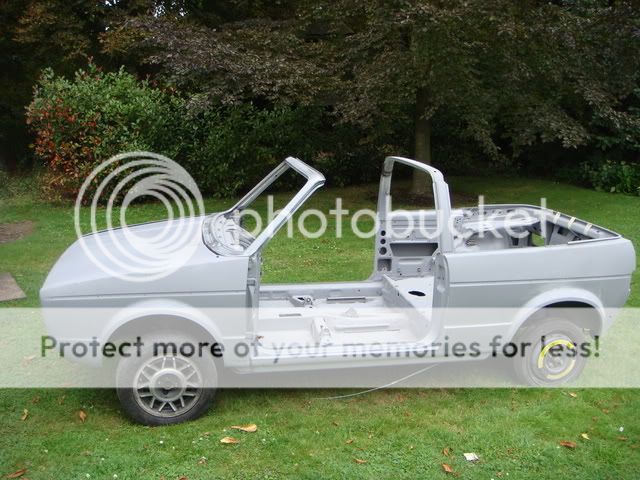

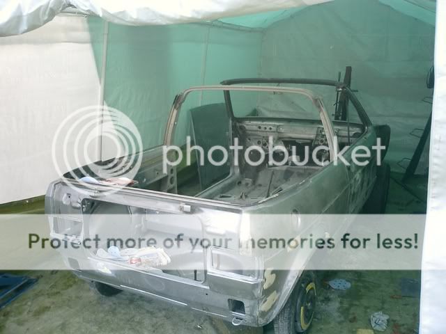

I then moved on the priming the car. I did both the inside and the outside I used a 2pack filler primer. This was probley not a good idear as the quality of the spraying wasnt great because of the environement. Most of the outside primer is going to have to come and be put back on when it is going to be sprayed.
Here is how the shell currently stands:

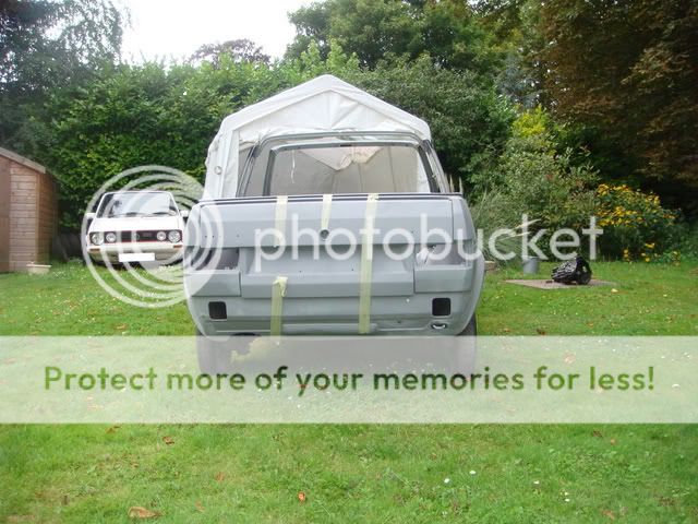

I think thats the only image of the caddy I have unfortunaly. It belonged to the guy who I brought car of. The towing was sketchy to say the least. We borrowed the trailer from a friend of his. One the wheels wouldn't hold air because it had rotted and we only got 2 straps :? Luckaly I now know someone with a proper car transported so I can get it safely to and from the painters.
