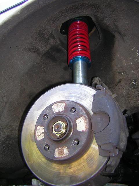

My major gripe (apart from the leaks!) was that the shocks were knackered. It wallowed and bounced round corners and the rear was lower than the front.
So to sort it out I decided that the way to go was:
New top mounts too and you can see my "official tool" for replacing VAG strut top nuts. I grip the box spanner with stilsons and away you go.
mid repair:
Goodbye wallowy old leaky rusty oily thing….
That's got to be better 8-)

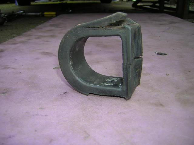

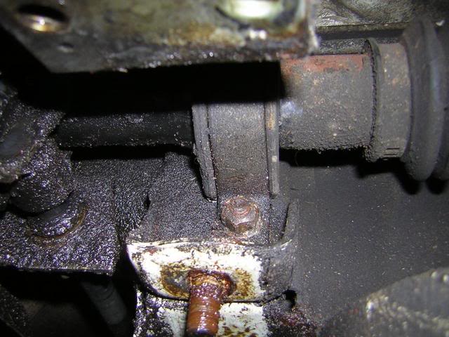

The last one's not as bad as it sounds. There was some lateral movement of the rack in it's mountings rather than wear in the rack so decided to replace the mounting bushes:
Not the most exciting pics but here goes:.
To get at the rack mountings the gearbox mount has to come off on one side and the downpipe on the other.
Then the dog can see the rabbit!
This is the one causing all the trouble:
The new one, they're only ?3 each from GSF too!
Noticed some slight flex in the bracket as well so stuck a blob of weld on to be on the safe side (bottom right). There's no evidence of cracking or that it was spot welded, I think it's meant to do it.
And the new one the other side:
Took it for a retest and it passed.

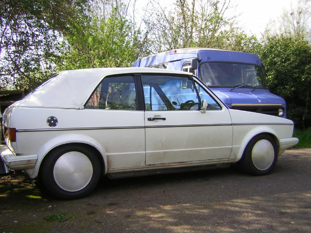

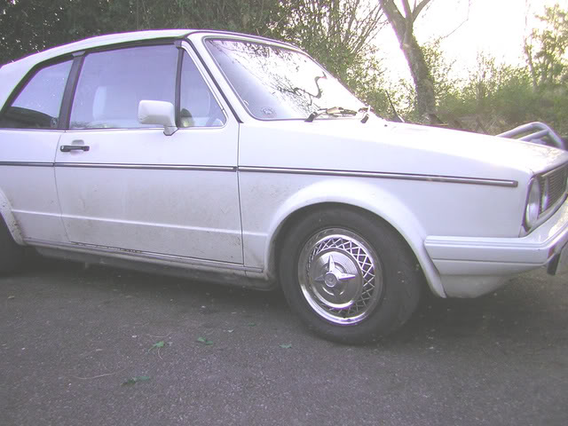

The tarantula alloys it came with were a bit scabby and whilst the tyres were legal I had a hairy moment in the rain. I went through a bit of a puddle and the car aquaplaned for a moment! Grip was restored before anything happened but it did drift toward the verge a bit.
I managed to get some 14" steels with good tyres for very little so fitted them. To dress them up I got some moondiscs from Ebay, again for very little.
Thought it looked fairly smart but the first time I took it to work I lost a disc
Couldn't find it anywhere so had to re think.

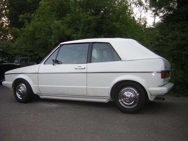

Nearly went with that but I tried some chrome trims I'd originally got to put on my Bedford CF
I decided to go with these. I think they go well with the white and changing the mirrors and door handles to chrome would fit too. Just need some centre badges.
I did originally intend to fit these at some point:
Cups do look good on Golfs but they've been done to death, I think my 60's style chrome and white is a bit different but still looks smart.

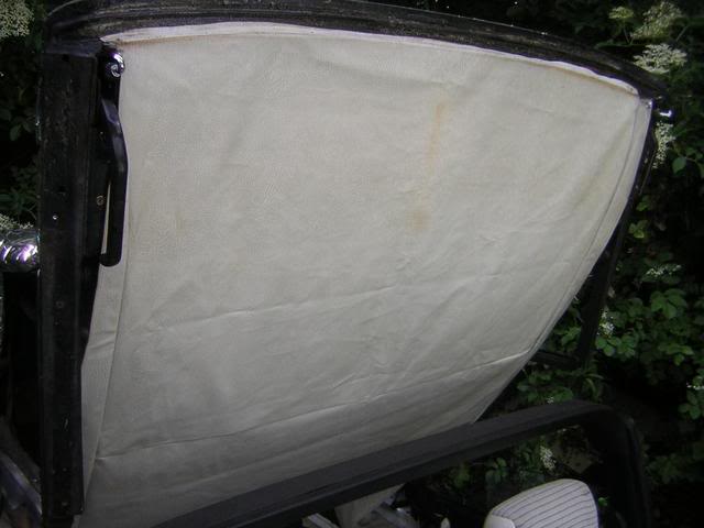

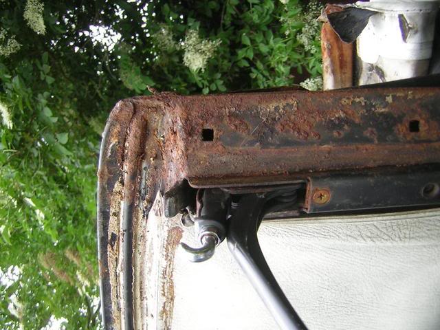

The next big job to tackle was replacing the roof. Armed with the guide I downloaded from here I set about it.
Enough blue to make a sailor's trousers - should be OK to go roofless!
Back window out, now to remove 3257598275 staples….
A bit of Hammerite needed here, I think
Changed the headlining for a ?5 Ebay one as mine was slightly mouldy and ripped.
Yuk!
Now the whole lot's gone, including the frame. Looks a bit like a boat now I think!

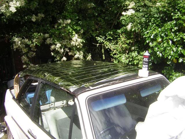

Frame fitted and horsehair pad repaired. I decided to cover it with one of those foil blanket things as the fabric covering was gone on the top. Not sure how successful it'll be but so far it works.
Slightly better headlining! Not perfect but OK.
Stopped taking photos of the rest but it went on OK. The rear cable was a fiddle and I did need to cut a U shape in the back as the whole thing seemed to be 3 inches too short when I first folded it up.

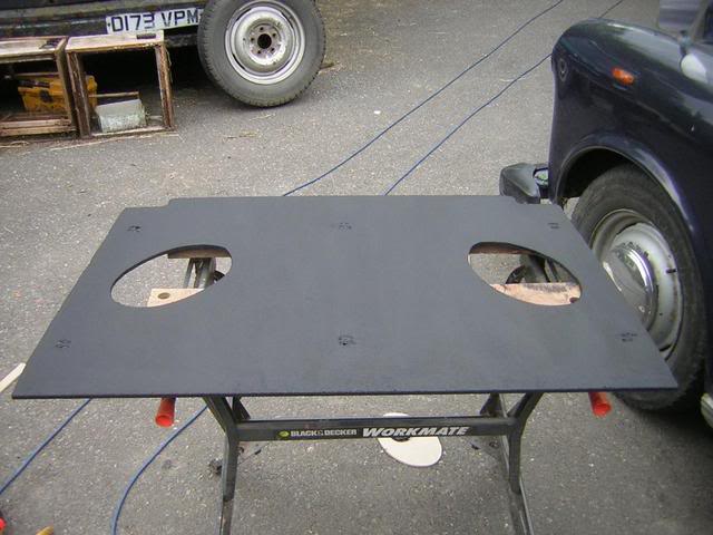

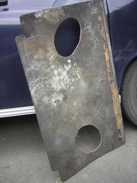

Owing to how soggy the car was when I got it, the parcel shelf was in a state.
Strip the carpet off and I'm left with
So take one sheet of MDF a Jigsaw and some blackboard paint and create
Then put the carpet back on, fit some more subtle speakers than the bright green and chrome ones it came with (another sub ?10 ebay job for some nice Boschmann ones).
