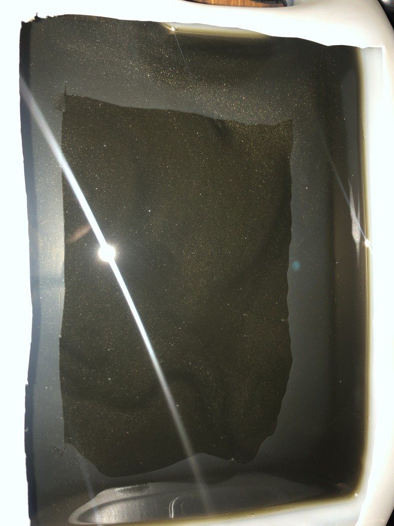

I have removed the driveshafts from the transmission, and managed to roll it inside and drain the oil.
The oil looks pretty metallic to me - it's only done 10-15km's.
It sounds to me as though the diff has had it.

Got the transmission off this afternoon, and found this: 5A67AC58-3D2B-4164-929F-4E9A9E617D9F.jpeg
I guess the diff failed, which explaines why I was able to shift between the gears without problems.
I have started to try and disassemble the transmission (with help from BrokeVW), just to see if there's anything to see in the differential. Since the casing is cracked, I will just try and locate a decent used transmission.
Thanks for all the inputs so far.
Yep Classic symptom of Self Machining Syndrome where the Rivets go and machine the case.
