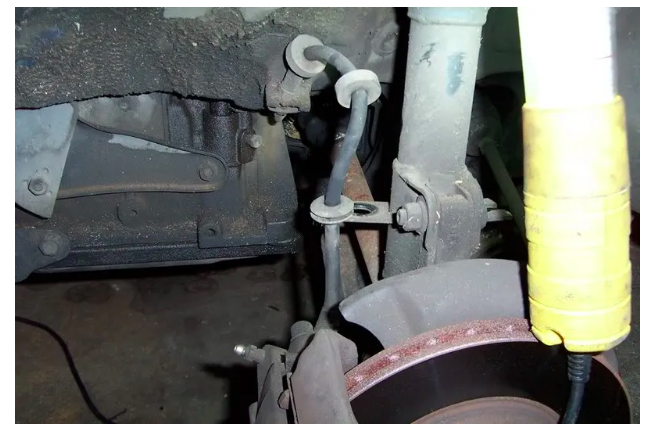

 That may work, but to install it you will have to loosen your engine mounts and jack the auto up, make sure that you have a block of wood under the pan, or that you have an engine hanger as there isn't but a inch of clearance between the pan and the control arm bolt on an auto.

 So, with that little clearance there is a good chance it will ring like a church bell after a wedding. That's why I wondered if anyone with an auto could recommend a lower strut brace.

There just isn't a whole lof of clearance on a Auto that the manual has…. and it is really really close quarters
