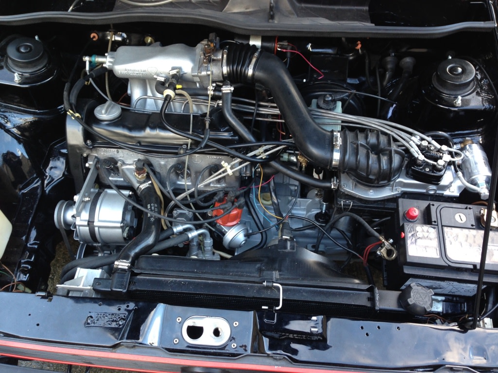

This is how it's looking so far.
Hoping to get it finished just after Christmas
The car looks amazing, do you have any more pictures? Did you do the resto yourself?
