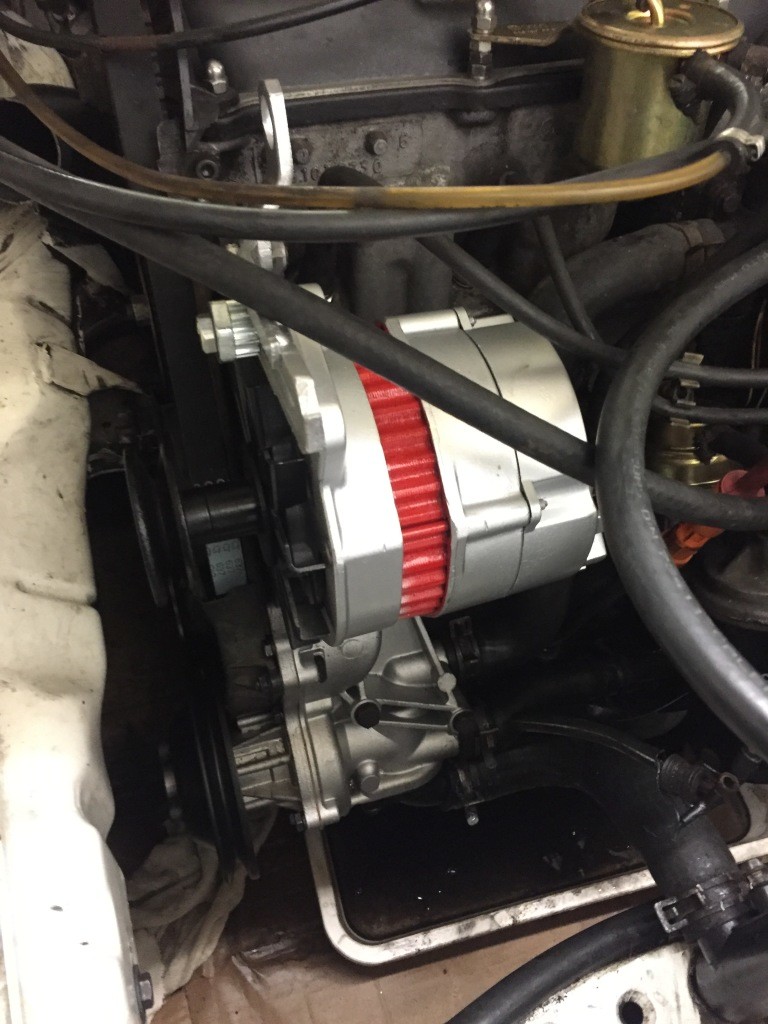

image.jpeg Done this on mine a few months ago, nothing complicated just depends on the age and years of corrosion on your bolts etc, my hoses were corroded on so took a fight to get them off, I strongly recommend changing the whole unit rather than attempting to split it from the original housing, hardly any price difference and I didn't fancy snapping all those small bolts taking it apart
thanks guys just bought a new complete unit from GSF  so will be fitting it at the weekend.

well took the old pump off 34 years old original one! good job i replaced the complete unit as the nut that holds the lower cam belt cover to the water pump snapped off . not a bad job to do if replacing the the complete unit. RECOMMEND REPLACING COMPLETE UNIT! Thanks for all the advice.
 Good shout getting the whole unit, looks a lot nicer in the bay too!
