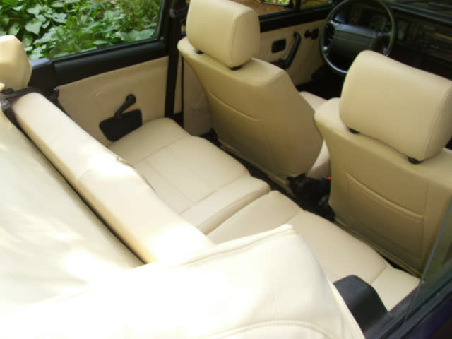

I think getting a spare shelf would defo the a good start. dont want to cut into the original cream shelf.
Any specific speakers you can recommend for the front that i can upgrade to so i keep them original??
