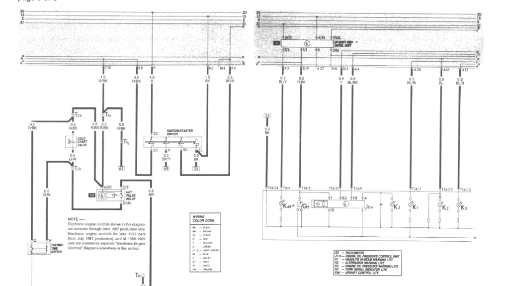

I have an earth from my rocker cover to the coil…that's fine. There is also a brown white wire attached to the rocker cover. my question is where does this brownwhite wire go to??
I hope this will sort my lack of rev counter. I got another set of clocks thinking my problem would be solved ..but no. so please help me. Thank you

Screen Shot 2019-08-16 at 8.24.53 AM.png Screen Shot 2019-08-16 at 8.25.29 AM.png Screen Shot 2019-08-16 at 8.27.26 AM.png
Brown wire on my rocker cover earths the instrument display, without it the clocks have a mind of their own when the lights switch on.
