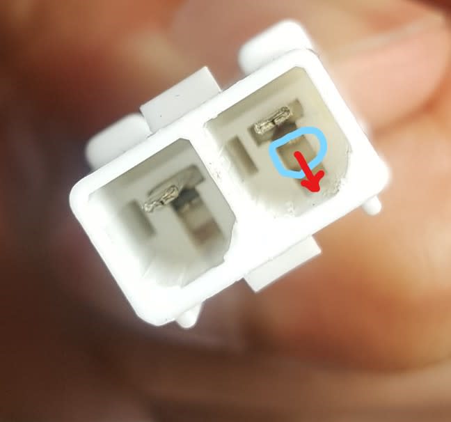

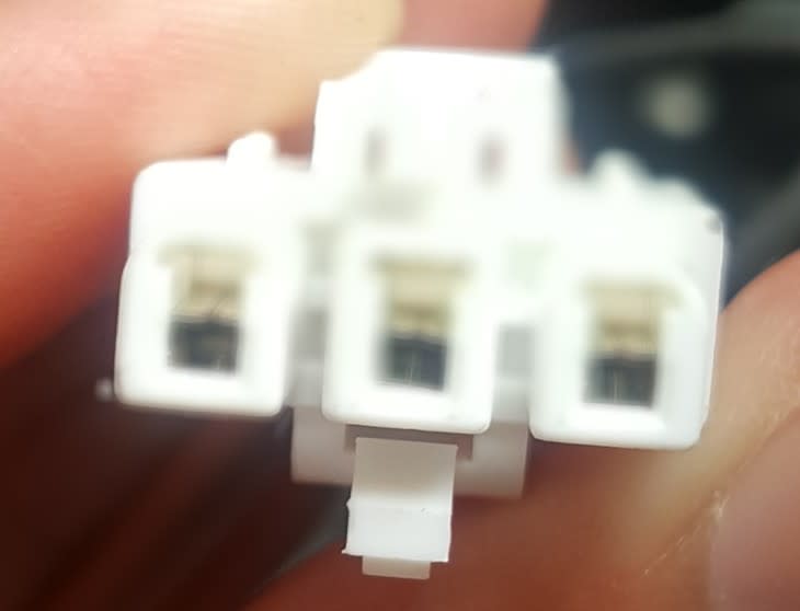

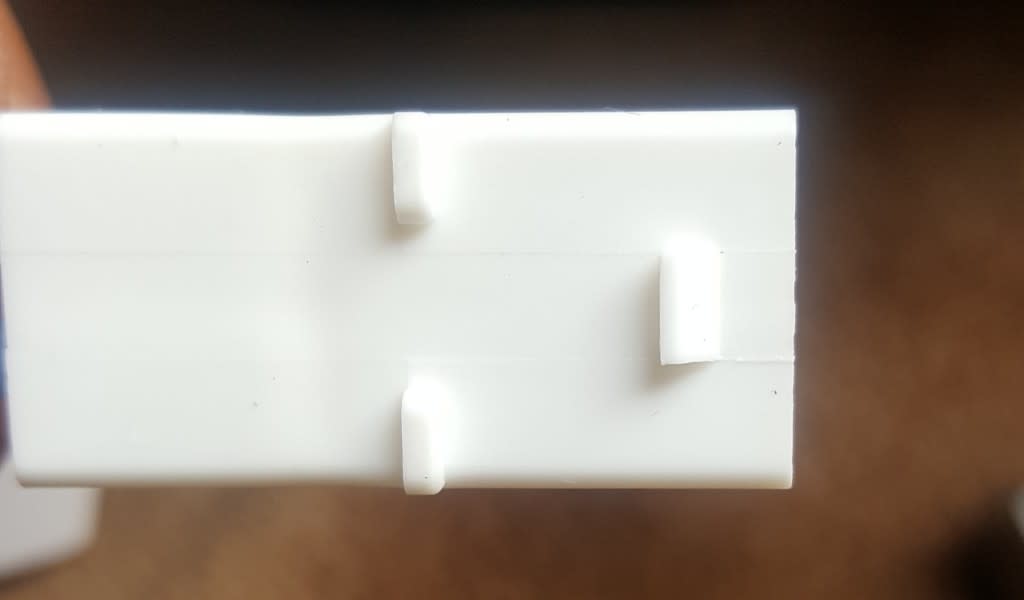

Hi,
I have a two pin and three pin connectors.
How do I remove the pins for these one? Normally there's a locking tab on the bottom. For these I'm not sure. 20190623_130311_1.jpg 20190623_130251_1.jpg connector.jpg

Thanks Brian where are the latch pins? I'm struggling to find that
I've no experience with this particular connector and it's a poor pic, but does this help? It looks like the tab circled is pulled away from the terminal to release
That pic is the latching pin that is circled, you push it up away from the direction of the arrow. Or you push it up to the main body of the pin.
