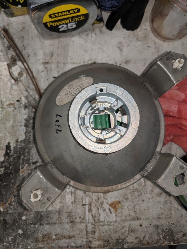

So this is my inner headlights, my thoughts that they look like sealed lights. Am I wrong?
If they are sealed is it a 5006 conversion kit I need?
And here's the outer lights which I though was "non sealed".
Can't get to the car today otherwise I would have taken a closer look.
yes
Yes remove the wires, squeeze the two metal fingers and that will allow the binder to swing away, and you can remove the bulb, yes my bulbs are missing from my Spares.
