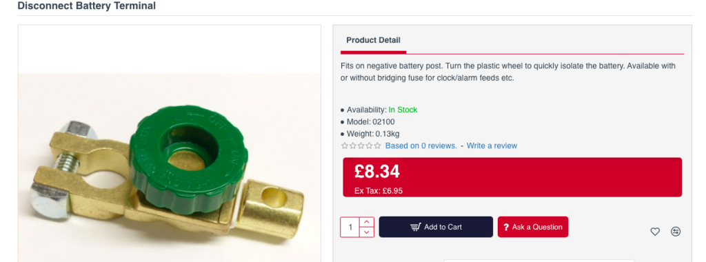

I have found that a good set of Cables from the Battery to the Frame ground, then to the engine from that point with a couple of big take offs that can be crimped to the extra things on the nutted side of the terminal to be the best upgrade you can do from the start, this as well as a new Power cable with Take offs for the myriad of things attached to the nut allows the swift removal of Power to the frame by removing one little 13mm or 10mm nut. and taking the terminal off the post.
https://www.vehiclewiringproducts.co.uk/c-46-battery-fittings-isolators/c-91-clamps-clips/p-278-battery-angle-clamp-screw-fixing
Fugly, but The screw fixings are good for seperate take-off's.
