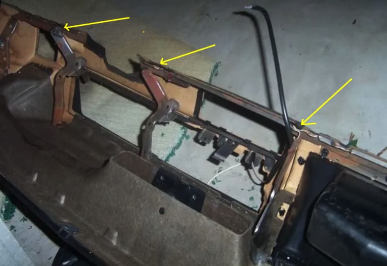

I need to remove the kneebar and lower dash, but it looks like it's held in place under the lower part of the upper dash.
So … I can't remove the upper dash because of the kneebar and I can't remove the kneebar because of the upper dash.
Any help would be most appreciated

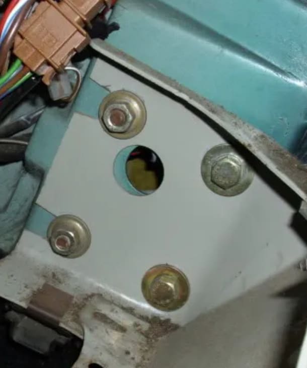

Going back you can leave the screws out, and just move the kneebar against the Dash, then tighten the nuts on the sides, and replace the bolts.
How to remove your vents safely.
Cold Hands\ Whistleing Vents? | Volkswagen Owners Club Forum
You will also need to remove your lower cluster assembly and move t off to one side to lower your Knee bar.
Once it is out of the way you can get the knee bar lowered to get to the screws.
Just wanted to confirm as i was watching a dash removal video of a USA GTI and it had a metal bar running along the where the knee bar is and it wasnt a cabriolet
