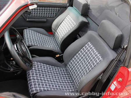

My seat style and material looks as follows:
Confusing seat cover part numbers 1992 Quartett
There was a Recaro version cover made in the pattern, but this was mainly the North American market.
Those seats are the same shape as the Sportline model available here in the UK and Europe.
The standard seats in your photo are considered sports seats.
155881770 are for the MK2 golfshape Recaro seats, 155881805 are for the mk1 'sportline' shape recaro seats, same shape as MK3 Golf Recaros.  They're subtly different.

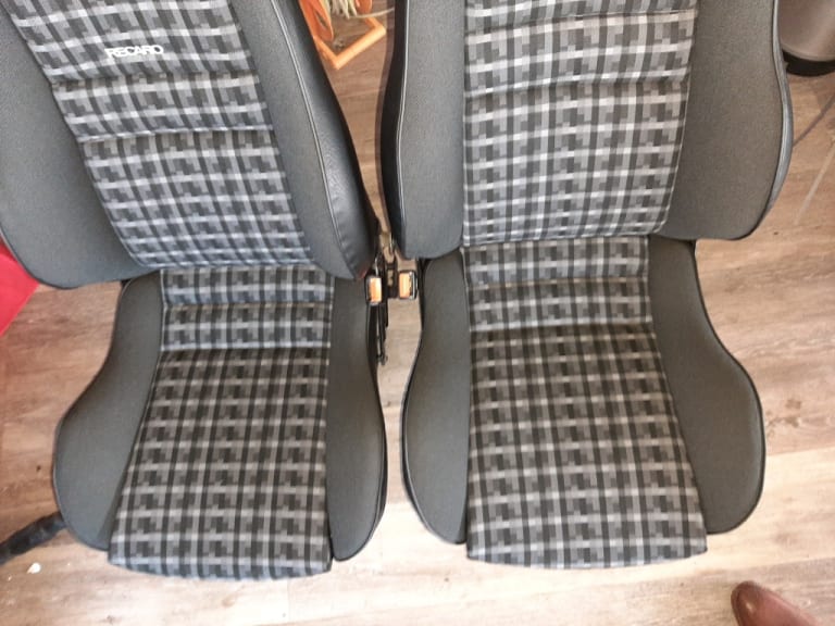

Amazing how time flies… I see it's been over two years since my last post.
I ended up getting a set of mk3 Recaros, which I had to modify slightly by narrowing/ shortening the inner leg.
I could only manage to get another set of Recaro back rest covers, which I took to a upholsterer to make bottom covers from, and got them back today. They also replaced some of the bolster foam that was tired.
Very happy with the results, can't wait to put them in the car.
I got 4 new door cards from ClassicVW.de and also manged to get, from different places, the headrest covers and a rear seat bottom cover. Now only need the rear backrest cover (mine is pretty faded). These pop up as NOS from time to time, but there were probably 20+ different seat fabrics used on the cabrios over the 13? years of production.
