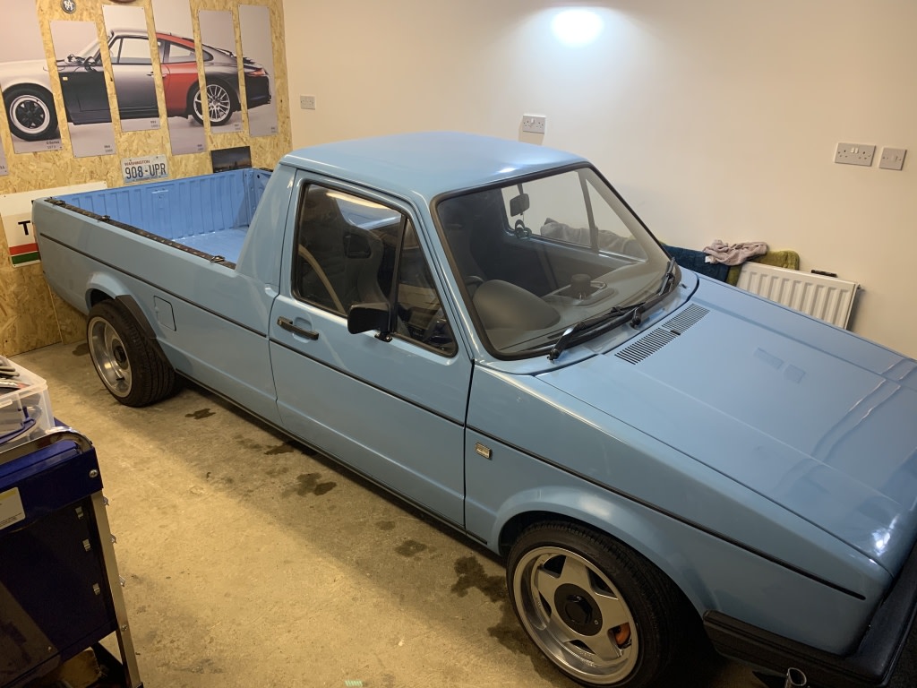

Anyone point me to advice on going back to standard dash
I have taken a caddy van/ mk1 in px and someone has fitted a polo dash complete with heater controls and has the polo running gear pd etc
If its at all doable i want to fit an original dash back in
I haven't looked under dash to see the involvement but interested to see if doable and if this conversion is common and anyone done it
Just thinking if its heater box etc will be required too
Any advice welcome or a garage / shop who would swap it back
Ta
