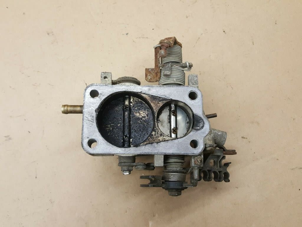

That throttle body doesn't look right. Smaller butterfly is way too small.

Does anyone have any photos of the mk2 throttle body and WUR to do this upgrade? I recently purchased a ''mk2 throttle body'' from a guy on ebay but it does not have a vacuum outlet port. I was under the impression that i'd need to run a vacuum hose from the throttle body to the WUR. Anyways, it looks like i've been sold a donkey… If anyone has pictures of a successful mk2 throttle body conversion into a mk1, could they please share? IMG_20200601_150324.jpg
looks liek a 16v one, with the 3 pin throtte switch. will still work fine, just T your vacuum somewhere else, plenty ports and pipes on the engine to choose from. for a mk1 8v move the distributor vacuum line to one of the outlets on the brake servo hose, thats how mk2 golf are as standard anyway

Cheers John, makes sense. As long as the WUR vacuum line is plumbed into the vacuum system somewhere, anywhere. (Attached picture is what I thought i'd need, a throttle body with a vacuum port right next to the larger butterfly valve). on another note, I can suck air through the vacuum side port of the WUR - i've just ordered a WUR repair kit from a place in Brisbane. Thanks again!
the 16v has a port on the side of the inlet for the WUR tapped into the ISV connection so whatever works :)
