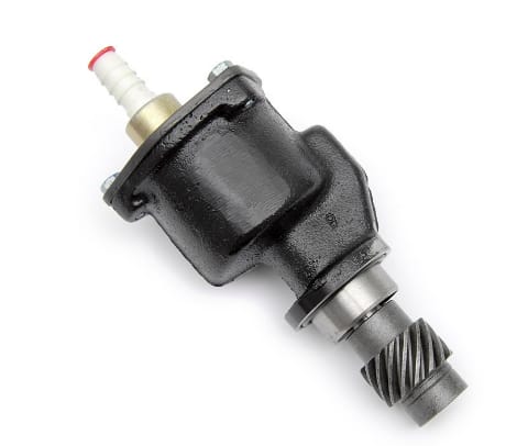

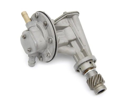

I would also suspect that your Vacuum Pump could probably use a refresh as if your braking seems to be less than it should the Vac pump probably is holed. I had to rebuild mine twice in 20 years.
There were 2 types of Vacuum pumps used. The Original one was a Diaphragm device, the latter years 82.5 and up over here switched to a Vane Type pump.
Oem diaphragm type
newer rotary style
The vane type usually doesn't ever need a rebuild, however the older style usually does.

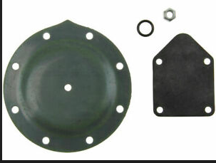

The kit looks like:
